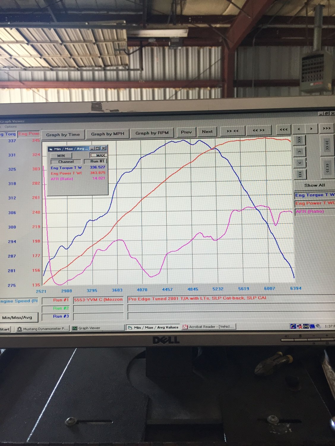

Now for the results!
Car has long tune pace setters, slp powerflo catless exhaust, ported TB and MAF, slp air lid, and it's a 01 trans am.
344 hp and 338 torque. I'm pretty happy with it! And it shifts waaaay smoother than before when I had the diablosport tune in it. Also he said I was maxing out my injectors in the high rpm range and if I were to go cam, which I may down the road to upgrade to 45lb injectors. Also the AFR is a tad happier than what it truly is because of it converting back and forth to an analog reading

Look at that long peak hp. Just look at it!
Should be shifting it around 6400 or so

Isn't it a thing of beauty ?! He told me he set the rev limiter at 6500

You have the stock cam correct?

Yes, I do

That looks more like an ls6 cam peak.

At least I think its stock, I got it from a guy who bought it at auction totaled and he rebuilt it, he didn't mention doing any internals tho. I might see if I can dig up his number and ask him, I bought it from him 5 years ago lol

Either something is off on that dyno, or its not the stock cam

You never know. It happened to a guy on here before that had a quite quick stockish ls1. When he went to put a big cam he then found out that someone put in an ls6 cam before he bought it

Mustang dyno? Just tuned rolling the drums or did he do anything on the street? Ive seen their name pop up on here more lately and being in CT, I'm curious.

Mustang dyno yes. He tuned it all on there. I wasn't counting but he (Ed) must've done probably a good 6 or 7 pulls and tweaked it each time. When he was done he took it on a ride, I'm assuming he has his computer with him but I'm really not even sure I was talking with another customer and the guy bill there
