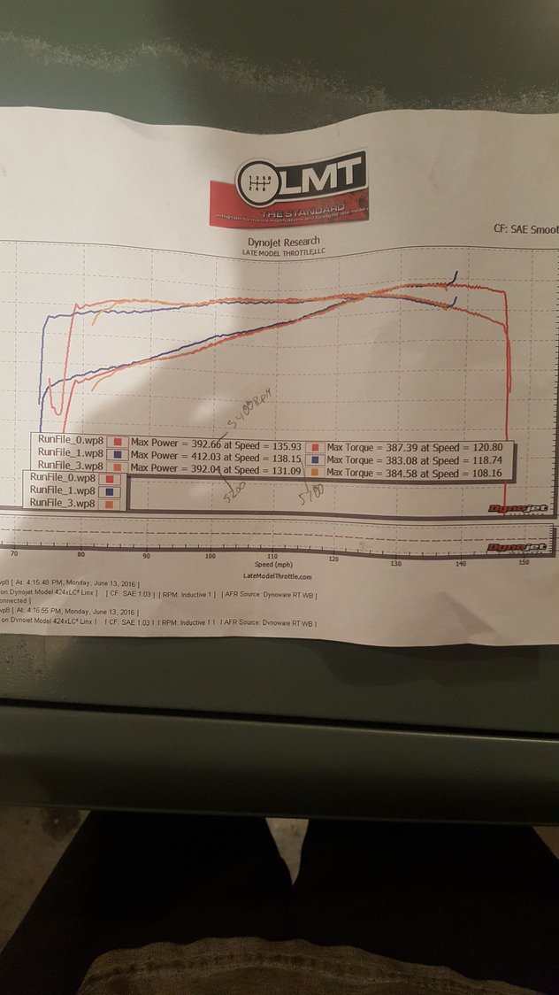

Good evening. Had my 87 buick regal with a l92 headed lq9 dynoed yesterday. Made 393 rwhp and 387 rwt. On the sec run it spiked to about 412rwhp. According to my time slip of 12.40 at 113 and a weight of about 3800 it makin about 430 to the tire. Here is the combo; lq9 l92 heads milled to 66cc with .040 gasket comp 11.2 pat g 224/232 .630 .604. Tooly .660 springs with titanium retainers. L92 intake,ported throttle body,1 7/8 long tubes 3.5 collector to 3" to rear tire exit. 4" cold air intake to area behind healights. Good numbers,bad, right on ect...

Not bad, but dyno numbers are just that...the 113 trap speed says more

Track numbers support 390rwhp on a dynojet. Numbers seem a little bit low though. Maybe its just the small cam and stock intake manifold.

I thought a lil low also. Would a ported manifold help much?plus the power peale is low like 5600rpm. For got to add the cam is a 115 +3

Did you degree in the cam? Maybe it's off/ground wrong.

Peak power at 5600 on that set up sounds almost like valve timing is ten degrees advanced. Torque should generally peak at 4800-5100 and power at 6000-6800 on a LS barring anything really unusual.
My first HC peaked at 5500. Sure enough cam was ground nine degrees advanced. I didn't degree the cam. Just installed and let her rip. Swapped cams, peak at 6500.

What's the compression ratio?
Seems to me that the cam is a bit mild......it has about 1* (or so) of overlap. It doesn't have the 'legs' to do much more than it's doing.

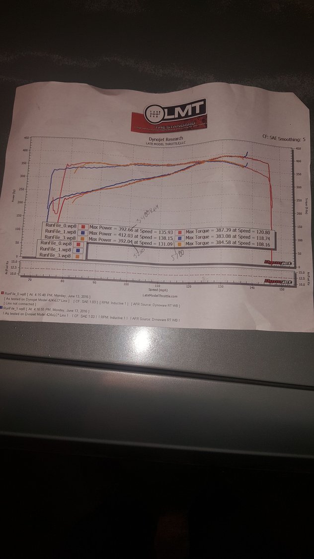

Compression ratio is 11.2 and has -2 overlap. I hope this inage loads. Its the dyno sheet.
