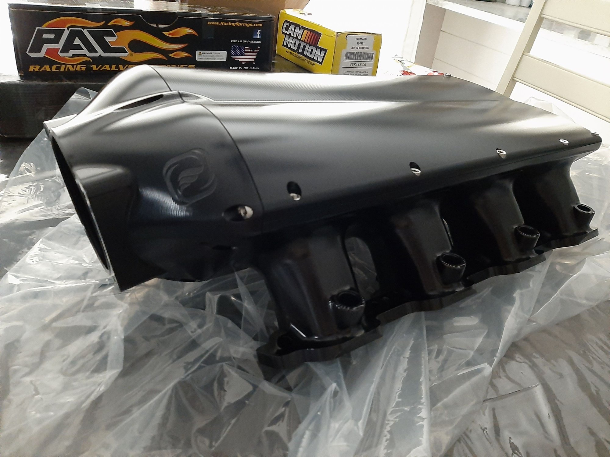

The last piece of the puzzle

It’s purty. What brand?
Frankenstein

The main reason behind buying it was I really don't want to cut hood for a hi ram. I've seen a couple and I mean acouple use this intake and it made great power up top NA. Also it looks good I like a good looking engine not perfect but good looking. I may have said it above but I would be 100% happy making 630 rwhpon this dyno through a 6l80e.

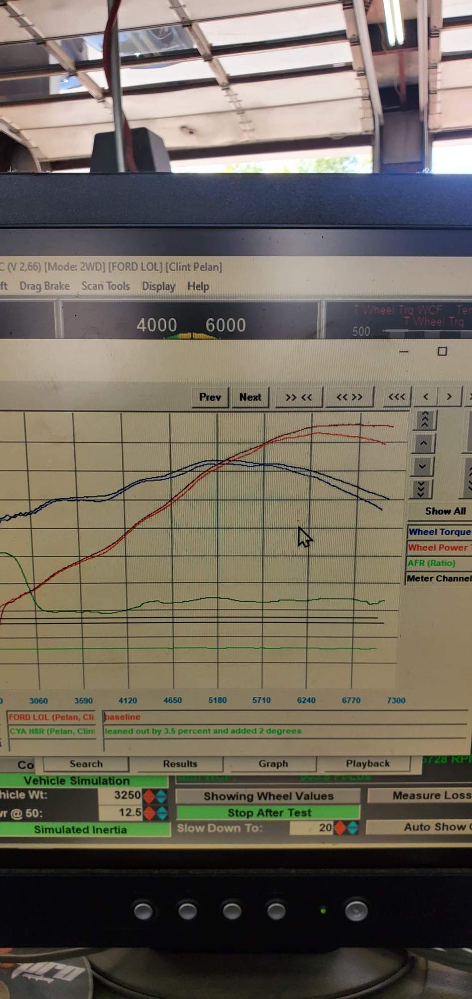

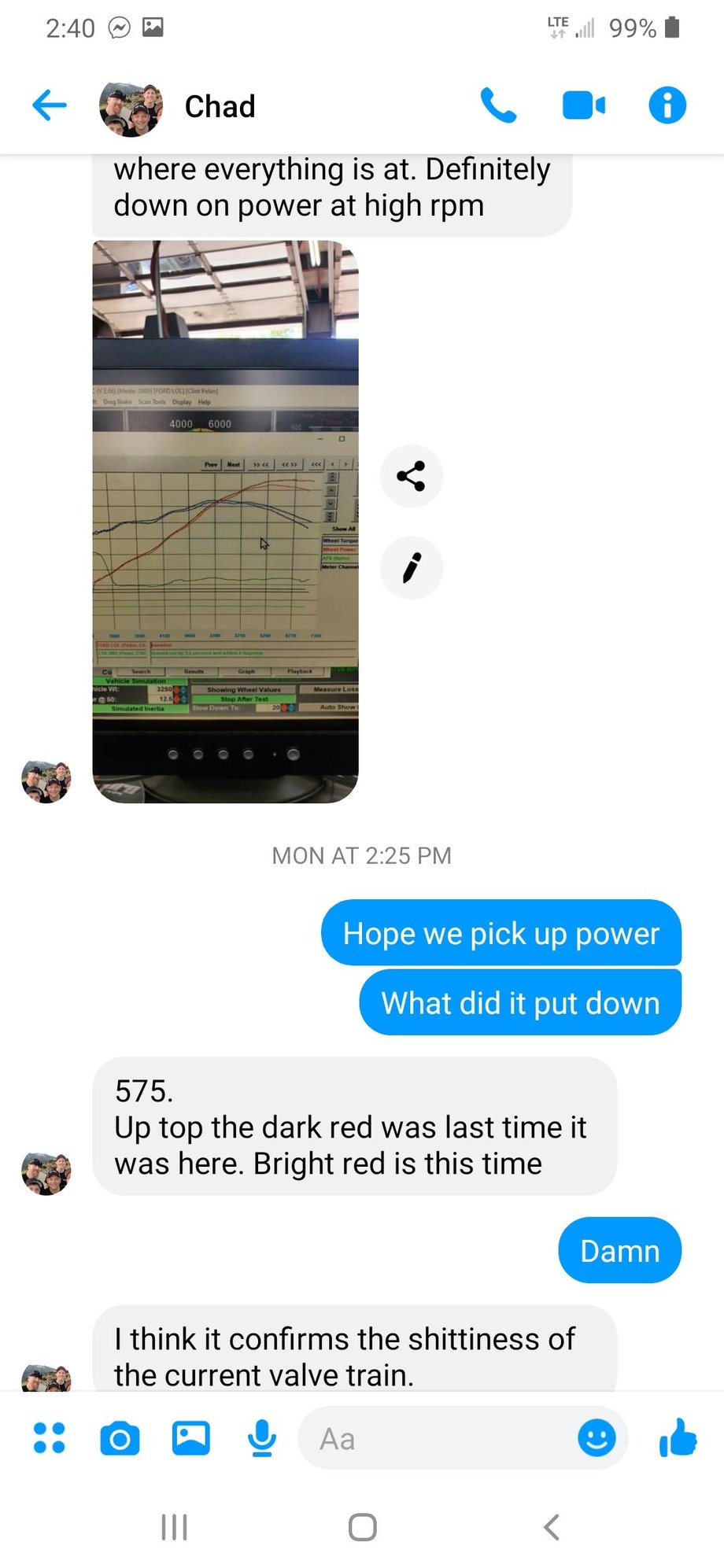

Alittle update here today. My tuner got the car on the rollers to verify where everything is at for a baseline the dark red line is from the last time I was on the dyno. That was my 593 pull the bright red line was today as you can see with no changes the car is down on power up top everything else is the same as you can see from the graph. So before I jump to conclusions I think it's pretty damn safe to say the yella terras are JUNK on the ls7. It only made 575 rwhp today which it pretty damn pitiful that's the least I ever made on the MAMOFIED setup

So this number is without you changing anything on the setup yet, just a baseline?
Correct haven't changed anything yet. He wanted to get a baseline. Pretty sad going backwards in power I was told the yella terras were junk on these ls7s I hope that is the issue here. I know of 4 confirmed cases where ppl have swapped them out on these ls7s and gained power. And had Erik from hpr say he is not a fan of them on the ls7 but he has In fact had good luck with them on other engines. I just hope its not a case were the valve seats are also hammered like Josh's on Corvette forum where that would also be adding to the issue. But he had a more aggressive cam. He changed intake manifold like 3 or 4 times switched to a high ram and the car just fell on its face after 5000 rpm. He finally sold the heads and the next guy had them inspected and the valve seats were hammered.
