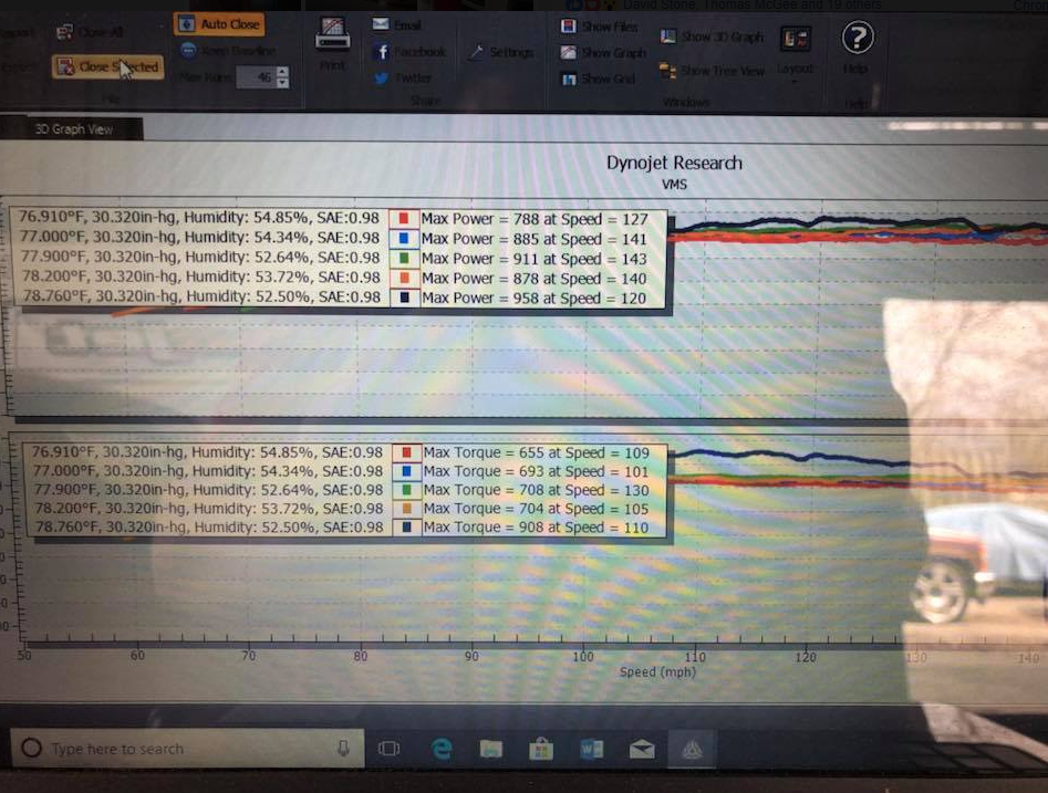

Default 950 rwhp 5.3
RCSB silverado, 5.3 with studs and ljms stage 2 cam, 210lb injectors, twin 450 walbros, e85, 4l80e, 1b circle d converter, 243 heads, stock truck intake, 76mm bullseye turbo 24 psi, 958rwhp unlocked
truck went a 9.9 @ 139

Nice numbers! How much fuel did you have left with those pumps?

Stock bottom end besides studs? Either way great results!

Duty cycle was at 64% on 210s. And yea stock unopened bottom end, stock everything, just head studs, cam, and springs.
