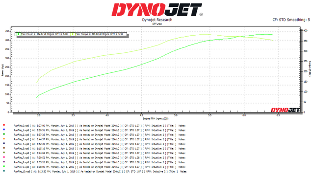

46k orginal mile ls1
-Patriot stage 2 cnc ported 5.3 heads dual .650 springs
-TSP 231/237 598/595 112lsa
-Fast 92mm intake ported by Mamo
-Nick Williams 92mm TB
-ASP underdrive balancer
-LS6 oil pump
-LS7 lifters
-JWIS double roller timing chain
-Siemens deka 60lb injectors w/ Racetronix 255 fp
-TR-6 plugs
-TSP 1 7/8th longtubes w/ 3" open ypipe
-Hawks lid with oem paper filter , no ram air setup
4l60e
-Yank ss4000
8.8
-3.73 gears
Tuned on a 90° + day on 93 and speed density
432HP 381TQ
