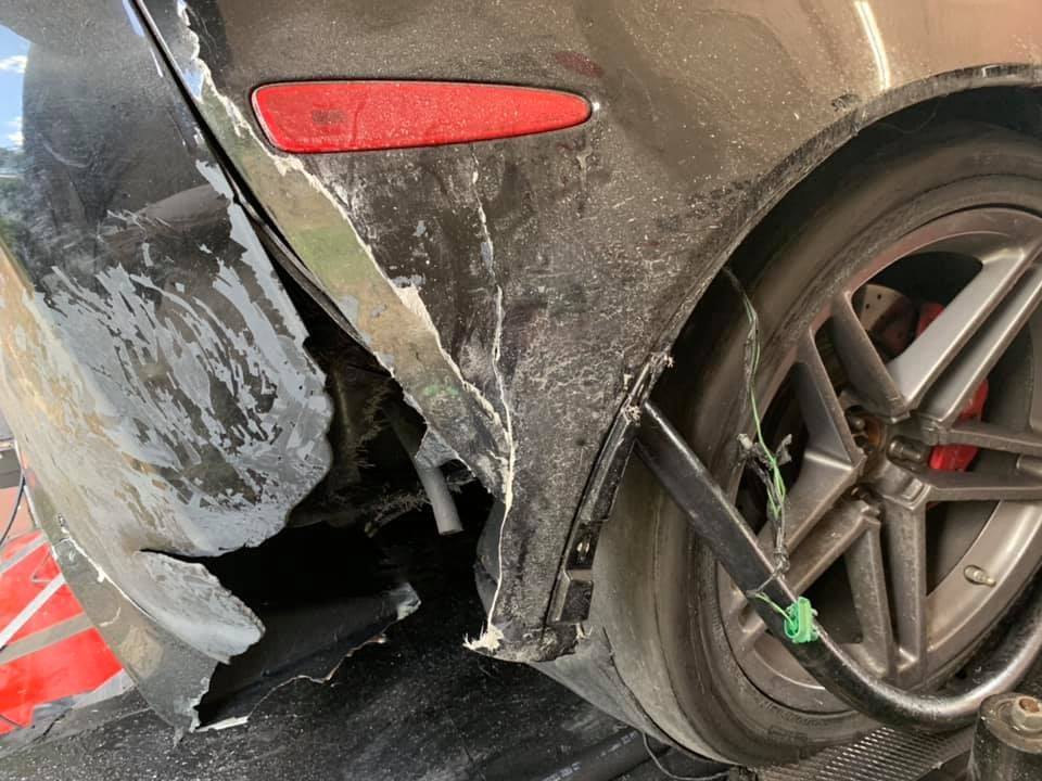

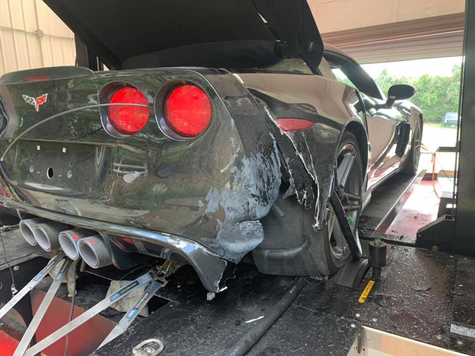

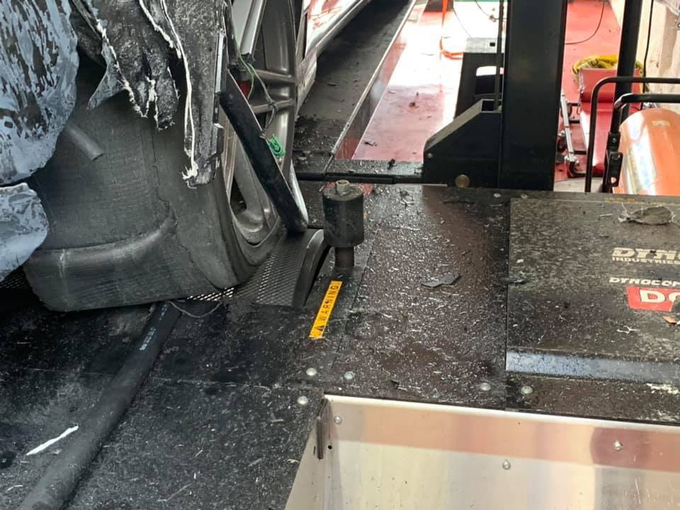

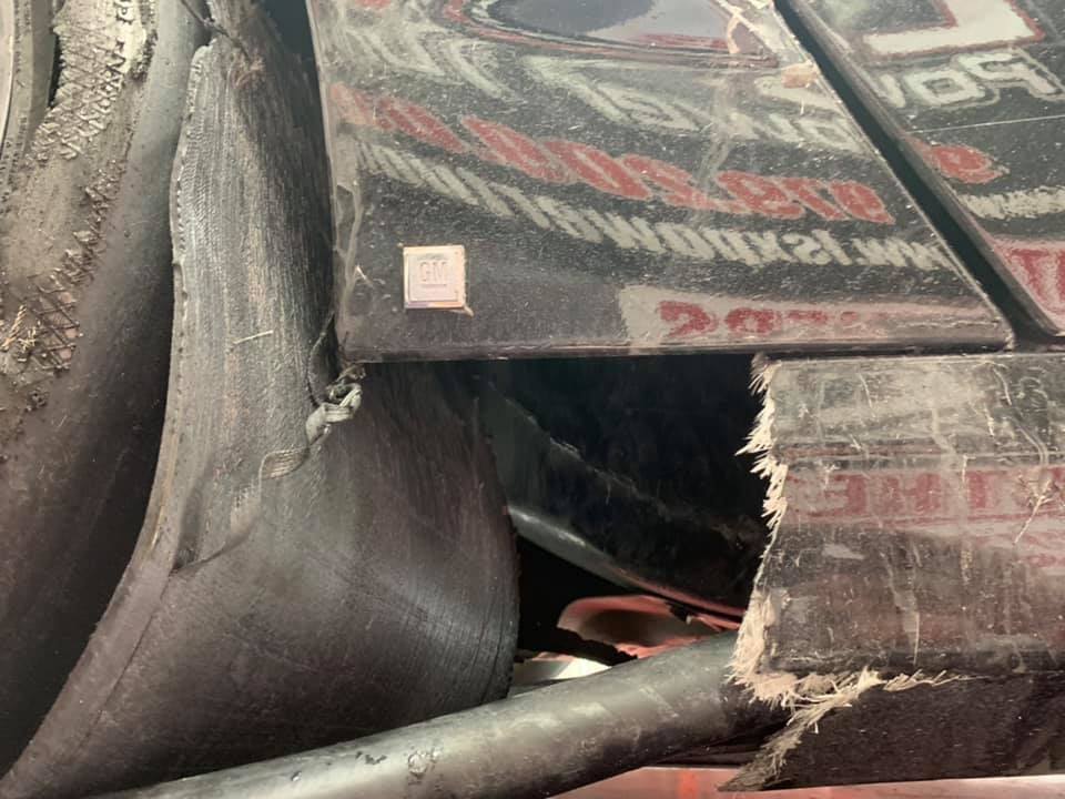

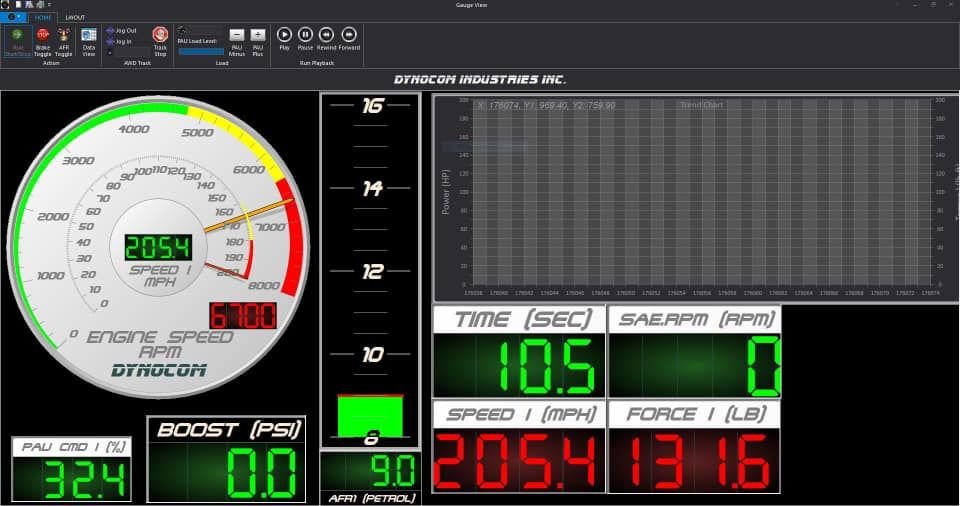

We made some changes to one of the Z06’s we run at the Texas Mile when we had a tire failure on the dyno at 200mph. We weren’t doing full pulls so we didn’t have the dyno video camera on. This is why we make everyone clear out the dyno room when we dyno high Hp or higher mph vehicles. The tire blew out on the second run of the day after the run was over and the car was slowing down already. It threw parts 20+ft out the shop in both directions. When the tire blew the car did not move any on the dyno. Taking the time to strap a car correctly pays off especially in an emergency.
We race in 3 weeks if we can get the parts to fix it. It needs passenger rear fender, rocker panel, rear bumper, passenger wheel well, some re-wiring and intercooler lines.
