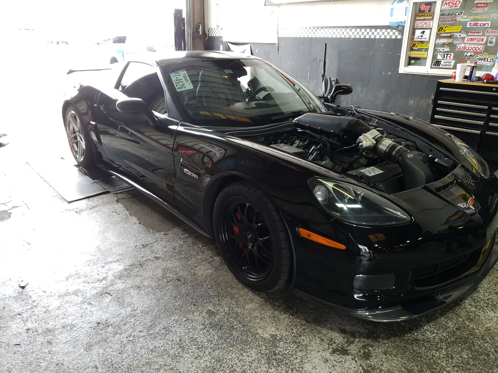

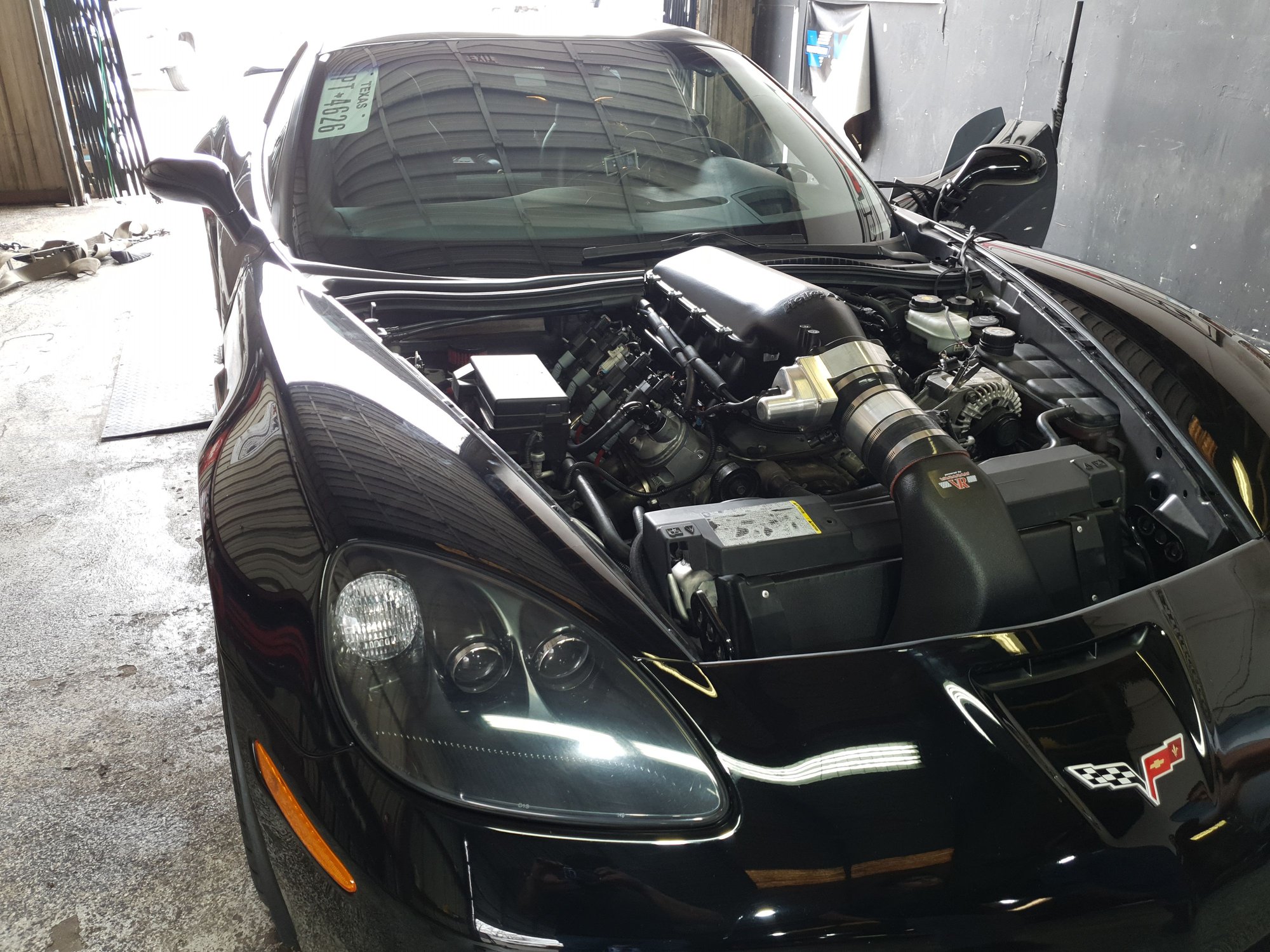

Forged ls7
Ls7 ported greg good heads
Holley hi ram
mcleod rxt
e85
Id1050x
12:1 cr iirc
25x/26x camshaft
2" headers
nw 102
Vr intake
Tuned on hptuners
Made 660 wheel revving to 7700
super nice combo, drivability is nice too.

Seems to me you see these high 600s ls7 street builds they have several things in common. Good heads, 25x/26x cam, 2-in headers, 12.x compression.

Solid! Got a hood to cover that bulbous unit?
I'd roll around without one, just show that thing off!
Agreed...but usually with a plastic manifold. I don’t buy into the high ram hype. Throw a ported MSD on it, make the same power...or more...and the hood goes back on. Win-win.
If everyone had the same mods it would be a pretty boring place. VFN hood clears most all the intakes and looks better than stock.
