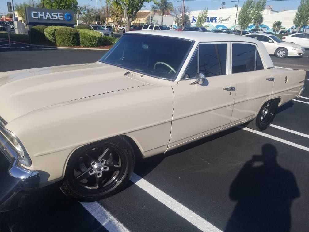

It's in a 1966 Nova 4 door sedan. Correct duel 3-inch exhaust. The old LS6 setup was with a 4L60. The old tq numbers on the LS6 were 387 if I recall. If it was a broken valve spring or dead lifter wouldn't I notice it in the way it drives? The car drives nice no issues other than the power.
Cream Puff
