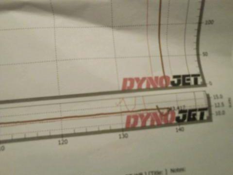

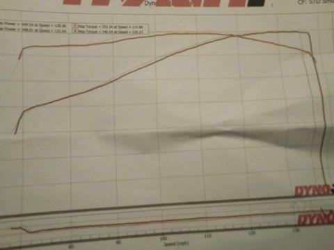

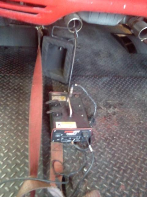

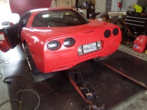

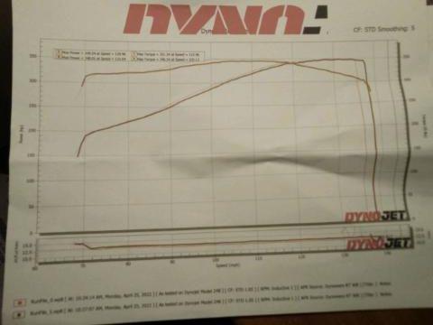

Well i went to a different shop to confirm my afr was correct so i wouldnt have to spend 220$ for a wideband gauge as it was 75$ for two pulls with wideband o2 on the dynojet 248. These numbers look to be correct compared to the dynocom 5000 dyno numbers.

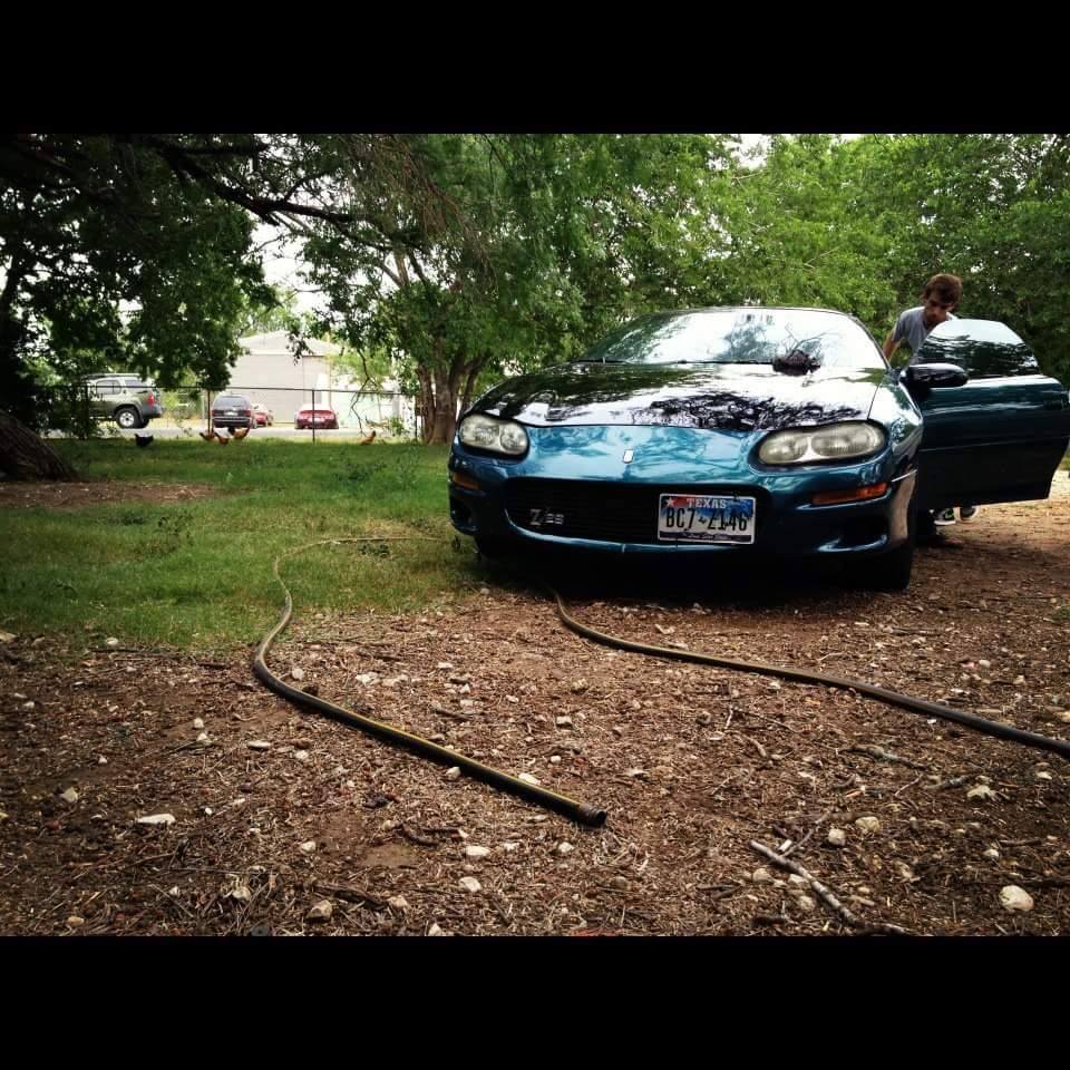

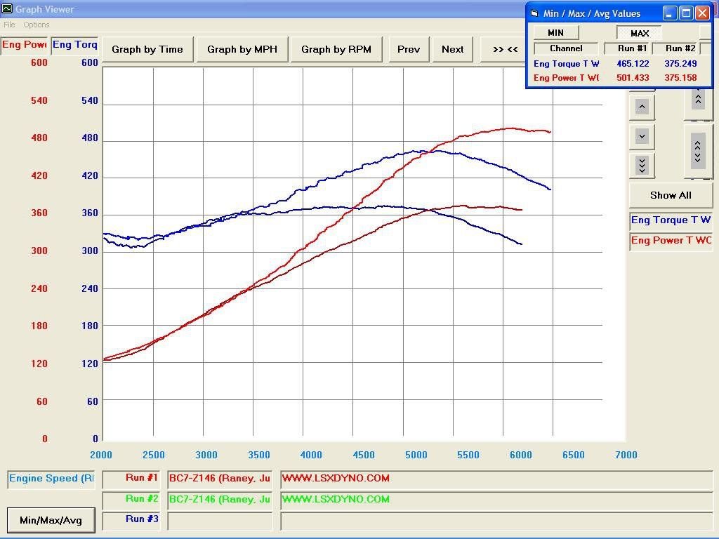

It made 349whp/351wtq 12.5afr-13 tops 99 corvette stock auto 3.15 gears with elgin 1839 220/224 .575 cam, tsp headers, stock 2.5" exhaust, better mufflers and volant oval filter. I think an ud pulley, ls6 intake and 243 heads would get it close to 400whp maybe. My 6 speed 98 z28 with 3.42 similar but smaller cam hooker headers free flowing exhaust and ud pulley stock 98 intake had made 375/375 on mustang dyno. It was worth the 75$ to confirm afr from a second shop and better dyno graph not sure what other upgrades there are if a varam power duct adds anything someone told me they lost 2-3hp. Maybe a 3.42 gear change, ud pulley, ls6 intake, 243 heads is only thing i can think of.

look right to me for an auto ls1 with a small cam

Looks about right to me.
Friend w/98 WS6 M6, LS1 intake, T1 cam 221/221, mid length headers made ~361 whp
I don't think you'll hit 400 whp with a stock LS6 intake & stock 243 heads. More likely ~380 whp with that small cam. Definitely think with a good set of ported 243 heads you'll break 400+ whp with an LS6 intake.

My 98 z28 6 speed 3.42s with a slightly bit smaller cam around same .580 lift i was told and hooker headers 25% ud pulley made 375/375. Im trying to get somewhere around there i think the 243s would get it around there or 365 with ud pulley ls6 intake. They dont have the air bridge if it is restrictive and have a groove to port the throttle body. I a couple tuners told me that mustang dynos and dynojets can be setup to read the same numbers. This car did 114-116mph 1/4 miles 6600 rpm rev limiter and close to shifts i didnt have good tires but the speed is there for 1/4 mile and 375whp similar to a z06 stock.

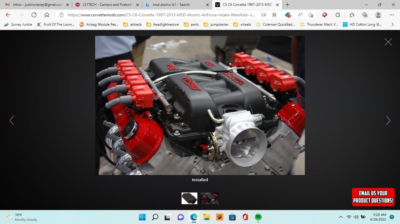

Is the horsepower gain from a fast 92-102 intake from idol 700rpm-6k or does the stock ls1 intake make more power under a certain rpm range? How about the msd atomic airforce ls1 cathedral port intake? Says uses stock fuel rails and throttle bodies. I was just going off asp claims of 13hp on a stock ls1 for the ud pulley if it does add 10whp it may be worth it.

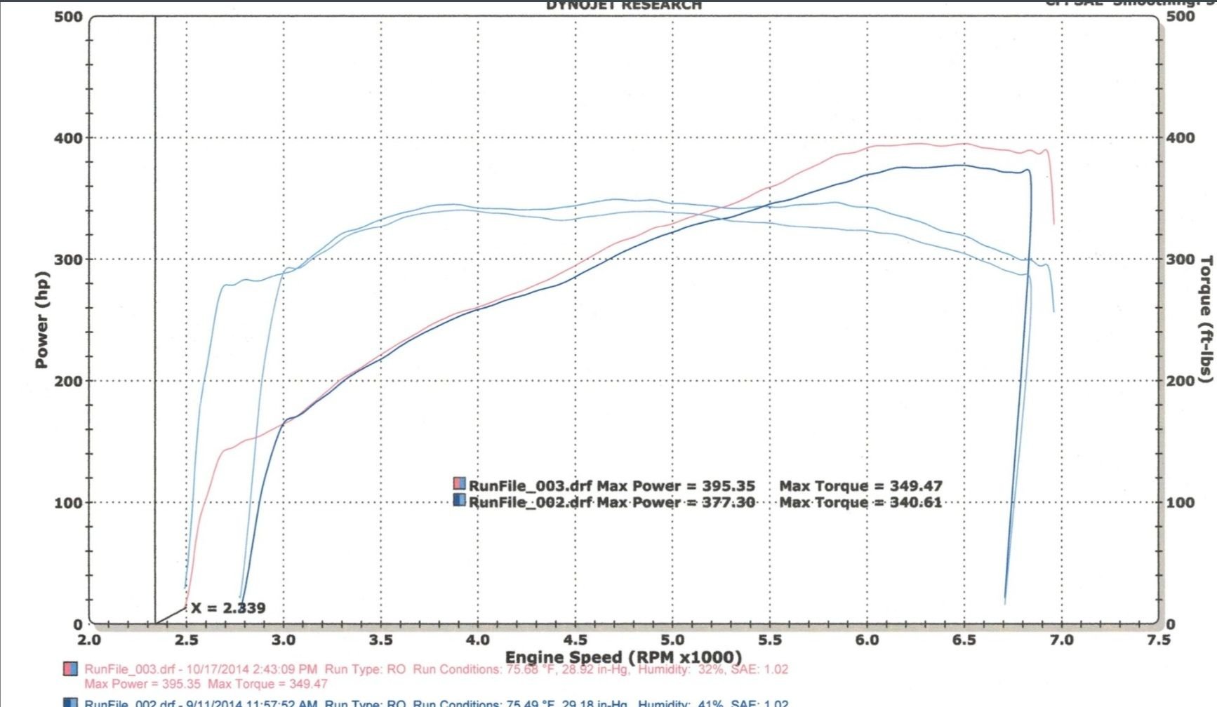

The small 220/224 cam currently in your LS1 is an excellent match for a Fast but terrible match for a MSD. MSD will shine above ~6,500+ rpm. If you're going over 7,000 rpm frequently the MSD a good choice provided the engine has a suitable cam & a good set of ported cylinder heads. Under 6,500 rpm the Fast 92/102 will have the advantages.
fast-92-92-vs-stock-tb-ls1-intake-gains-m6
Graph is from post #1 in thread by Scotty2000ss
Basically the old LS1 intake is inferior everywhere vs a Fast 92 powerwise. Maybe at 800 rpm the LS1 makes 1/2 hp more or something etc. The LS1 intake is very restrictive so much so back in the day ~2000 that reverse split cams like 230/224 were popular to try to get some more air into the motor. Single patterns like 228/228 etc were popular as well.

So the fast 92 picked up 9ftlbs torque and 14whp? I think a gear swap or 799/243 head change would be the way to go but for some people bolt ons are easier or i just havent got that far yet.
It appears this car is auto and is tuned for 6000 rpm shifts. I knew someone else with an auto, stahl bigger cam and a different tuner left the stock auto shift points. 3.42-3.90 gear would help. Does an ls6 intake add 10hp from idle-6k or is it it the high rpm range. This car being auto and mostly street driven i find it often at lower rpms vs a manual 6 speed which you have gear selection.
