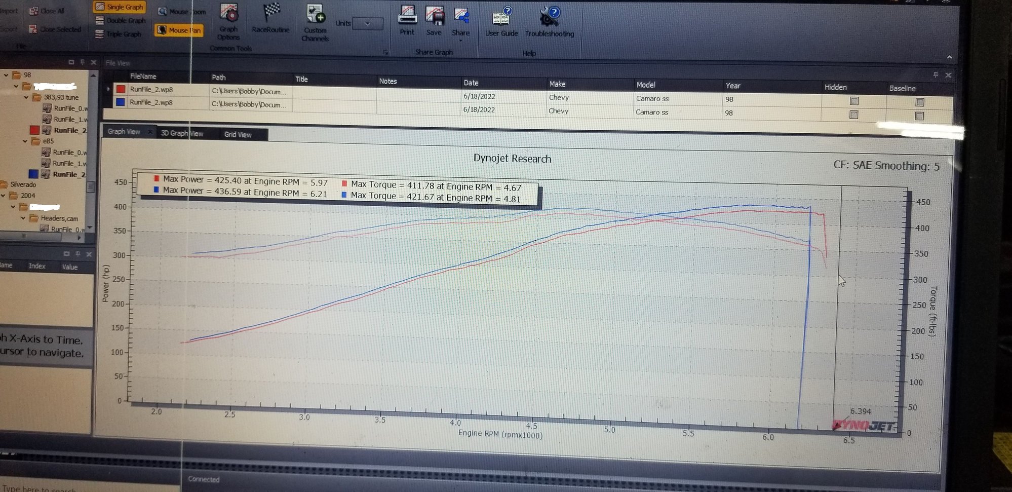

First pulls were on 93 after I added an electric water pump and underdrive pulleys. I gained 13hp from that. I was hoping for 20 but I'll take 13. We then emptied the tank and put in E85. The E tested out to 82% Ethanol. Picked up another 11hp from the E85. I was pleased. Its an extra 11hp and it cost $1.61 less where I live. I'm pleased with that.
My car is a 383 with only 9.5:1 compression. Orginally built it for blower but I think I can get it in the 6"s in the 1/8 just on motor. That will be enough for me with this car. Car is auto with a 9' rear.

More than I expected from a low compression LS engine. But its a solid 10+ tq gain from 2400 until I let off. I added one degree of timing, I think it was 27 total up top and the AFR was right at 13 (gas scale) both ways.

That's a great gain just by switching to E85 !

I really didn't know if you would gain from E85 with the lower compression but I think it gained more on average than mine did. Should have gained enough from all the mods to see some gains at the track.

E85 typically makes a little less peak power, like 5-10 hp less if the engine is not spark limited on gasoline. The extra fuel displaces oxygen in the combustion chamber.
E85 does tend to make a little more down low and midrange torque, and great throttle response.
I like E85 for NA engines because it smells a lot better, zero concerns about detonation in any circumstance (even fully heat soaked 150* IAT's), and the charge cooling effect of the ethanol reducing IAT's as well as pulling more heat out of the cooling system. Running lower IAT and coolant temp means you'll get all the timing more of the time. Nothing worse than heat soaking and getting into that -8* range of the timing modifier table...except I guess pinging would be worse.
On higher compression engines it can of course take advantage of the 105 octane and make 20-30hp more.
Surprised to see this engine pickup through the powerband. Kind of curious if the pump gas tune was soft. I bet you could run this engine on 87 octane without knock.

Never in the 20 years that I've been tuning cars professionally have I ever seen E85 make less power anywhere no matter what the compression ratio was, what the timing was, etc.

Interesting. My ls6 did it in my c5z. 400whp on 91, 395whp on e85 but more torque down low. Engine Masters in their dyno test had the same result - more torque and a little less peak. I think they ran methanol at the end but I don't remember.

The tune was dialed in on 93 before we switched to E85.

Zzracer is right. Did 3 pulls on 93 before it was switched over.

And you ain't gonna feel 11 hp on the buttometer
