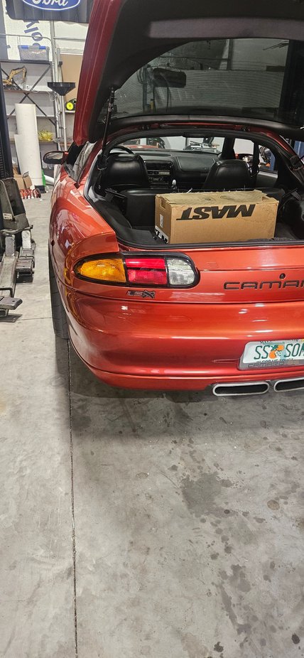

Well took the time to do some exhaust testing. Picked up 14 wheel. So a 4 inch y pipe and cutout are getting built.
Also after month's of waiting on the BTR canted valve head's with no eta as of last week. I put in some calls and made the choice to buy the 295 MAST cathedral heads. 6 week's build time and we shall see what is to be gained. Ls7 rockers should bring lift to .672 intake and .655 exhaust. Went 62cc chambers and .040 head gasket.

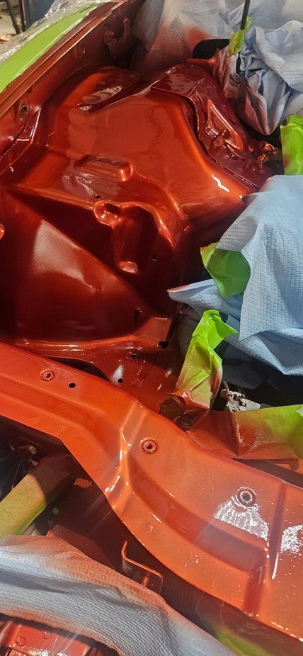

Did get the engine bay painted though.lol
