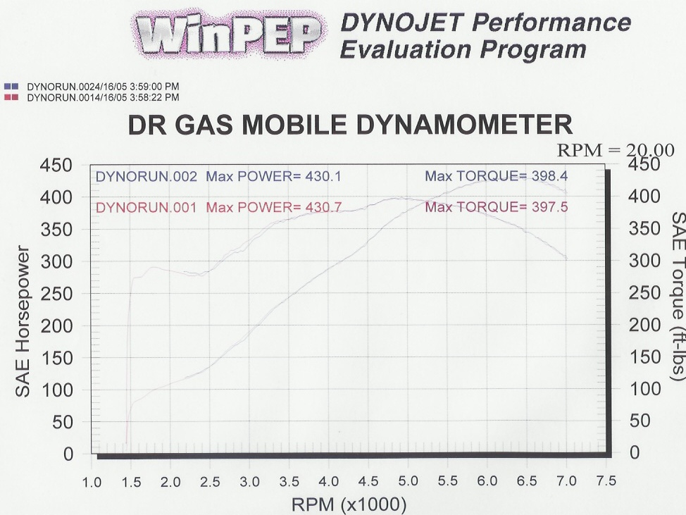

Just dynoed today. The car put down 430.7 rwhp @ 6400 rpm, 397.5 torque @ 4900 rpm running through a Moser 9" with 4.11's. Ambient temperature 71*F. I'm pleased! This is on home-ported heads with stock valves, QTP 1.75" headers dumping into a 3" Y with 4" output, ending just before the axle. Still running the stock spark advance and compression ratio.
Full specs: 235/240 .602/.598 112+2

Thanks. Idle is reliable at 1000 rpm, but rough from there up to 2000 rpm. It surges and bucks quite a bit in the same range. 2000 to 3000 feels stock, above 3000 you feel it kick in, and it's an animal from 4000 to my 7000 rpm redline. I love the way it drives, but at first the bucking was iritating until I got used to it and adjusted my driving style. It never dies at a stop sign, but I did a little of my own *creative* tunning. AFR at WOT ranges from 12.7 to 12.9.

Great #'s Cal! That cam seems to be making better tq (across the curve and peak) than the other advertised (popular) TSP grinds.

Looks like I even got a little more than you did. Too bad you didn't have my dyno graph to show them when you were selling the cams. I think this cam will do 460 rwhp with the right heads, since they get that with the Mini Stick cam, which is essentially the same thing.

look at that torque curve!!!!
