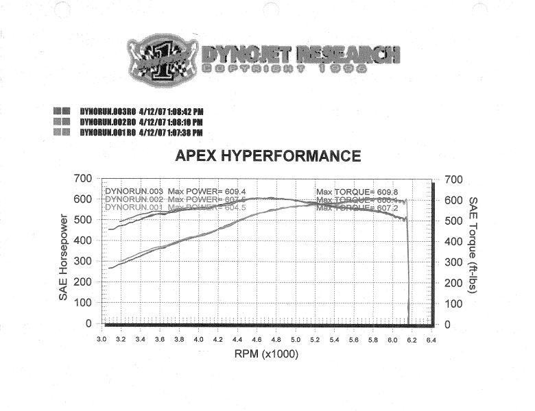

A local Viper put down 609rwhp/609rwtq NA on 91 pump gas but it's more than just a heads and cam package. Forged bottom end, bored, heads, cam, etc etc. Pretty impressive though.
