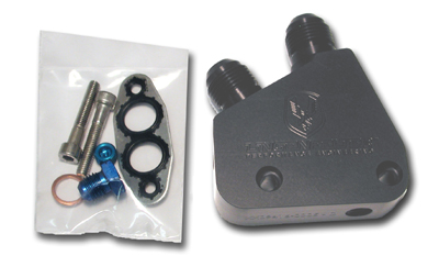

New plan might work good .
I just recently bought this
I bought it with palns later to run an oil cooler for now I was just going to cap it untill I get the cooler .Now I am thinking I can just cap the out port and run the return to that ,then just t in when I do the cooler . Anyone see any problems that I am not I think that would work nicey
Old Nov 8, 2008 | 04:40 PM
GT67METHV's Avatar
Joined: Oct 2008
Posts: 393
a return is a return...
i think your golden as long as you maintain
pressure.
try it, it wont hurt.
but a bung in the pan at an even plain (as even/level as you can get)
with the turbo is best.
