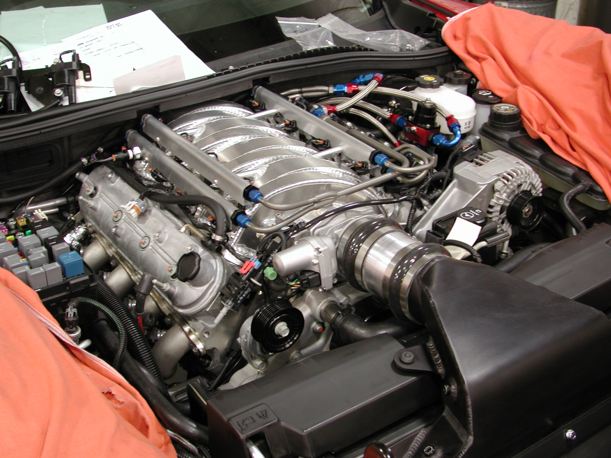

Hogan has made a few custom 16 injector intakes for LPE. He can build one for a LS7.
http://www.lingenfelter.com/images/C6ZO6EL03.jpg
Thats badass!!
that is ******* bad!!!!!!!!!!!!!!!!!!!!!!!!!!!!!!!!!
