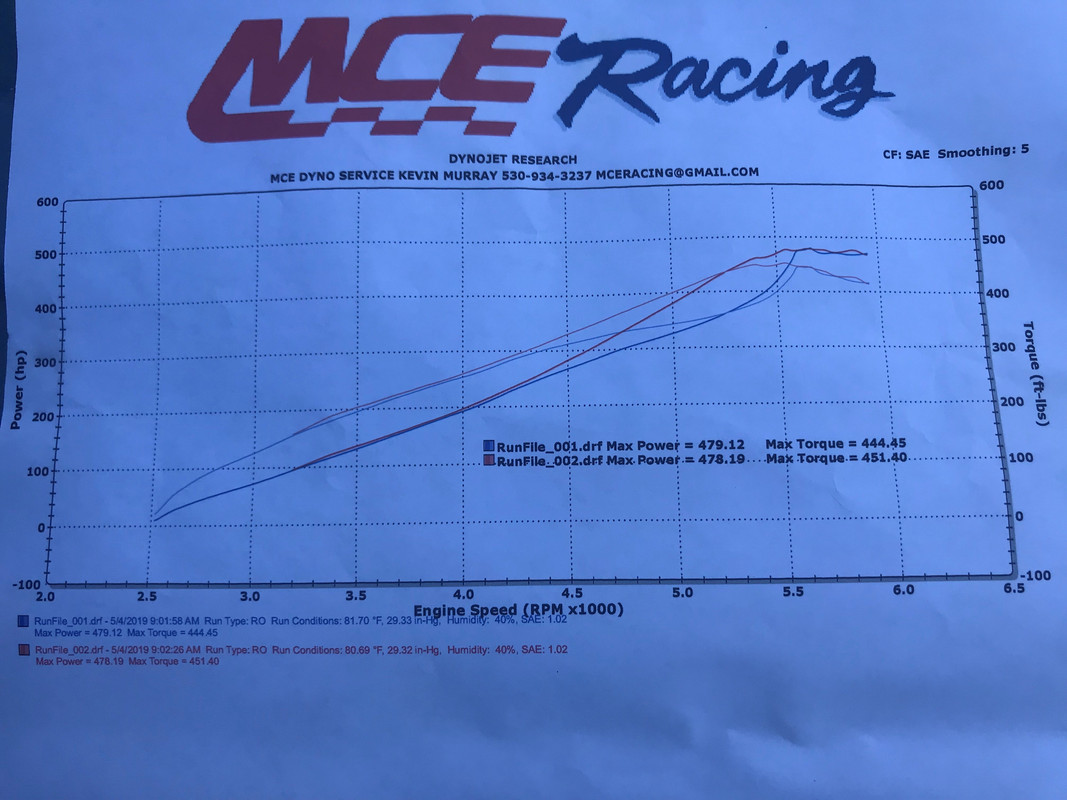

1980 C10 3975lbs
Stock LQ4
LJMS stage 2 cam, springs, & push rods
Holley High Ram
60lb deka's
T6 S475
6psi
E85
479HP
2000 miles on the setup listed above. Running 15 psi now with studs and a built bottom end. No clue on power but I've been beating on it for months.
