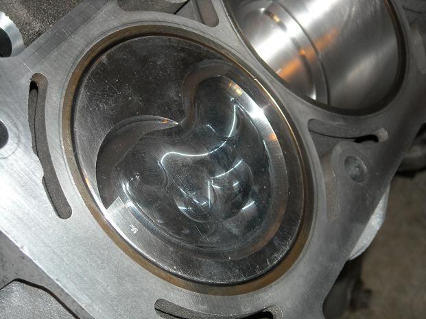

here is some pics of the pistons what do they look like?

Diamond -8.6cc dish?
They look just like my pistons - check it out on my site - date Nov 25th, 2006 (a little over half way down)

Here's my 25cc dish wiseco 4.030 piston for comparison.

It kinda looks like the 8.66 dish, but I think mine is deeper.
