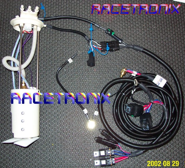

Originally Posted by smokinHawk
Ditto to What Mike said, im running the Hobbs switch to turn on and off the relay too and havent had a problem
Shouldnt this be in the fuel section?
Not all pressure switches are Hobbs switches.
Hobbs is a brand with a very high quality rating as it is an industrial switch.
If you are running a true Racetronix DP system then no alteration of the harness is required. There are two connectors beside the fuse holders which are ground loops with jumpers. Our Hobbs switch assembly is designed to plug in place of one of these jumpers which allows either pump to be controlled independently of the other.

Sounds great. Would this hobbs switch be installed the same way you would install one on an inline pump?
Do you have any pictures of you hobbs switch setup and drawn installation instructions?
If you have any Racetronix DP harness the Hobbs switch assembly we sell can be added as a PnP option. Do you have a Racetronix harness similar to what is shown above?
