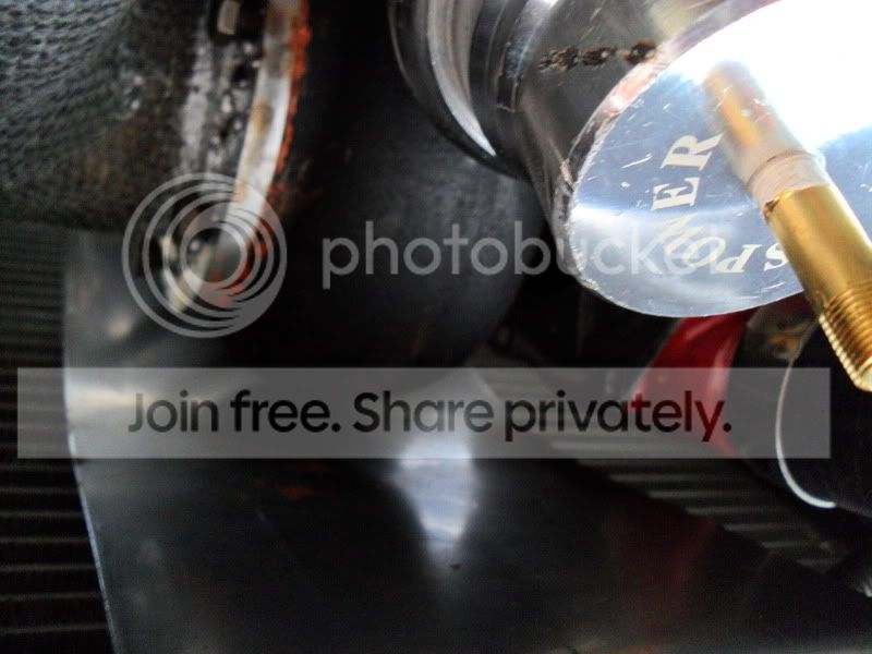

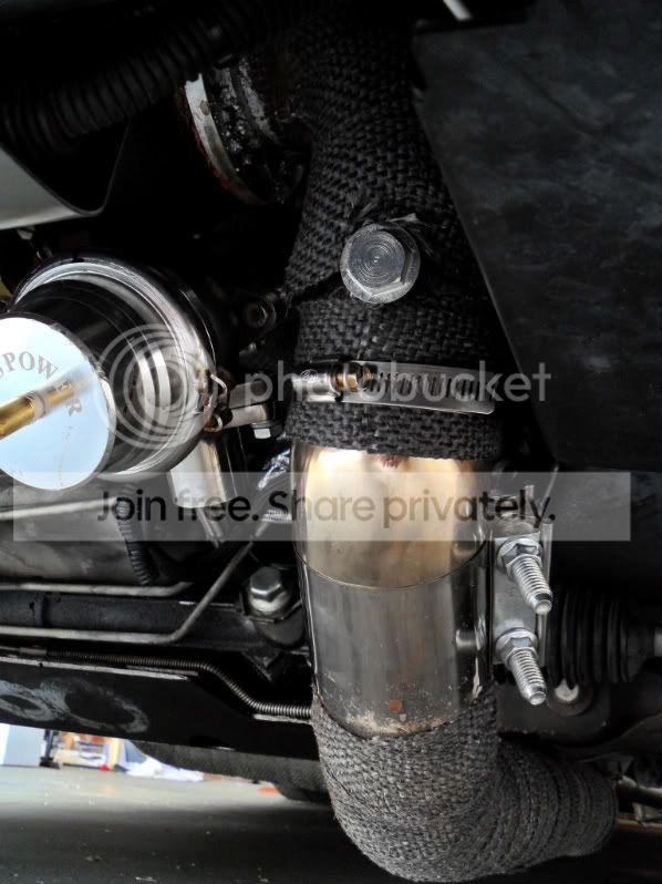

Here's some shots of the modded downpipe. After striking out with the standard downpipe setup, I tried hacking off the v-band clamps that were impossible to line up and clamp on and welded in a section of straight pipe using a band clamp to join the sections together. After that wouldn't stay together, I tried rigging up some tabs and bolting the two sections together, but then it interfered with the steering shaft so I got pissed and hacked it off again.
And this is what I came up with, I ended up taking it under the K-member and joining it up to the rest of the exhaust at the ball and socket clamp. Seems to be working great, no interference with steering and the ground clearance isn't bad at all...only 3/4" or so lower than the crossover pipe.

Looks really good. Do you have some more pics of the pipe coming off of the turbo?

I don't have any pics from an angle good enough to show the pipe right off the turbo but I'll be sure to snap some when I get down to the house again.

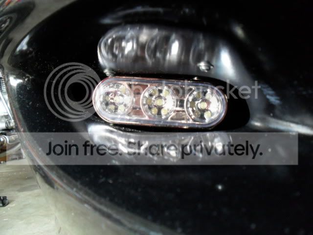

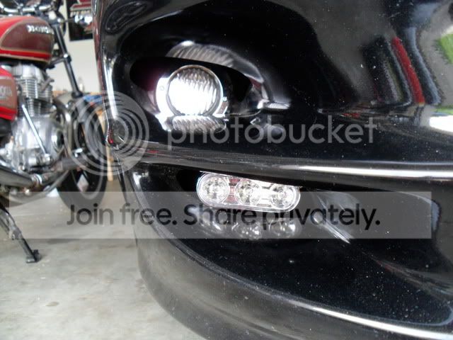

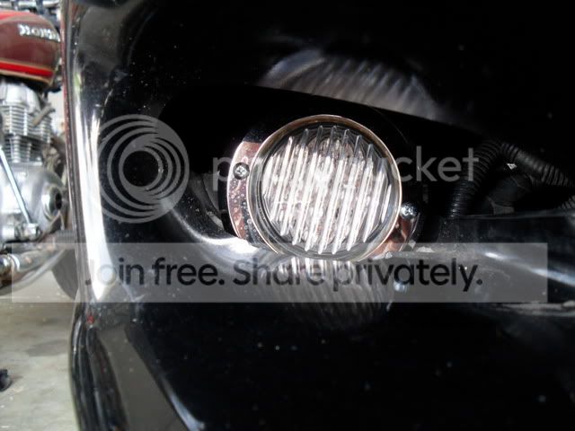

off topic but, any details on your front lights setup, haven't seen anything like that before.

^ +1 on the lights. Id like to know as well.

The lights are just generic eBay LEDs, the top ones are 3" round (IIRC) amber for the turns and the bottom ones are oval shaped white for the running lights. Wanted to modernize the look of the lighting a bit.

Finally repalced my camera, so no more crackberry camera phone shots...here's some pics of the downpipe right off the turbo and some closeups of the LEDs.
