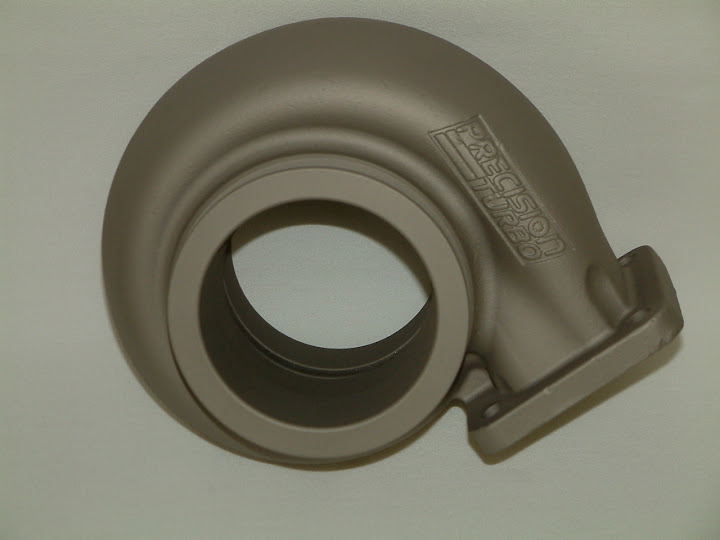

So long as your coater is using an actual 2000F+ High Temp Ceramic, you shouldn't have any issues with flaking. If someone tries to coat it with a traditional "Bright Ceramic" you may as well throw $100 out the window as it's useless for most hot-side turbo applications.
Whether the ID is coated depends on the material being used and the builder. Some don't like the ID coated for fitment issues and others want it all coated. Again, survival depends on the correct material.
Someone mentioned a blanket. The more insulation the better, but it's a good idea to Ceramic Coat it first so the housing doesn't become a rusty mess.
Great looking work. it's funny you show a PTE housing. if you call PTE and have them ship it coated it isnt coated on the inside and the highly recommend it not being coated. it closes the clearance between the wheel and the housing to close to allow for "normall" shaft play.
you guys had any of your coated ones hit?? or scrap off the coating?? got any pictures of one that has ran it?? if you guys can do it i might send mine to you. would love to have the inside coated also

Now thats a good point ! I did think about clearance issues inside,,I guess thats a question the turbo builders have to answer.........any builders out there, that want to chime in ???
