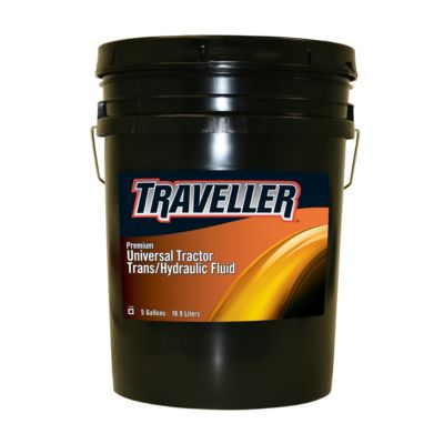

5 gallons for $37
Think I paid about twice that for hy-gard at a John Deer dealership. Still cheaper than buying a quality ATF by the QT.
http://www.tractorsupply.com/en/stor...ic-fluid-5-gal

5 gallons for $37 Think I paid about twice that for hy-gard at a John Deer dealership. Still cheaper than buying a quality ATF by the QT. http://www.tractorsupply.com/en/stor...ic-fluid-5-gal
When using this fluid, did the converter get tight by just a little? I am considering using this exact fluid. Would just like to know if the stall went down for you? I guess it would since the viscosity is thicker than dexron.
Yes it tightened up the converter a bit. Same as Hy-gard near as I could tell.
