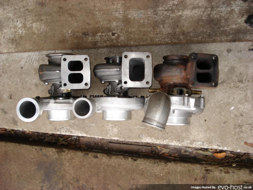

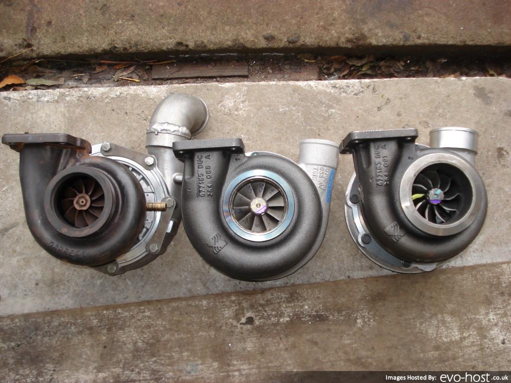

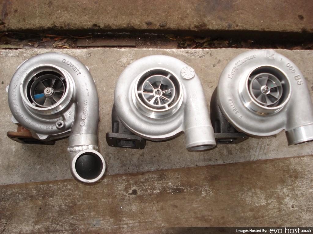

The 4088 and 4094 are big, although big in different ways to the BW's. So yes your TO4R would be a fair bit smaller, at least around the compressor cover area, although this may reduce any abilities slightly over a bigger unit. Not sure how turbine wheel would compare with the T04 ? I think the impeller on the 4088 is very similar in size to the 366.
The 4094 has a fairly bulky compressor cover, I think the 4088 is the same ?
Left to right. 4094R, S364FMW, S366
Left to right, S366, S364FMW, 4094R

Yes I'm trying to hide these things away... and no doubt there's some notching and boxing in to do... but I'll never fit a turbo the physical size of a s366
