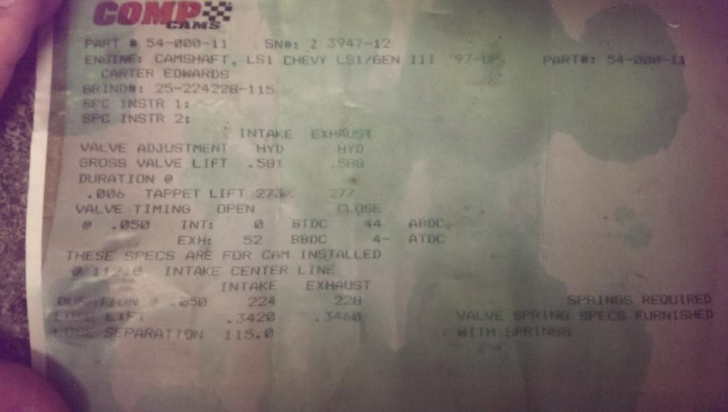

Here is the cam card. Is it what you thought. I don't know much about cams. I need springs anyway. So buying btr is not a problem. I'm doing a budget build. Got the cam for around $150. Didn't want to buy a $400 spec cam. But don't want to run this if it's going to be bad or hurt.

Yup... good ole Xe-R lobes...
Like i said... itll work as long as you put a GOOD valve spring on it... a 1218 isnt going to keep that cam stable in a boosted application.
Reality of it is... that lobe is much too aggressive for a boosted app and I'd never suggest or grind a cam using those lobes.... but its what you got and with a good spring it will be ok at Moderate boost levels.
