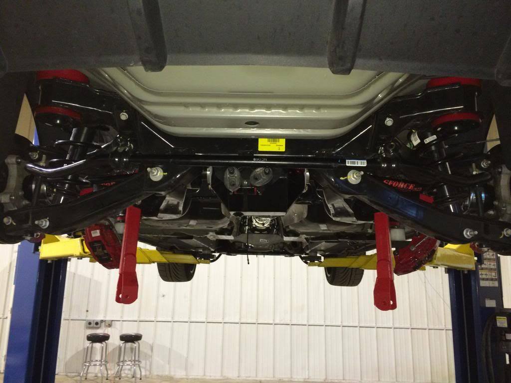

extra pictures during the build
9" rear end
bmr goodies
ams 500 in glove box

One of the problems i had along the way.
4" driveshaft fit like crap, ended up with a nice groove all the way around it and ended up vibrating like crazy. So i got a carbon 3.75 instead.
