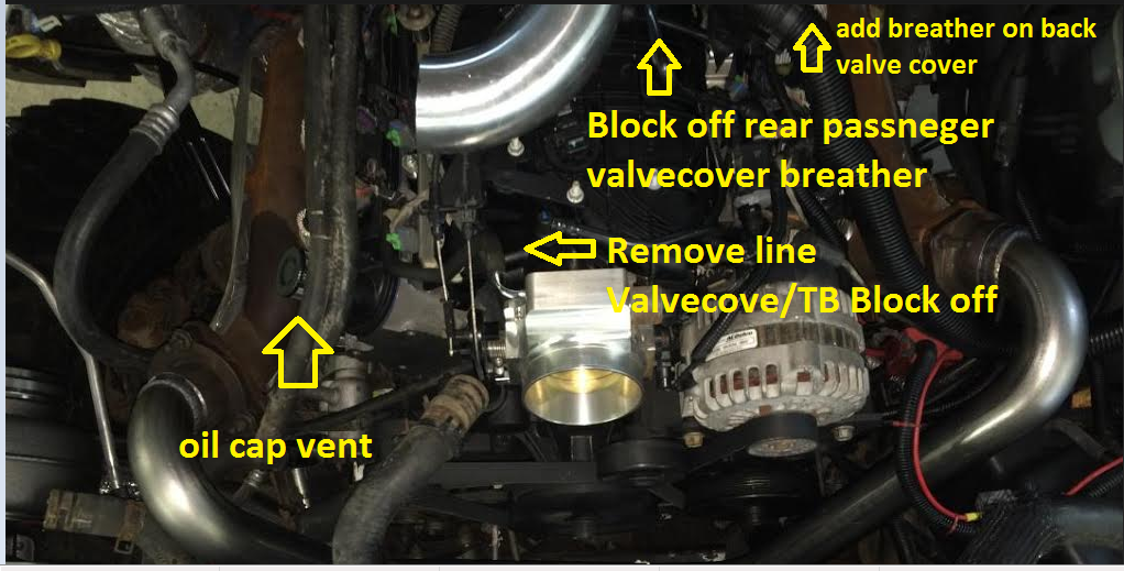

So I started my turbo build with a BWs475 on my silverado with Lq4 and the guy helping me told me I dont need a catch can and just put breathers on both valve covers and block off my intake and throttle body vacuum lines.
Will this work or do I need to add lines to turbo and catch cans? I searched and coming up short on this topic.
Thanks for any help

You need some sort of PCV system. You have to get rid of the gasses & moisture. Breathers wont do it ........ I learned the hard way.
Get a good Mighty Mouse catch can system !

Or save the $150 something dollars and vent the valve covers to your downpipe. If you insist on a catch can I'll sell you my Mighty Mouse can

I've never ran a catch can on any of my turbo setups and just vented the valve covers with breathers and have never had any problems doing this. I'm no expert on this matter though, just what I have done all the time. You will get oil smell every now and then doing this though.

Can I ask how you vent to the down pipe? I dont want to spend $150 just to add something thats not needed or can find a better alternative.
