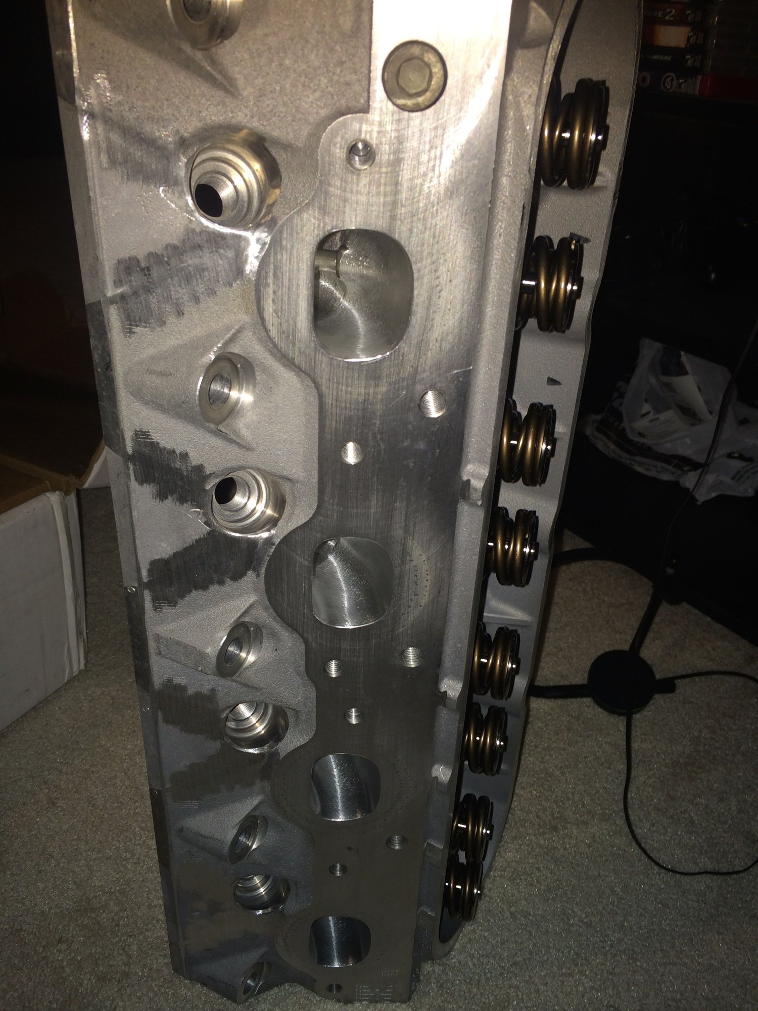

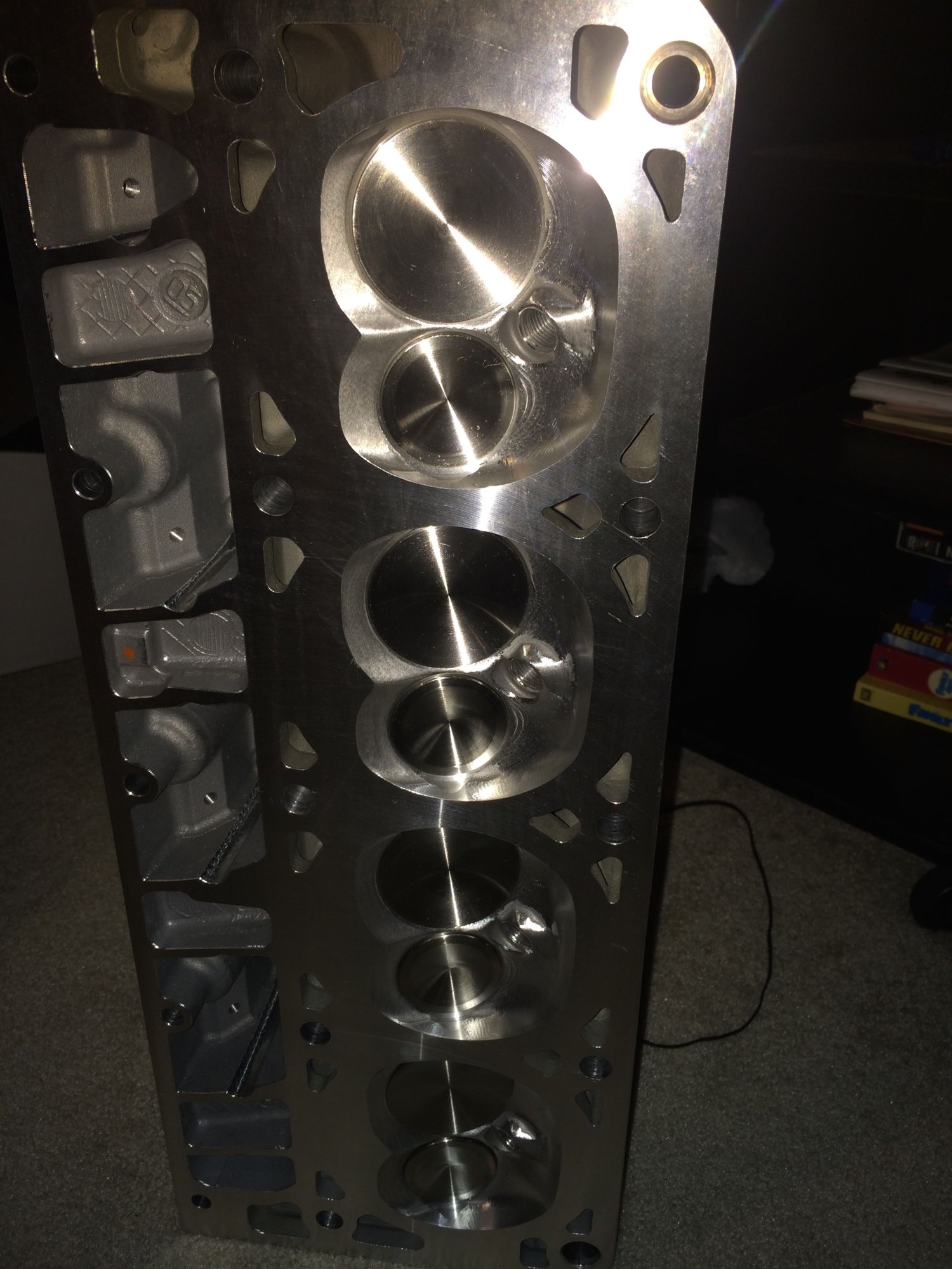

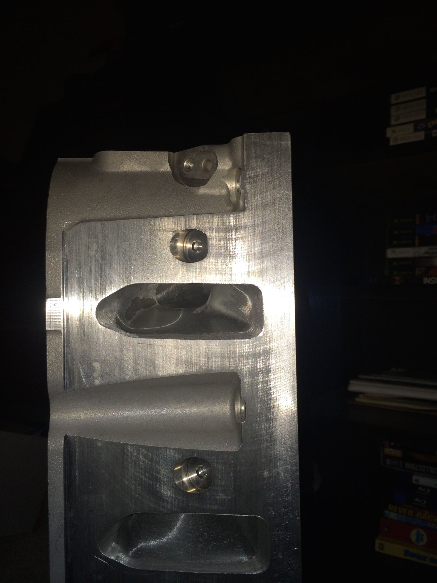

Custom leather seats from LeatherSeats.com and had the SS embroidered.
2001 camaro, presently an LS1 423RWHp thats already sold in preparation for the LS2 build. With a T56 transmission . BMI suspension components. Baer brakes, HRE wheels
Custom gauge overlay from McNords custom gauge overlay.

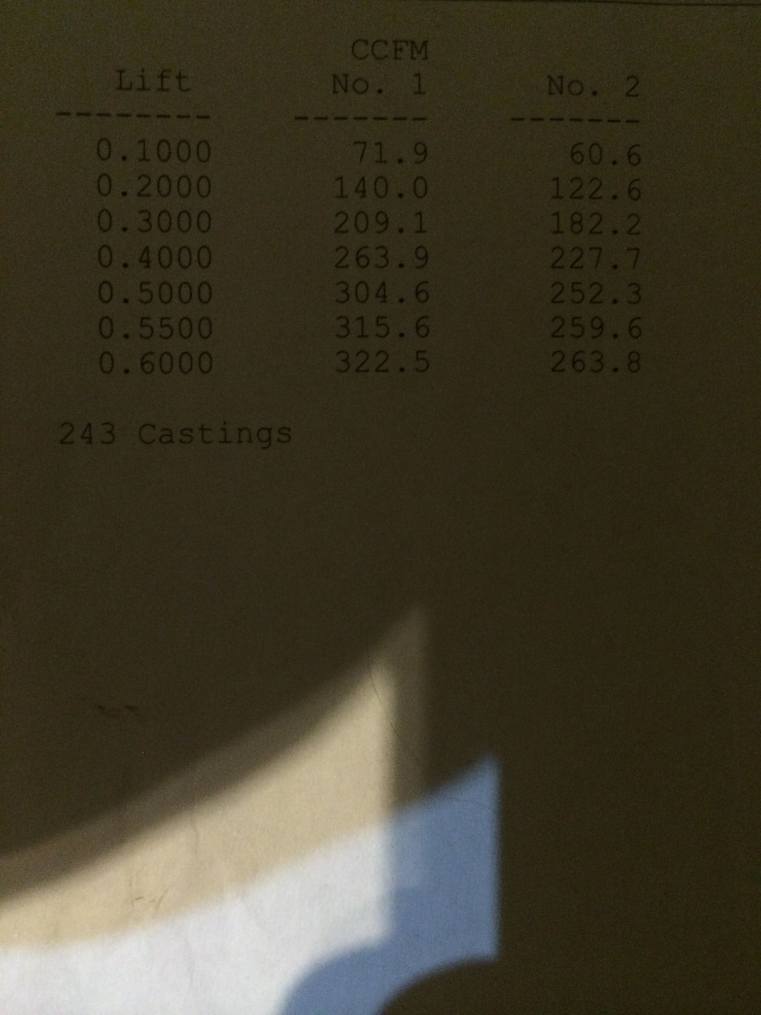

Just posting some engine build details. Total Engine Airflow Stage 2 port job.
The flow numbers from my 243 stage 2 ported heads, done by Total Engine Airflow.

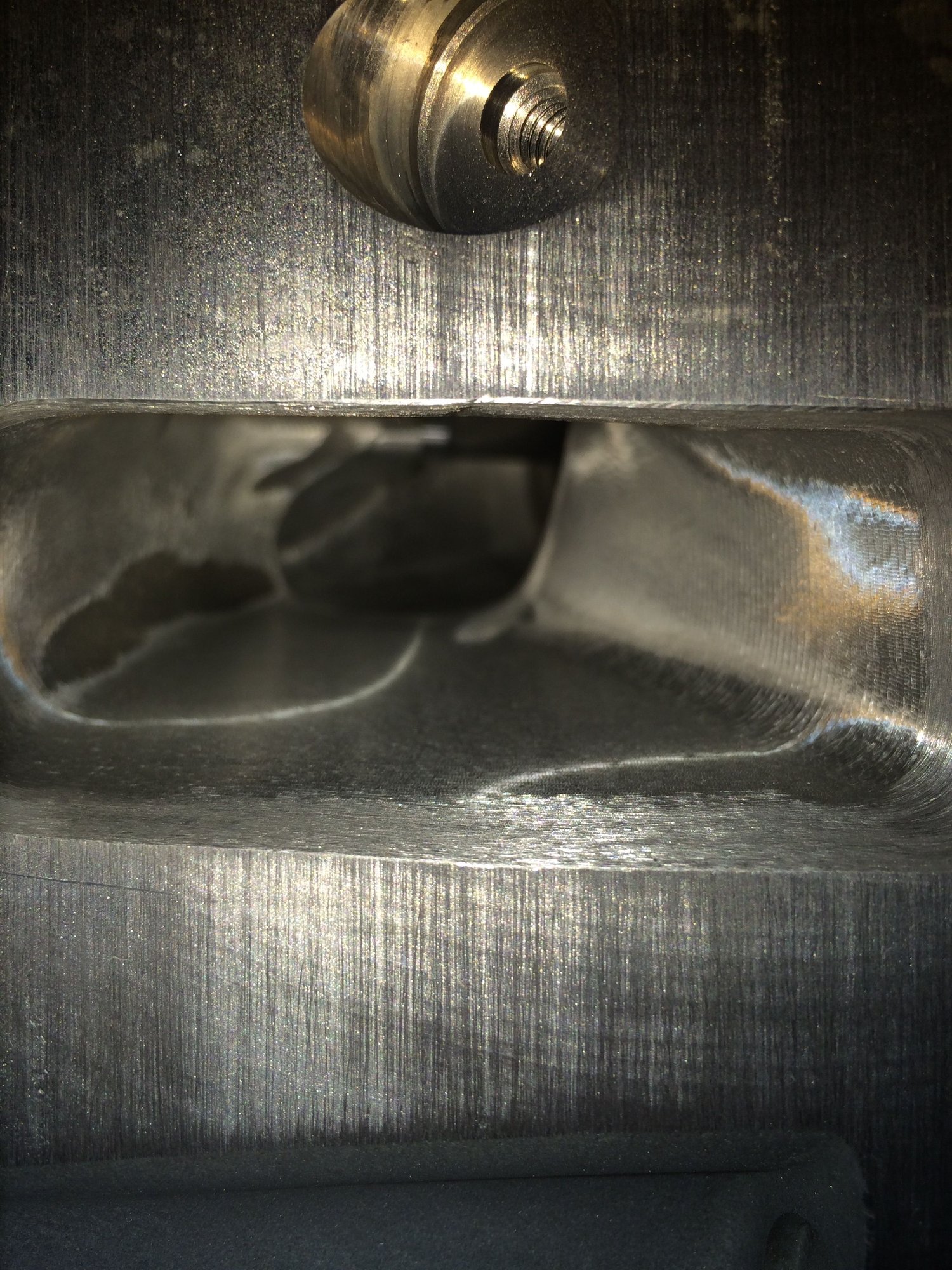

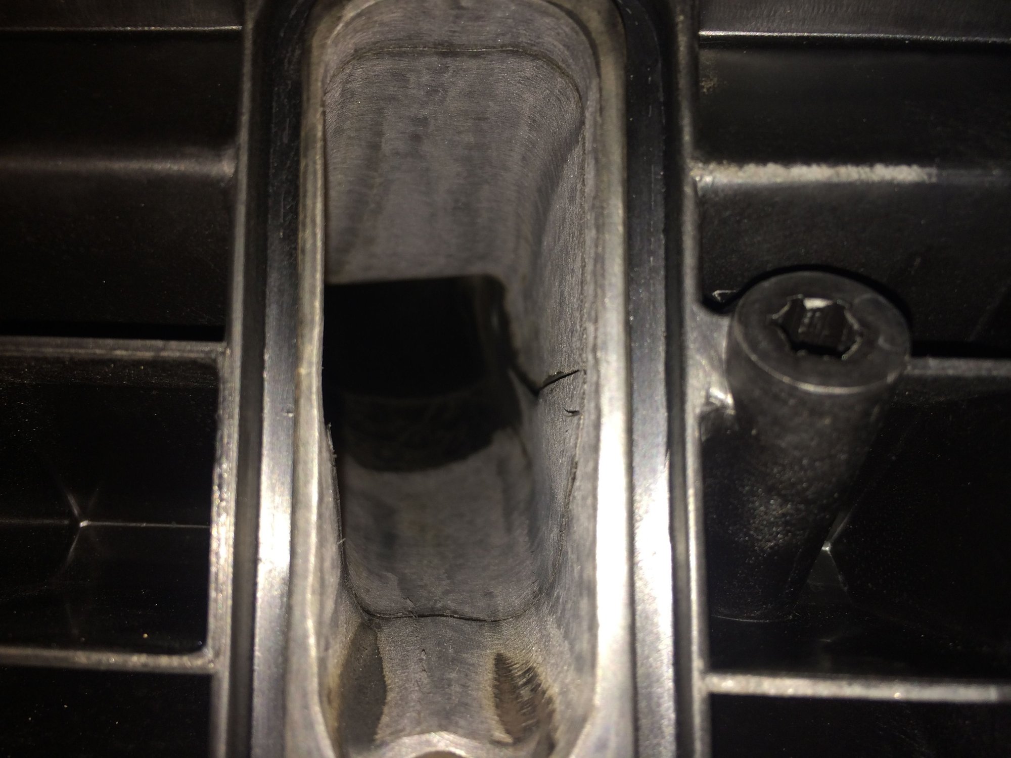

Photo of peak speed extreme port job on my LS2 intake, and have purchased 102 mm throttle body by Nick Williams.

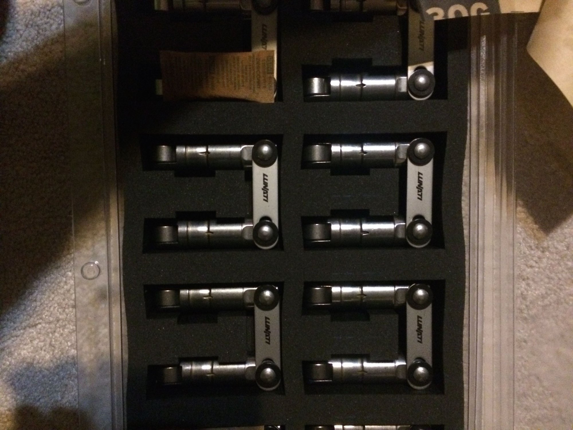

Valve Train upgrades to include, Lunati (72532-16) Cam shaft specced by Vengeance racing. Cloyes hex adjust timing gear.
