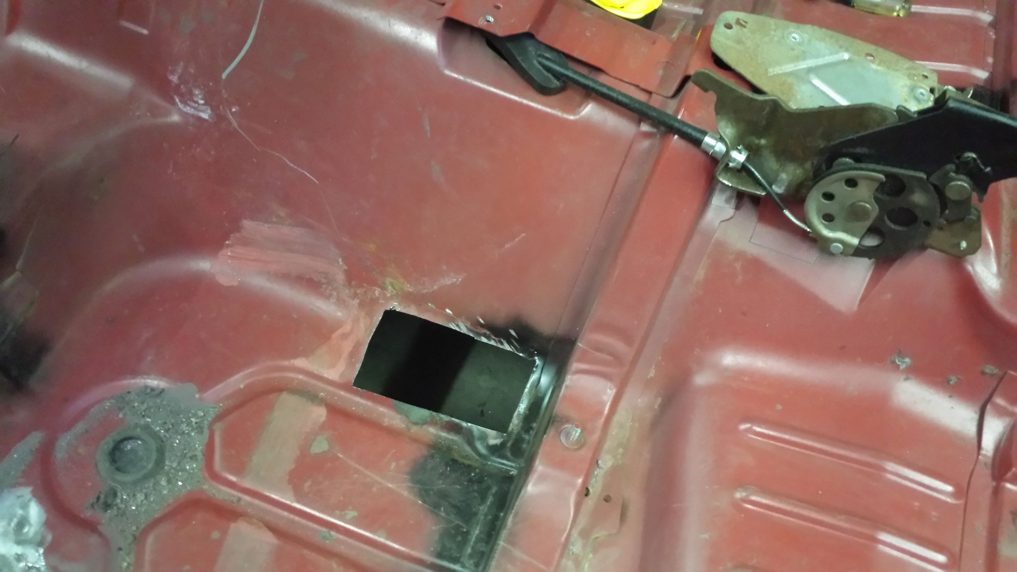

Okay, so i feel like a project log is well needed by now. Little break down for everybody. Bought the car locally, was already painted synergy green when i got it. When i got it home i found hacked floor work with putty slapped everywhere with undercoating all over it, along with holes in the front section of the floor, and the typical cut out fuel pump hole in the floor because of lazyiness. Well i patched all that with parts from another car and back to being a good roller again!

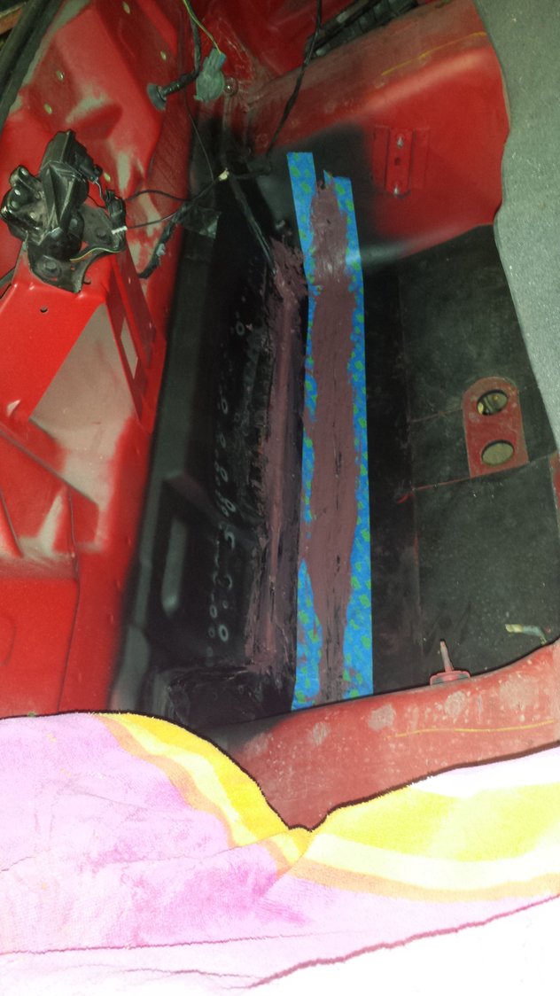

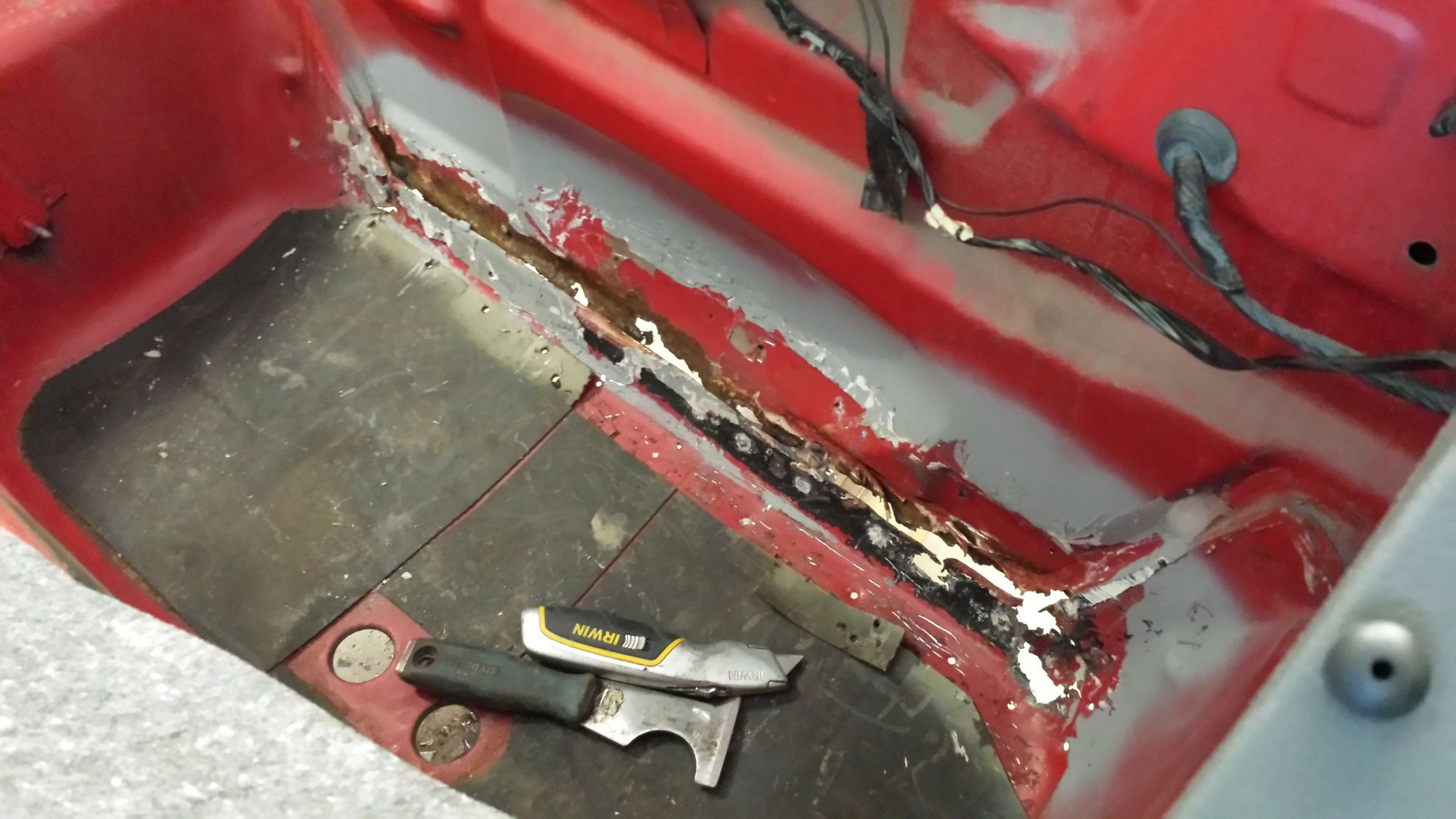

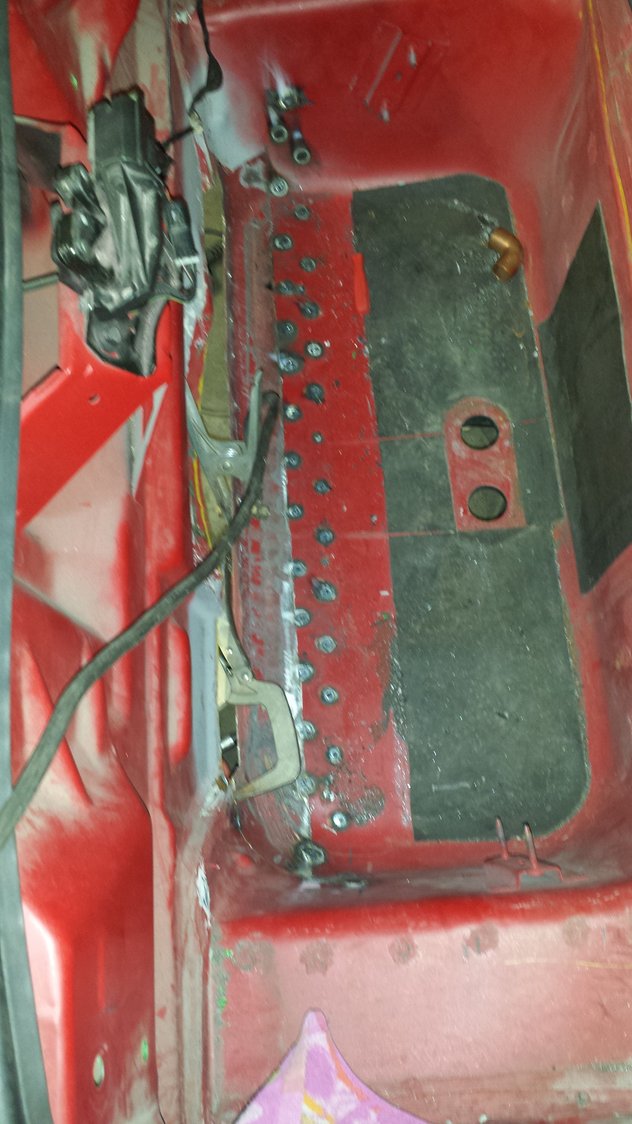

all the rust we found when we pulled the carpet out
here most of the rust removed

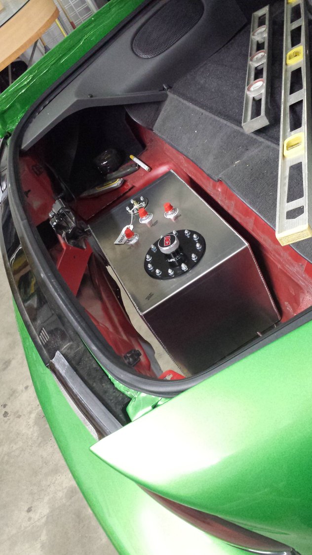

fitting the fuel cell while were at it to be sure its going to fit

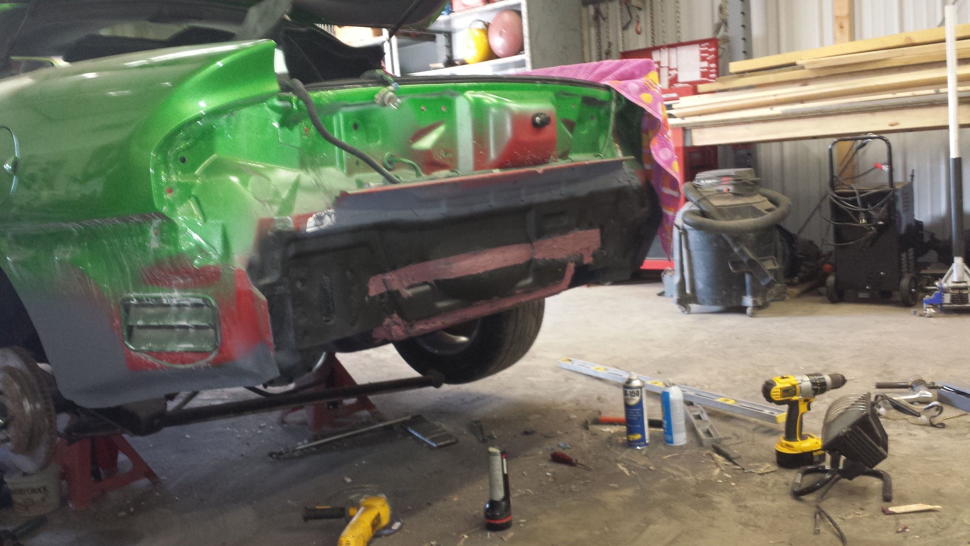

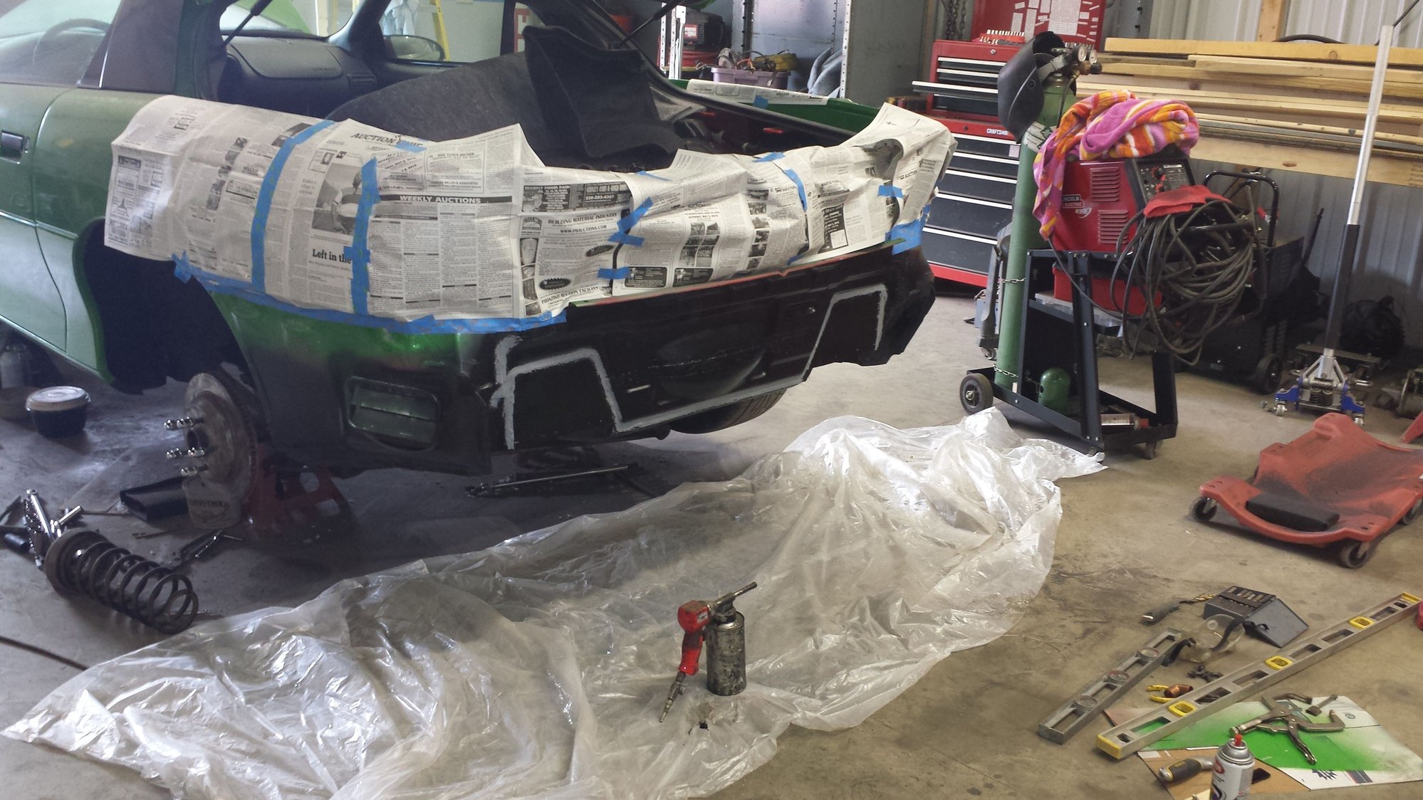

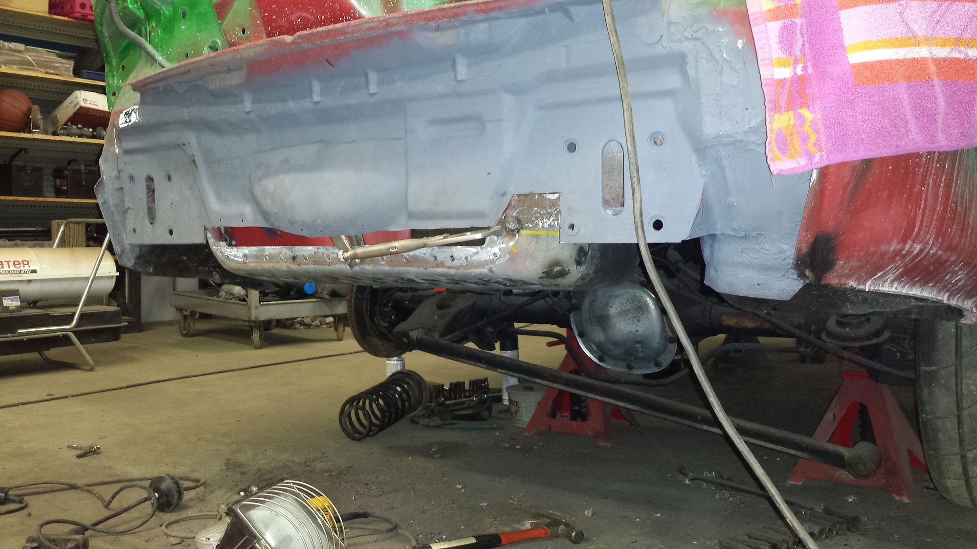

new trunk pan plug welded into place. Not a show car so just did it the fastest and easiest way possible. Anything is better that riveted sheet metal with putty
welded new panel in and seam sealed it. primed and painted the bare metal.
seamed sealed and primed and painted the bare metal
ran a final layer of seam sealer on it.

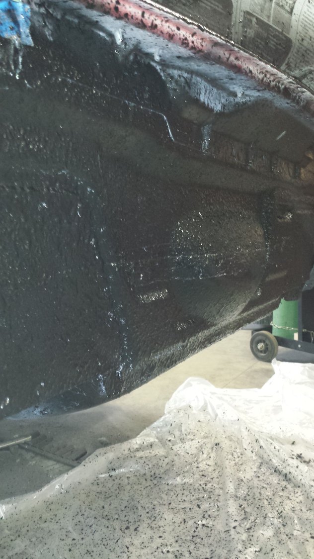

used our bedlining gun and used some left over bedlining we had from a previous truck to seal this up for good . Didnt turn out too bad considering how quickly we did it.

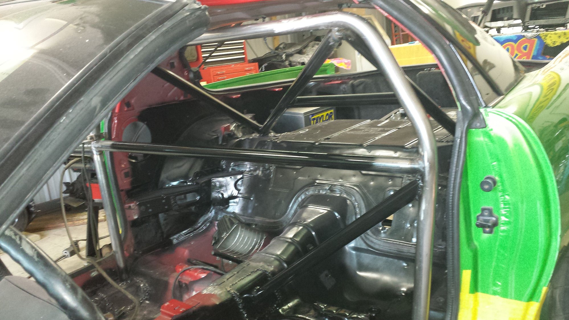

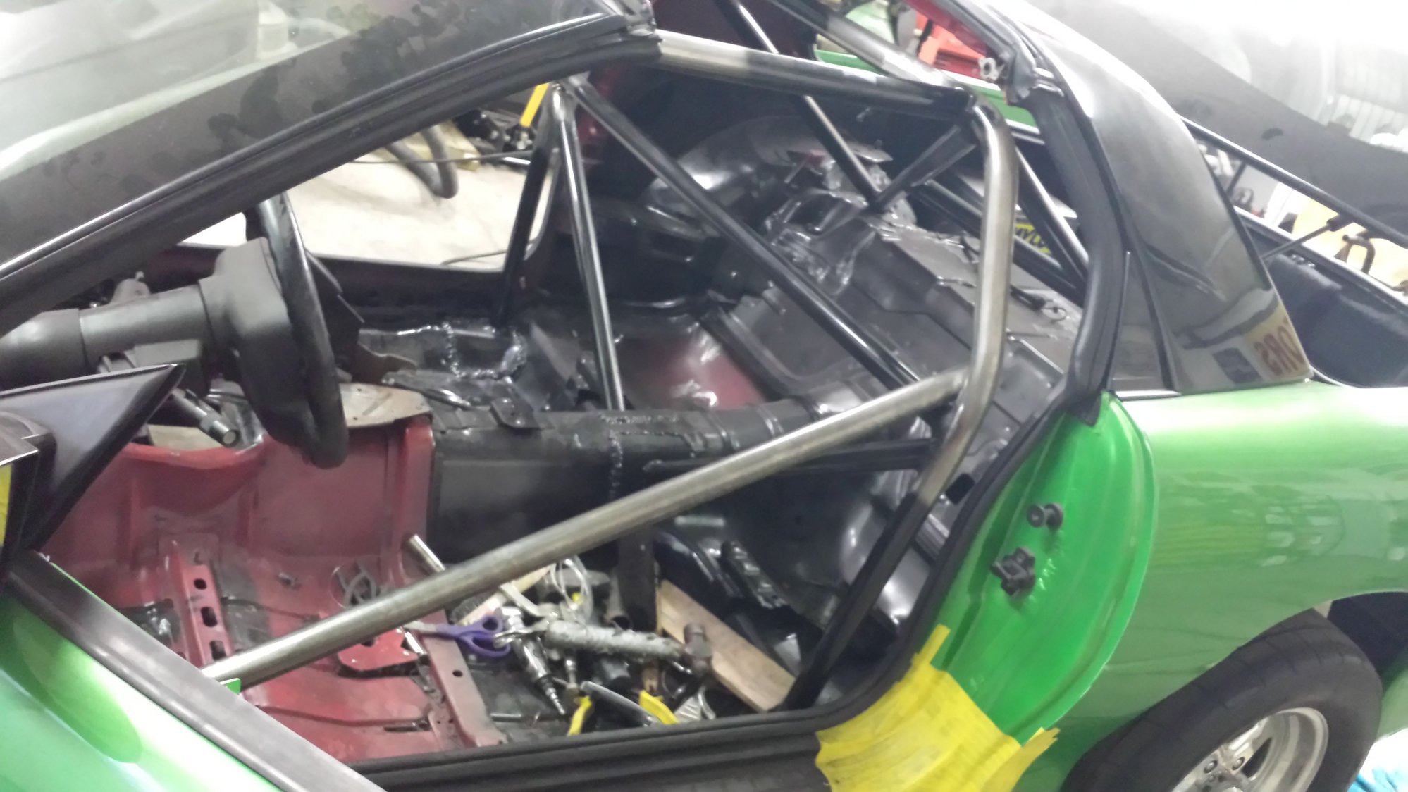

rust directly on the seat buckle hole. Dont want that. Had to remove the inner panel and weld a new inner panel in.

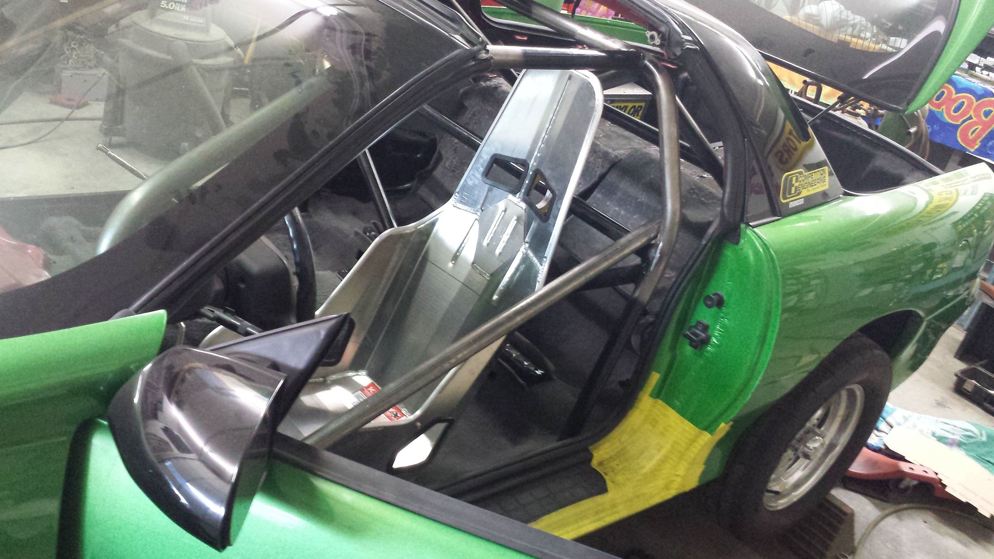

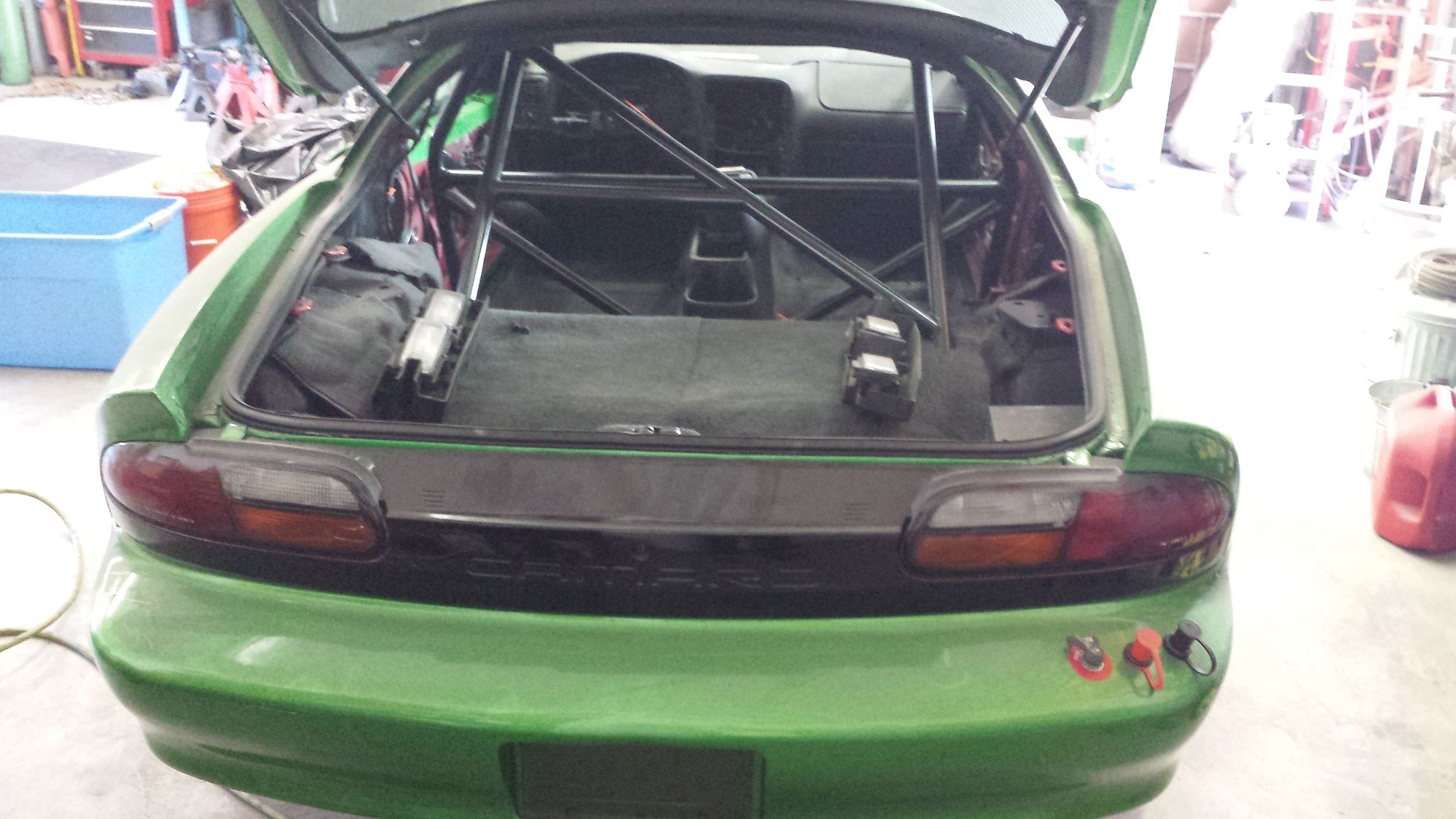

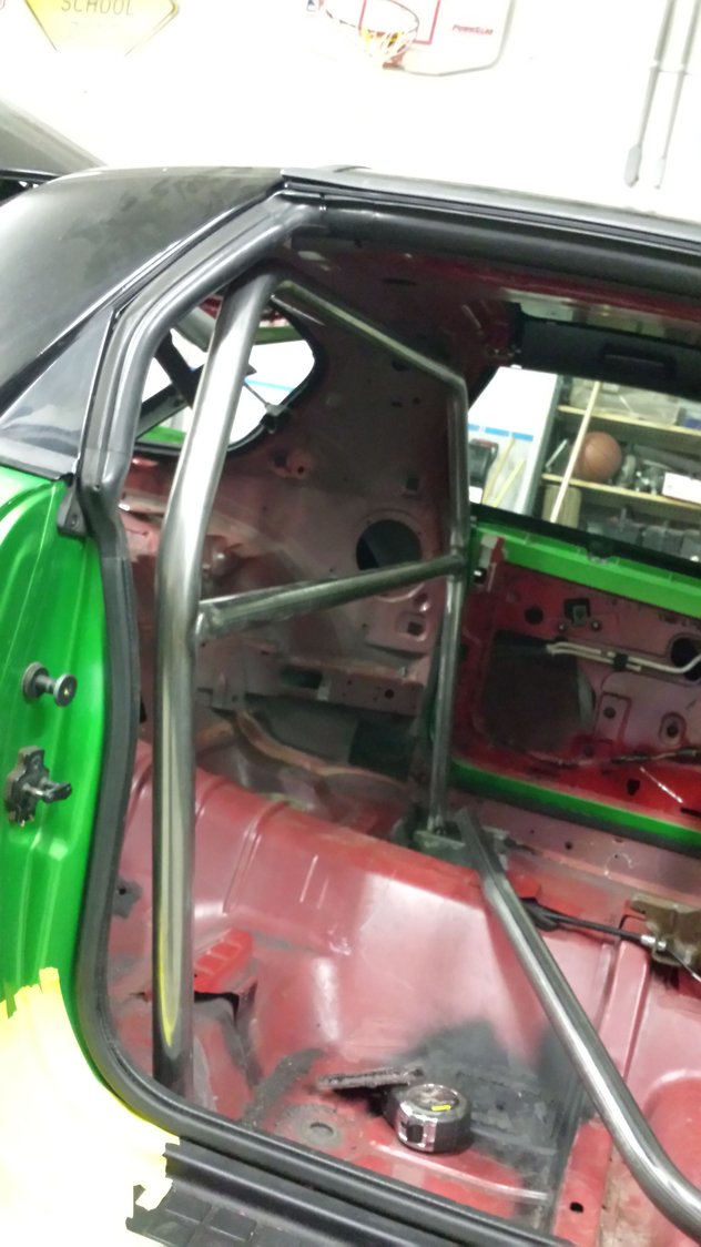

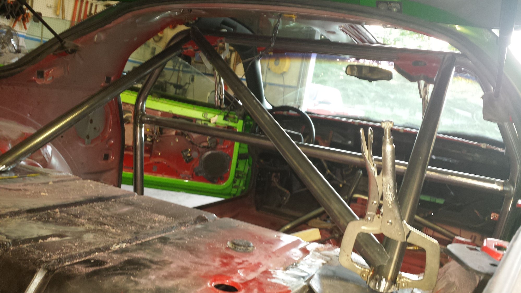

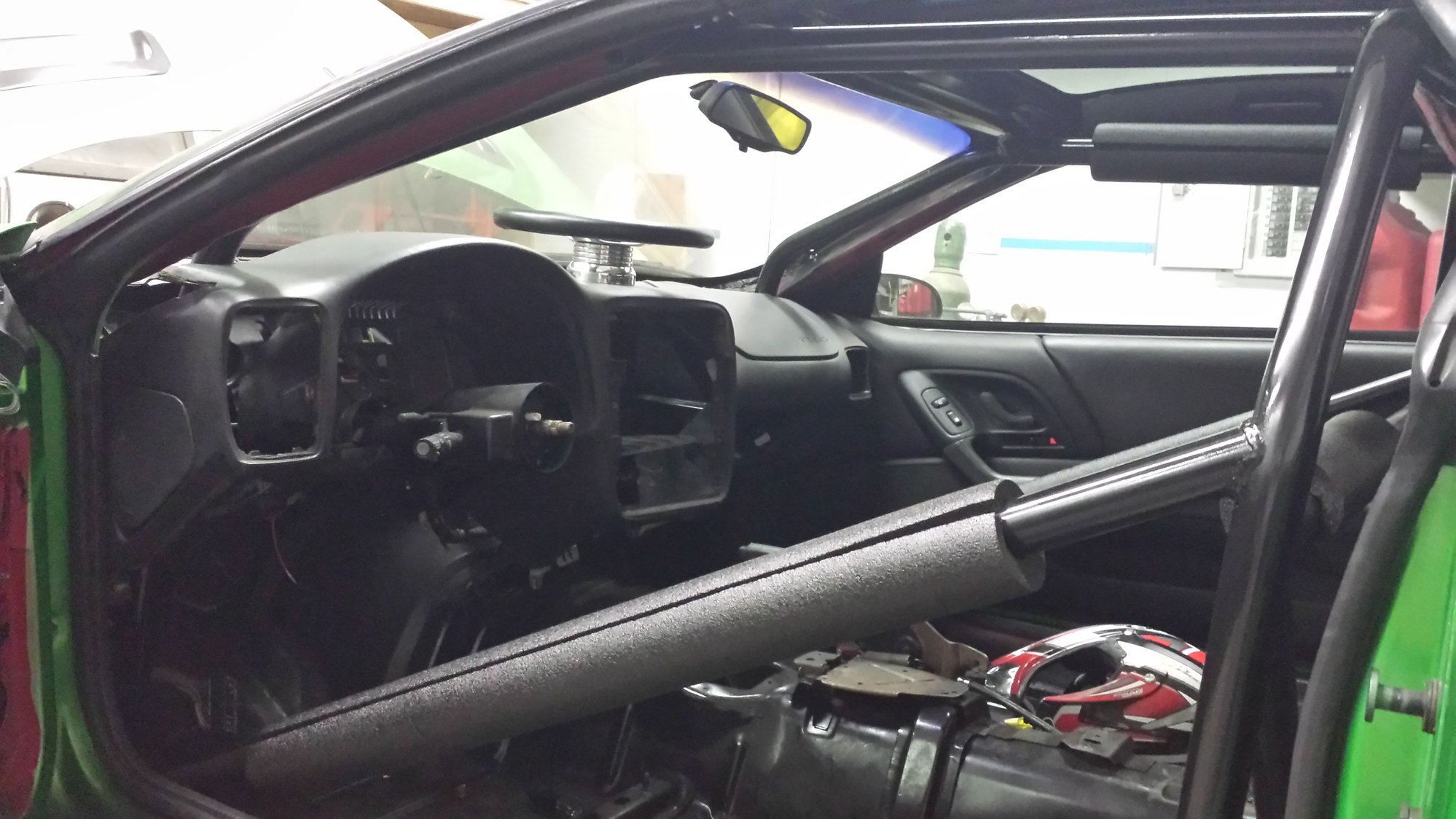

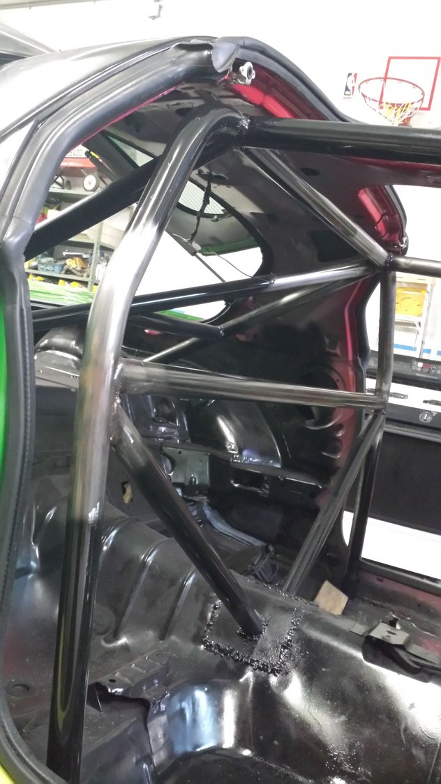

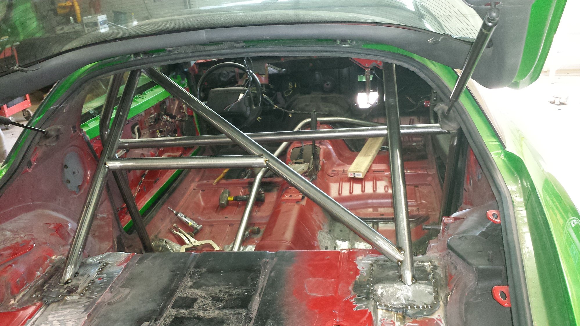

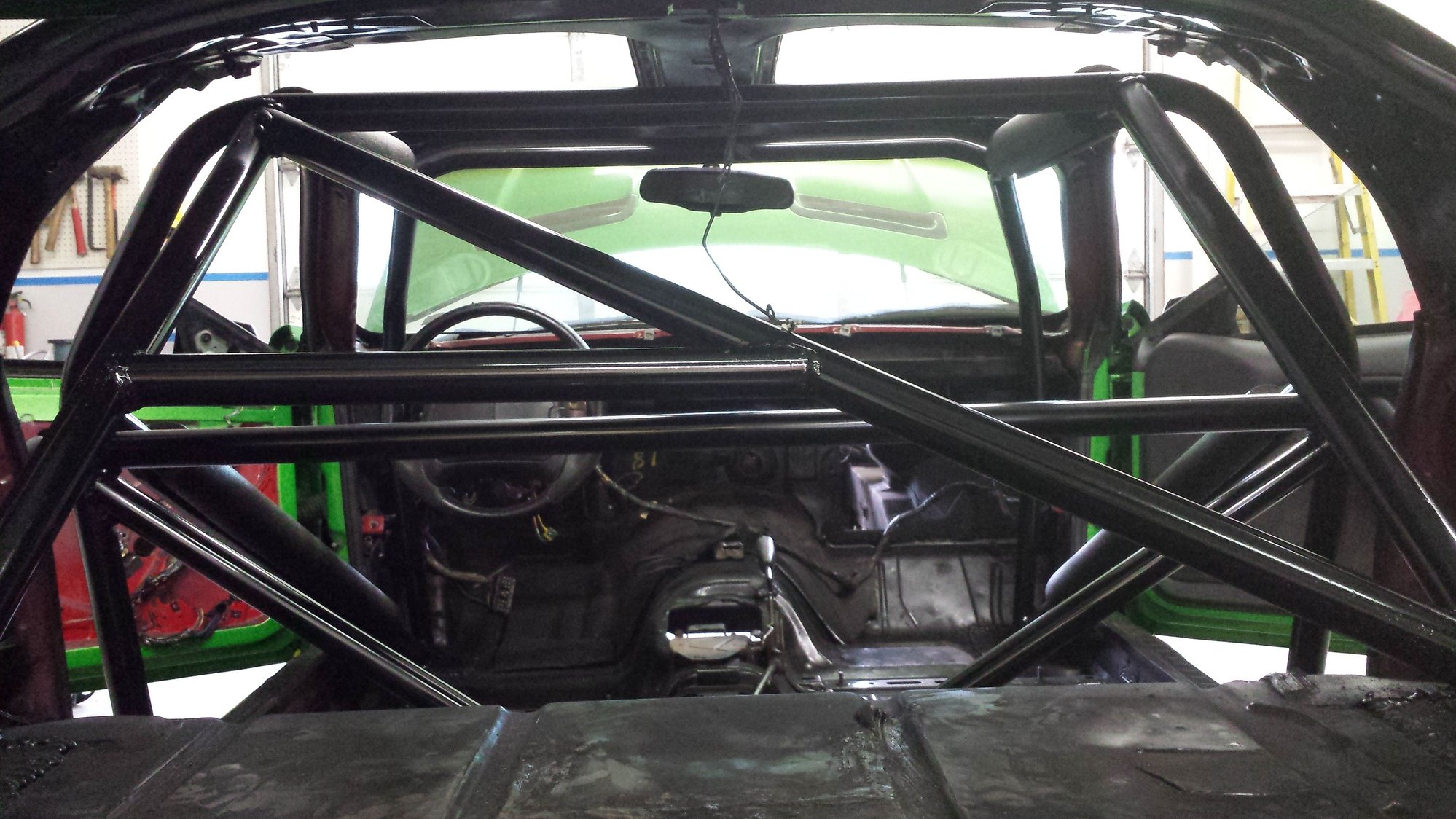

Fitted up the comp engineering cage. Worst cage ive fit up yet .
here you can see we decided to not go with their cage and make our own along with using a few pieces of pipe from their kit. Everything still had to be cut and notched.
coming together
coming together
test fit carpet and seat. Last bar isnt welded in yet.
finished product
finished product

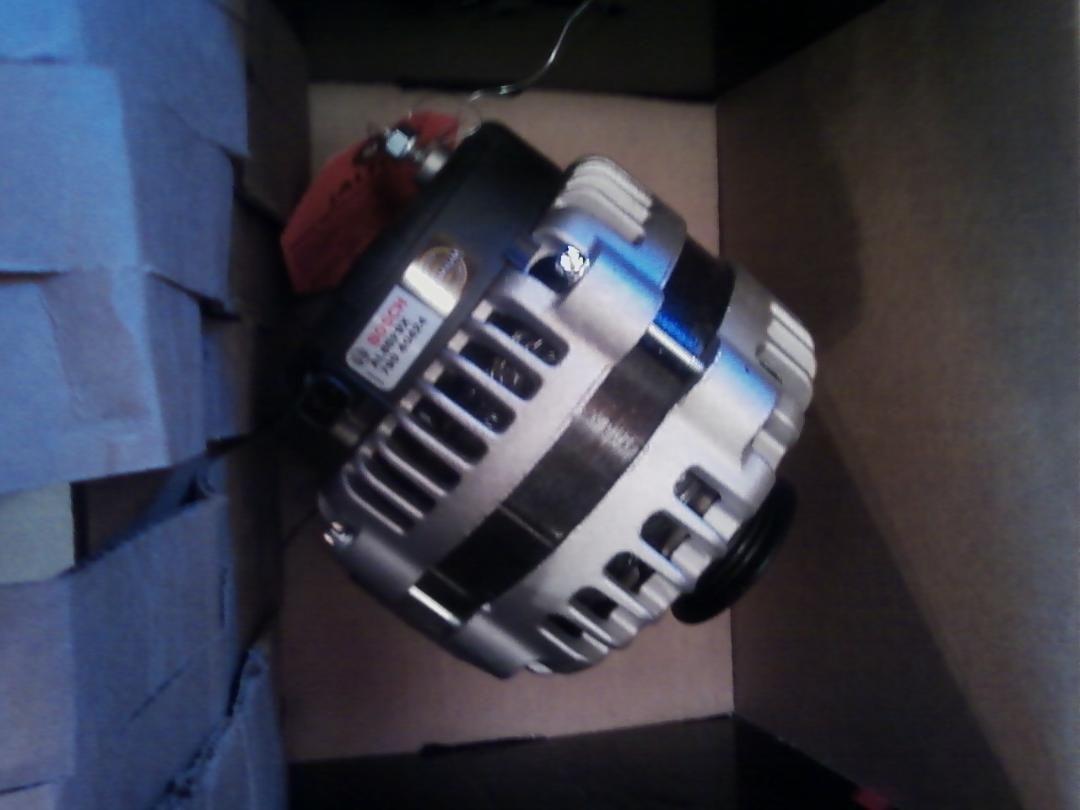

dr44 truck alternator

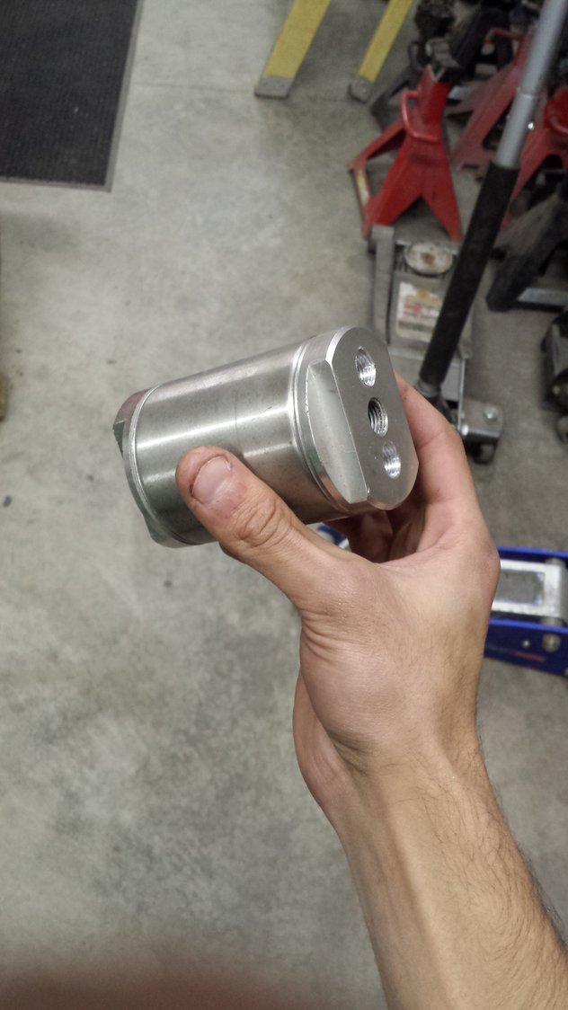

vac block we decided to make

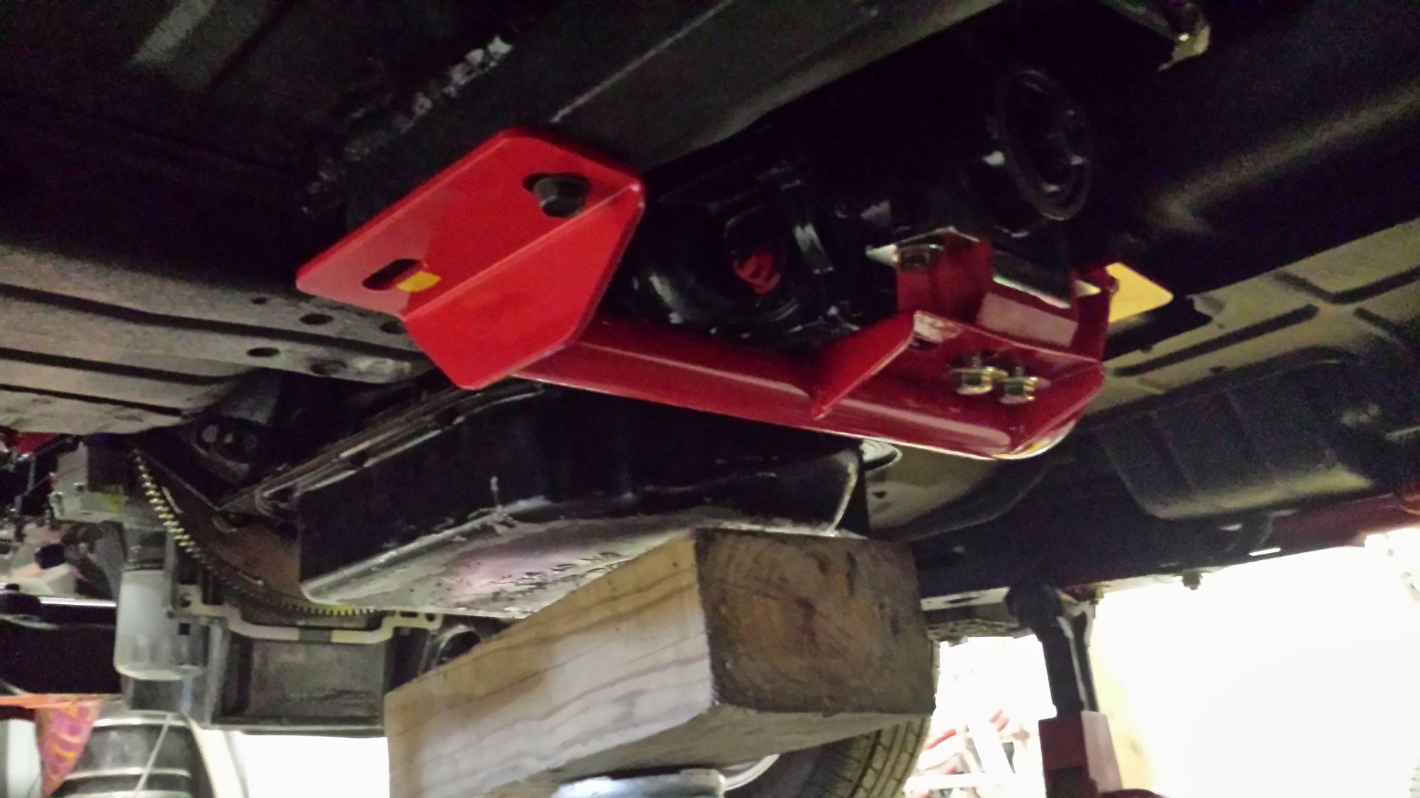

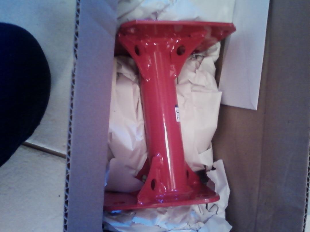

bmr th400 trans mount

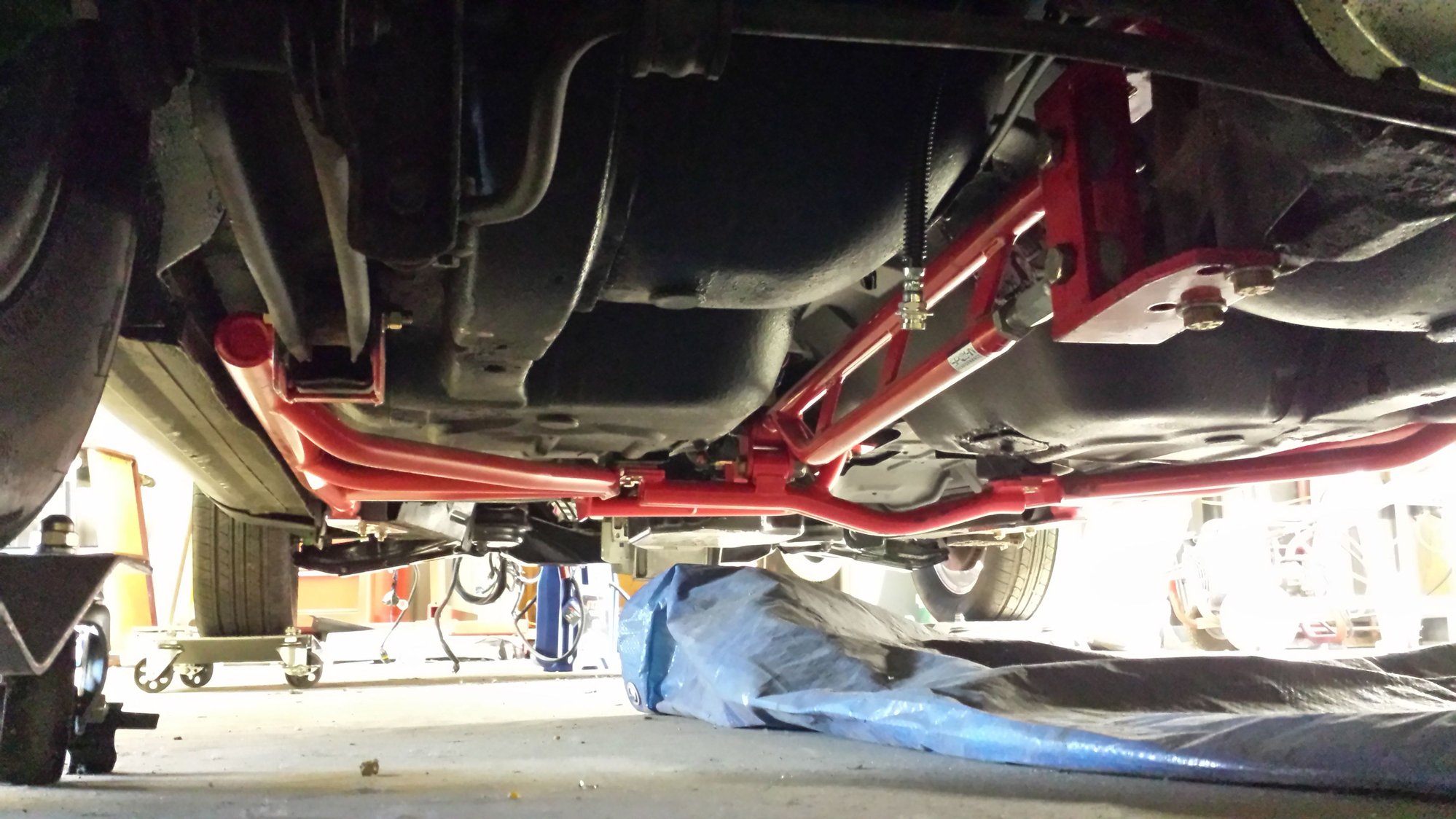

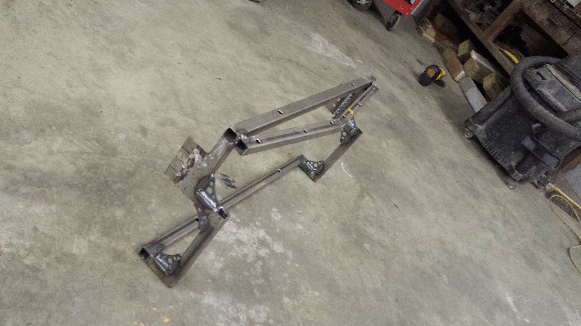

subframe connectors and adjustable torque arm mount in

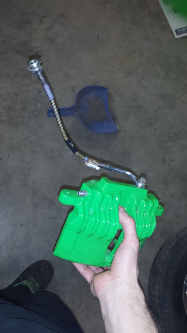

calipers color matched

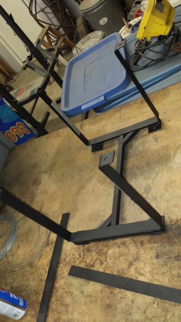

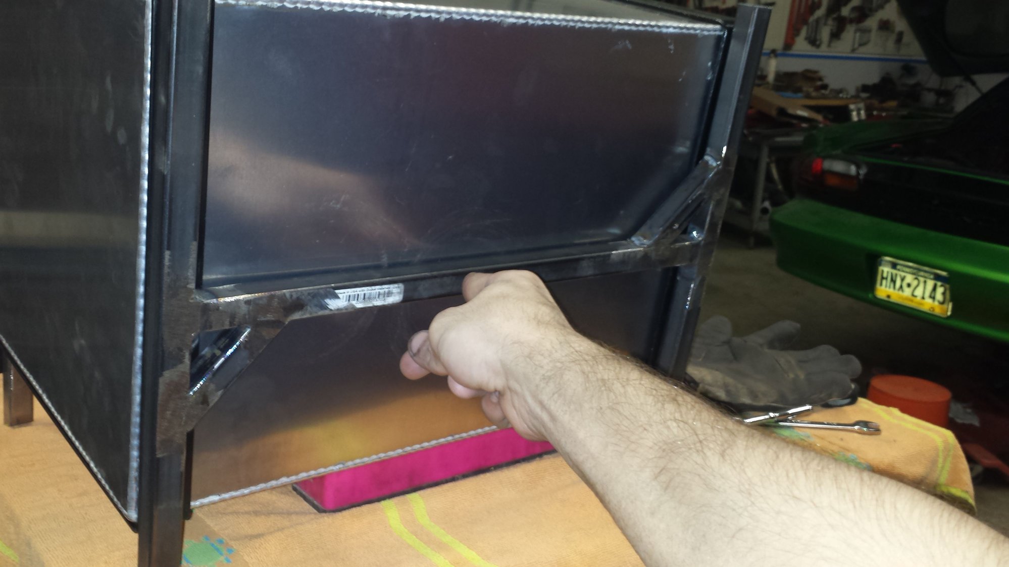

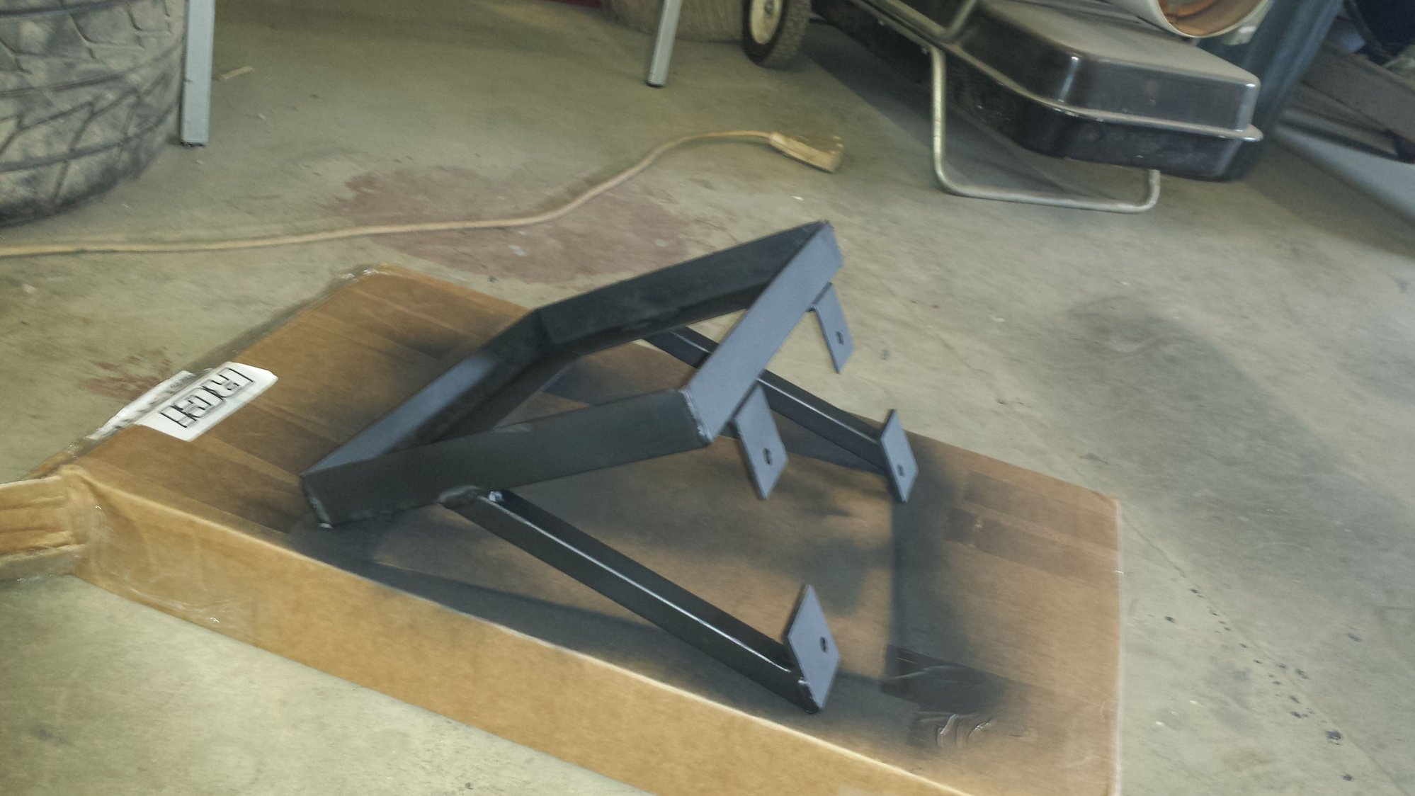

fuel cell mount we fabbed up
finished fuel cell mount .

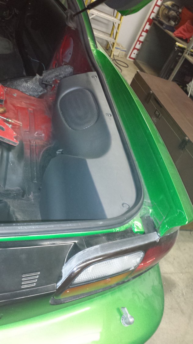

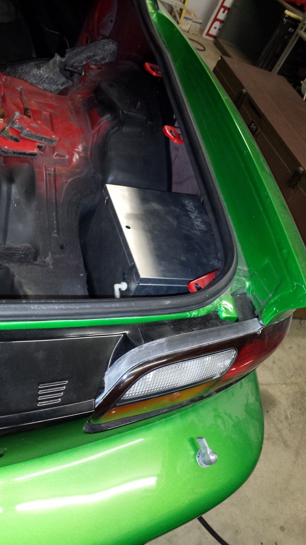

battery mount we fabbed up to hide behind the spare tire panel
battery completly hidden

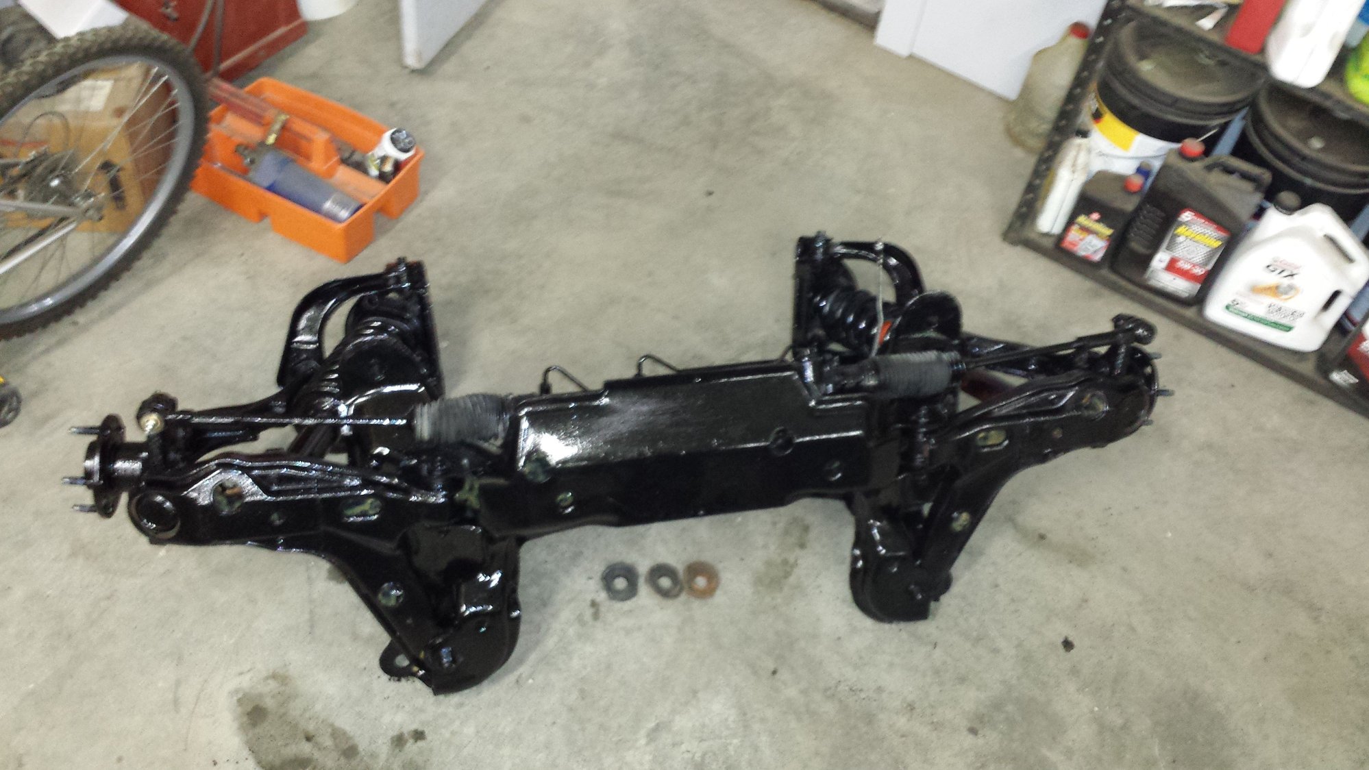

southern k member. Sanded and resprayed.

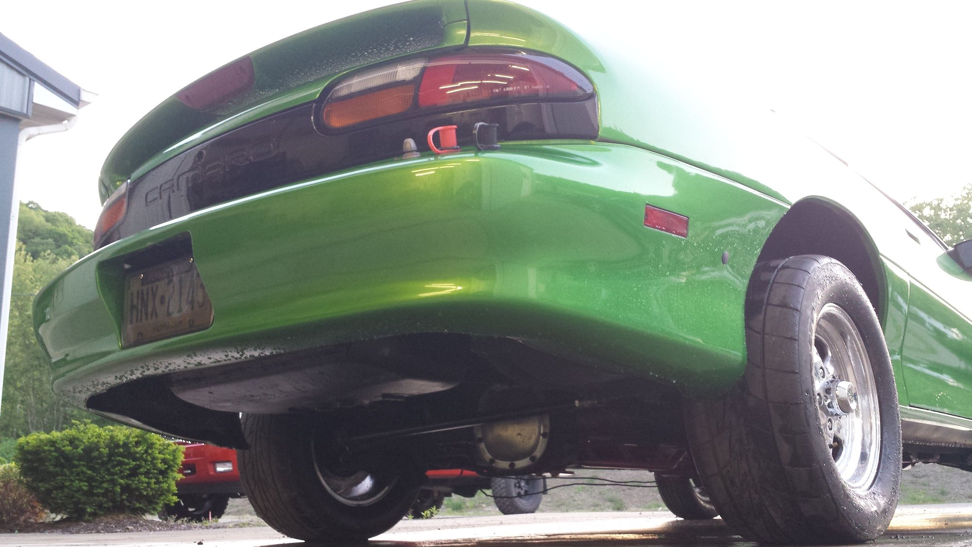

random picture when i washed it
fuel cell and battery hidden completly

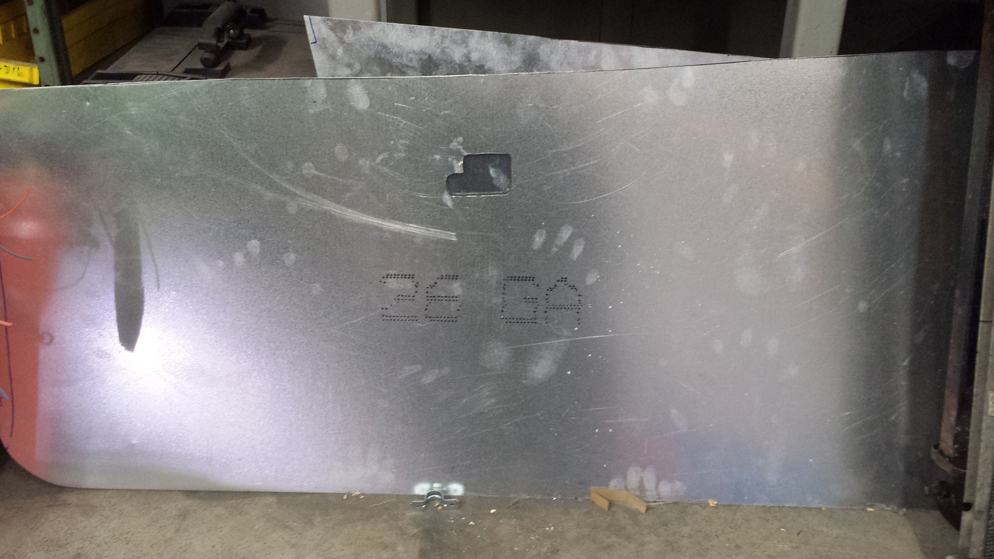

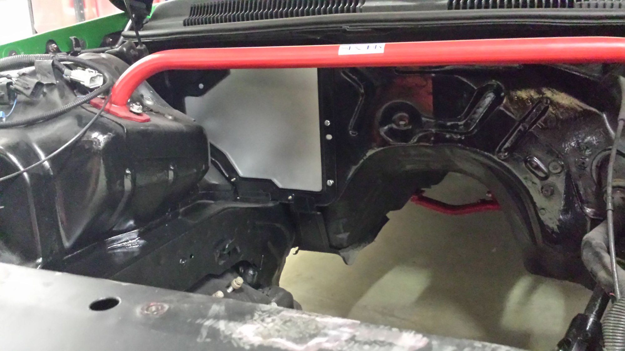

hvac delete

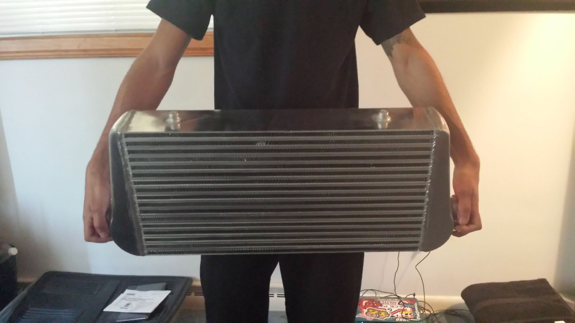

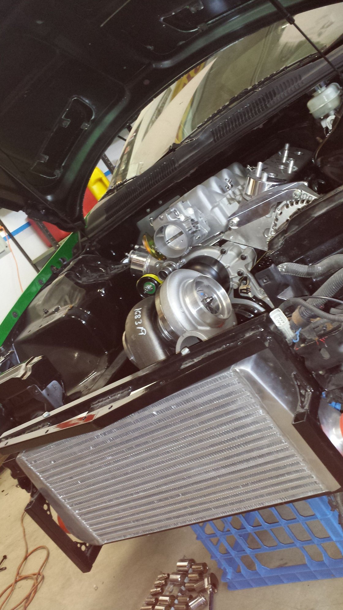

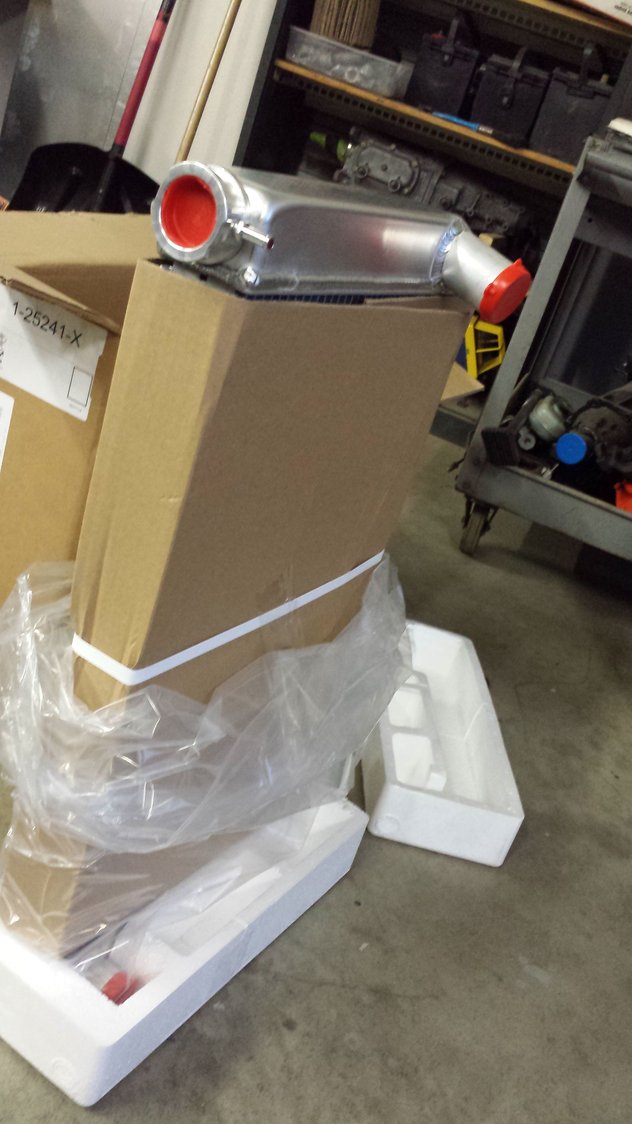

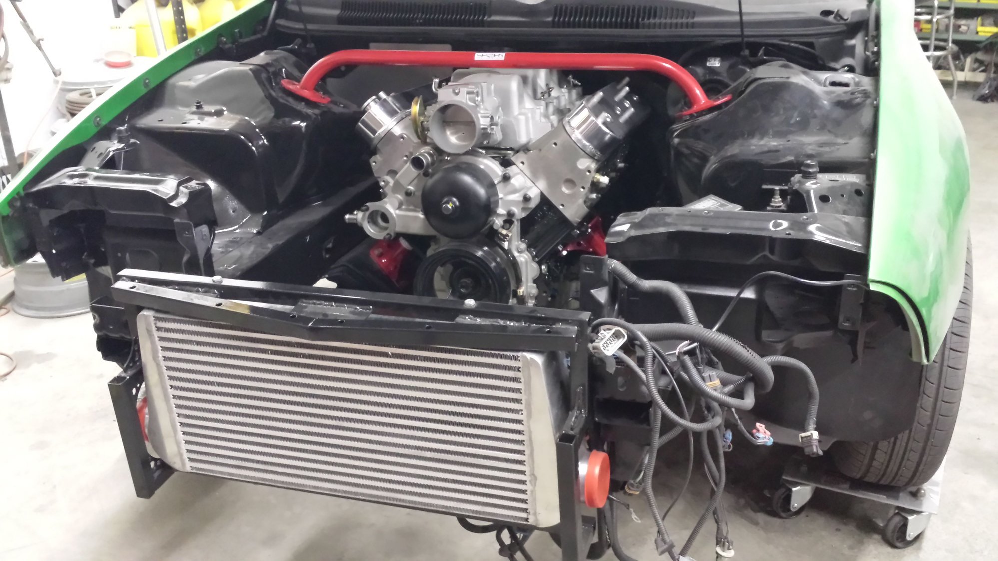

cx racing intercooler
griffin universal radiator

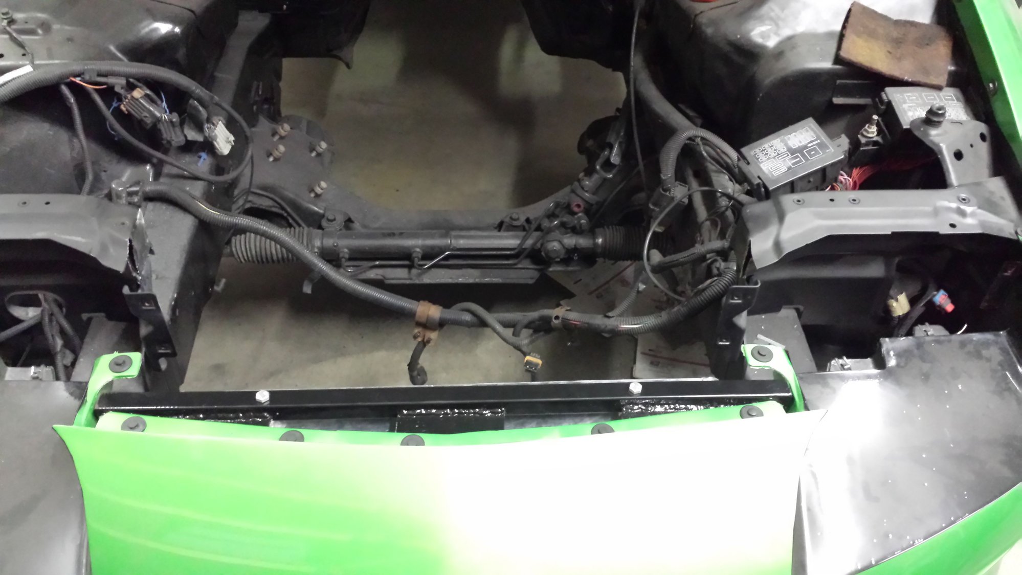

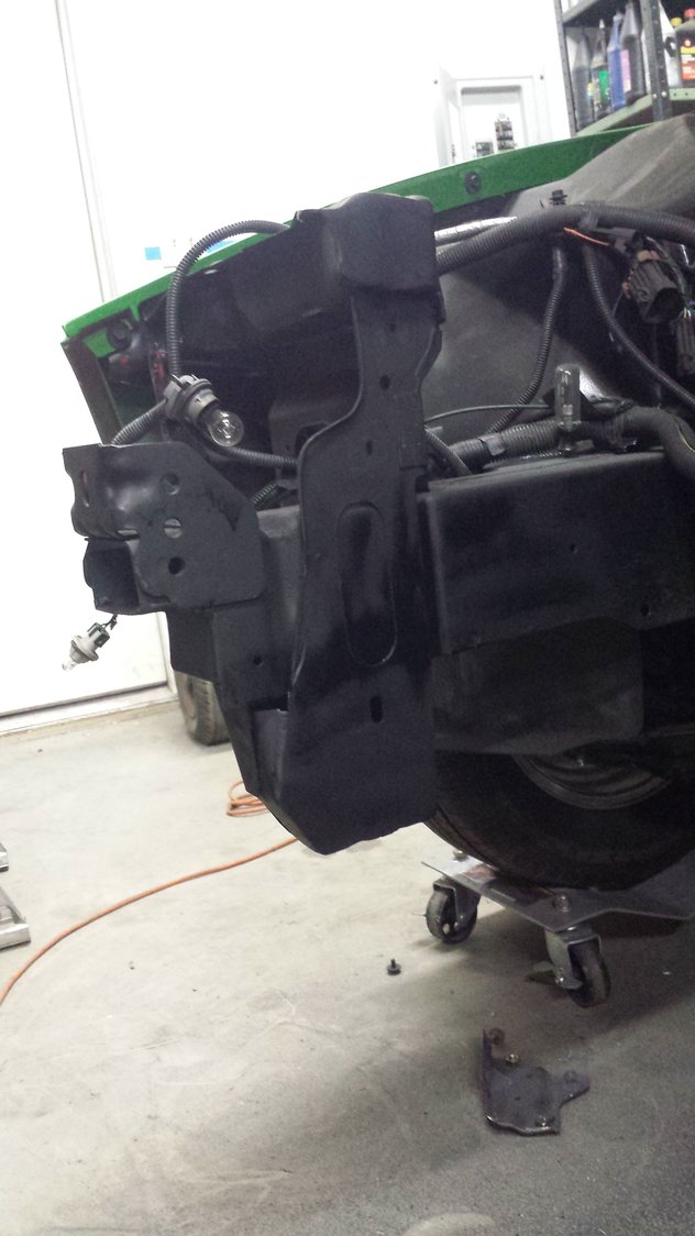

decided who needs a rad support, racecar lol. Here you can see the very end of our box front holding the bumper on.
box bumper/ intercooler mount done!
heres the completed front before powdercaoting

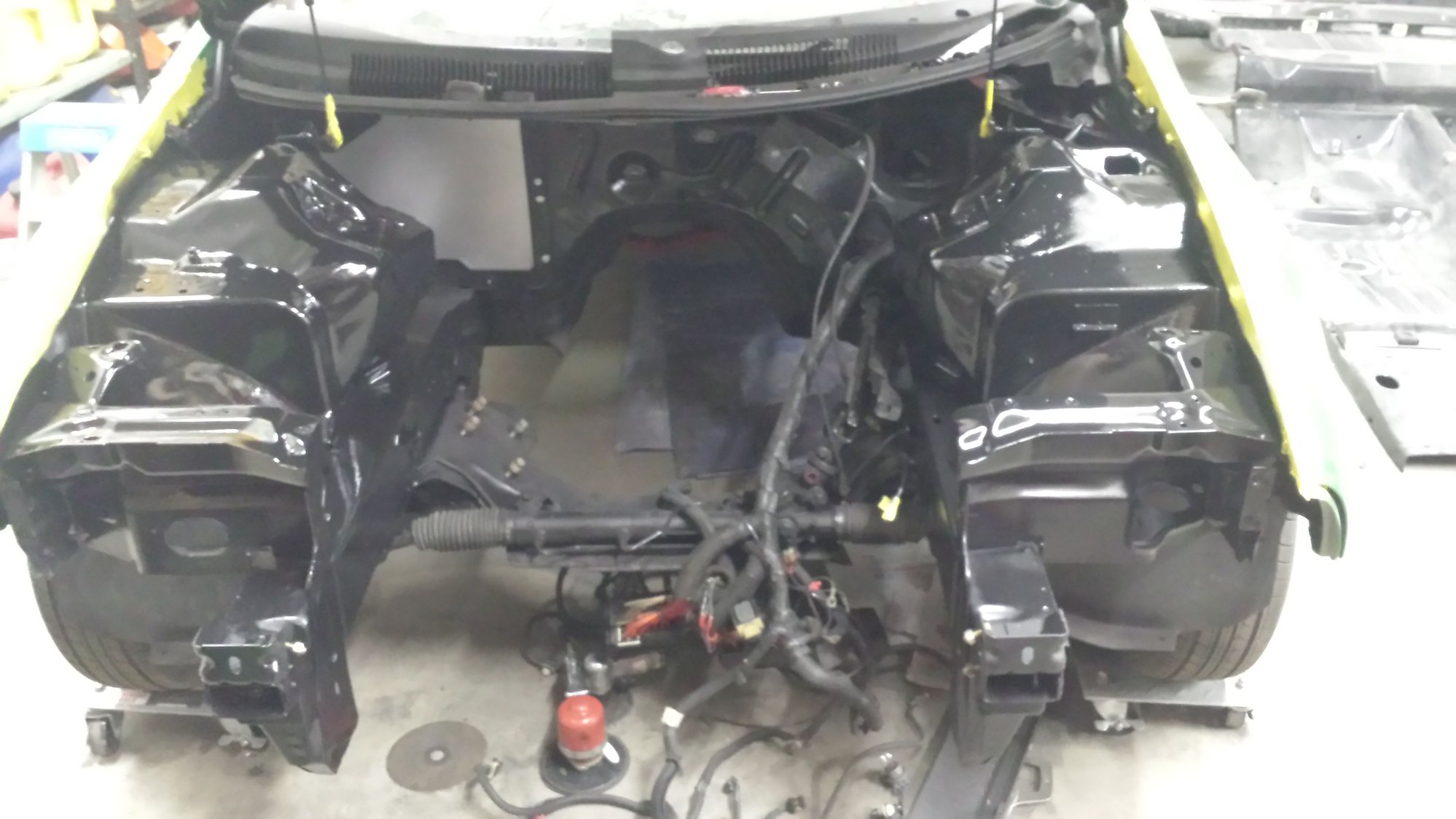

boxed in everything where material had to be removed including notching the rails and plating them.
bay painted gloss black
looking a little more completed at this point .

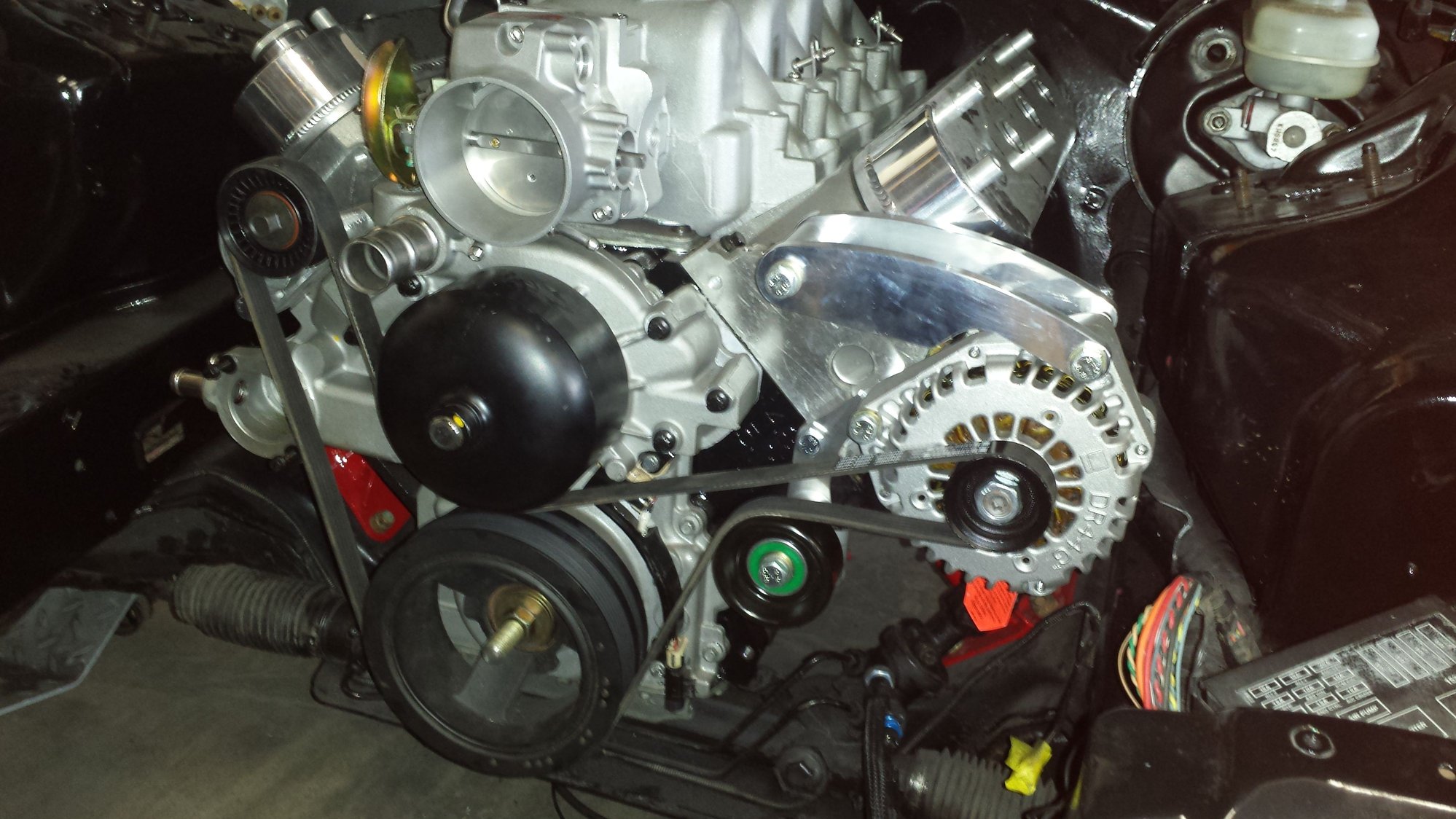

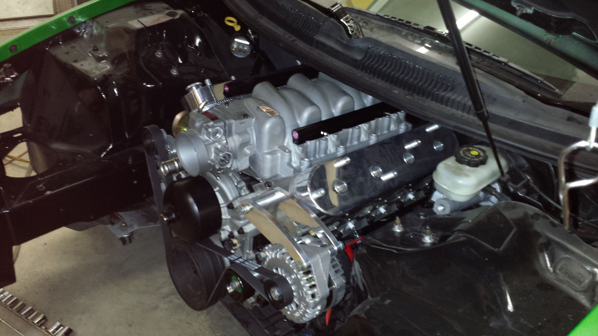

test fitting the turbo

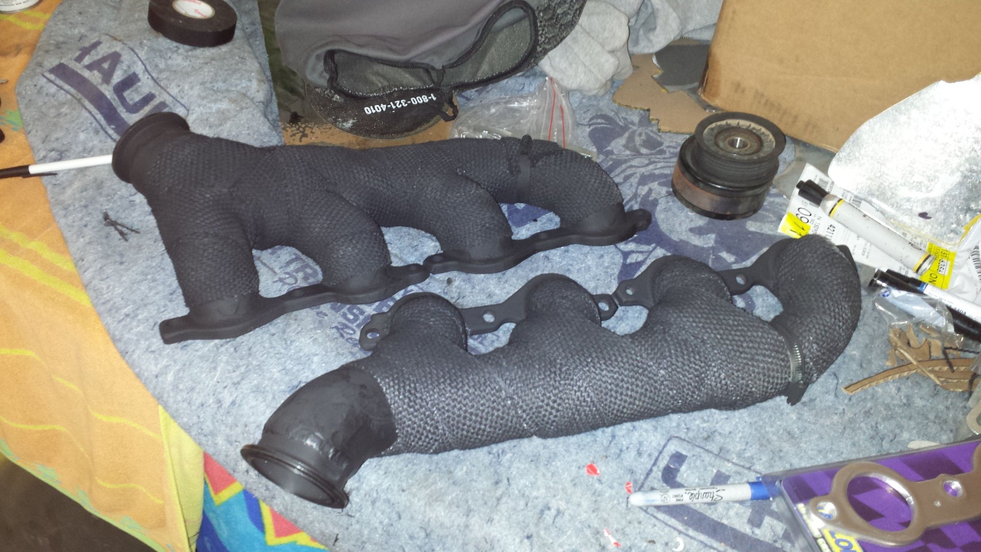

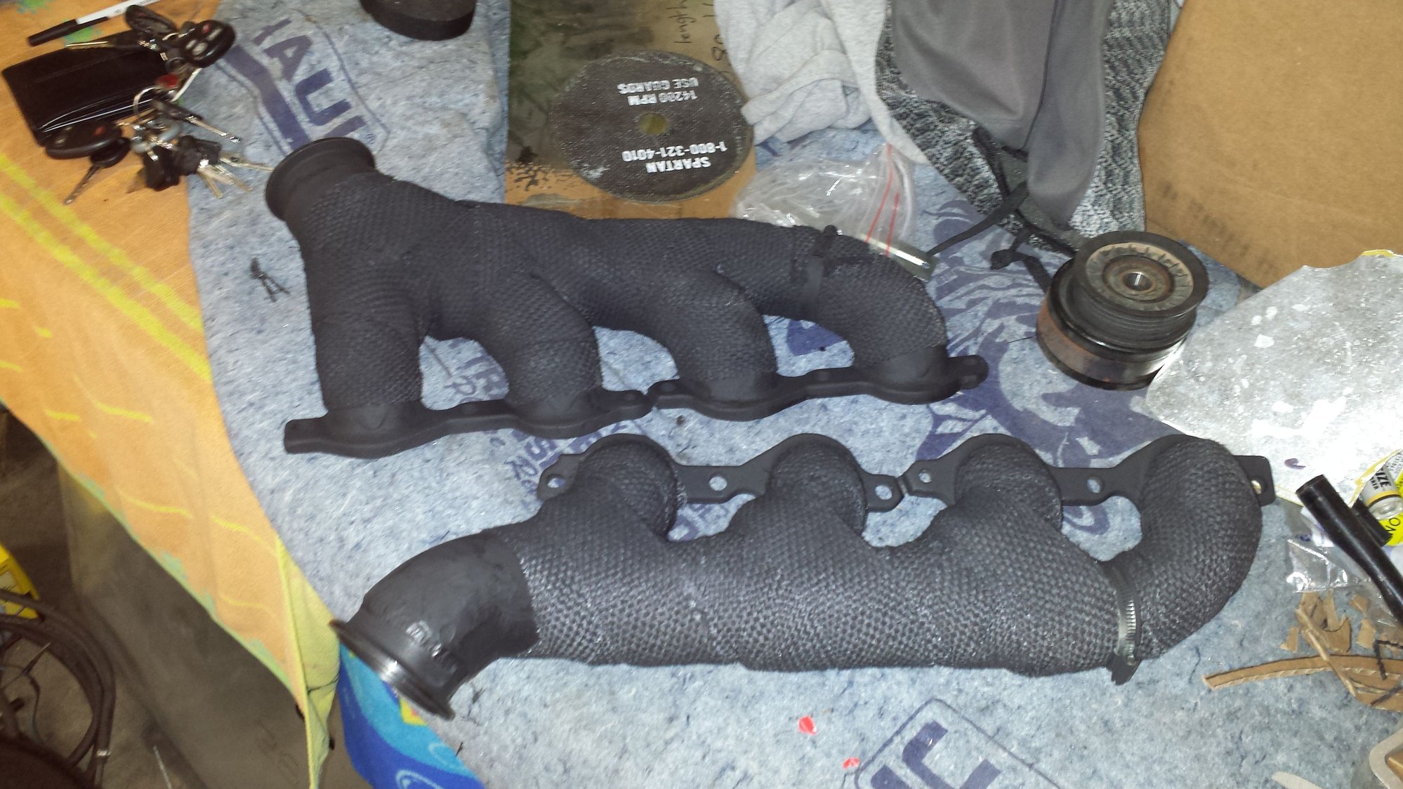

ceramic coated, wrapped, and ss v bands tigged on

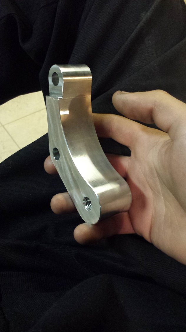

okay, so this is really the first time this info has been released. We worked closey with matt from billet speed to bring you guys what we believe is the best alternator relocation on the market. Not only can you use the truck alternator, but you can also use high rise valvecovers.
As you can see, the mount allows for plenty of water pump wrap along with tons of clearence for your flipped manifolds. If your interested in one of these, contact me or matt from billet speed to purchase one!

V band manifolds all done

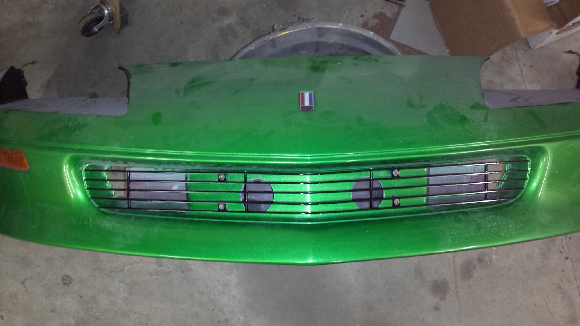

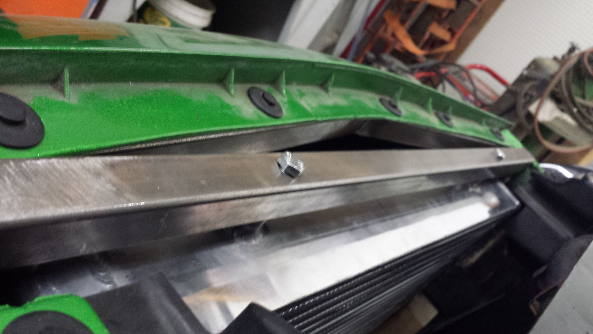

Wanted some more airflow for the intercooler so i drilled 2 2.5" holes in the bumper and installed a crappy grill overtop.
