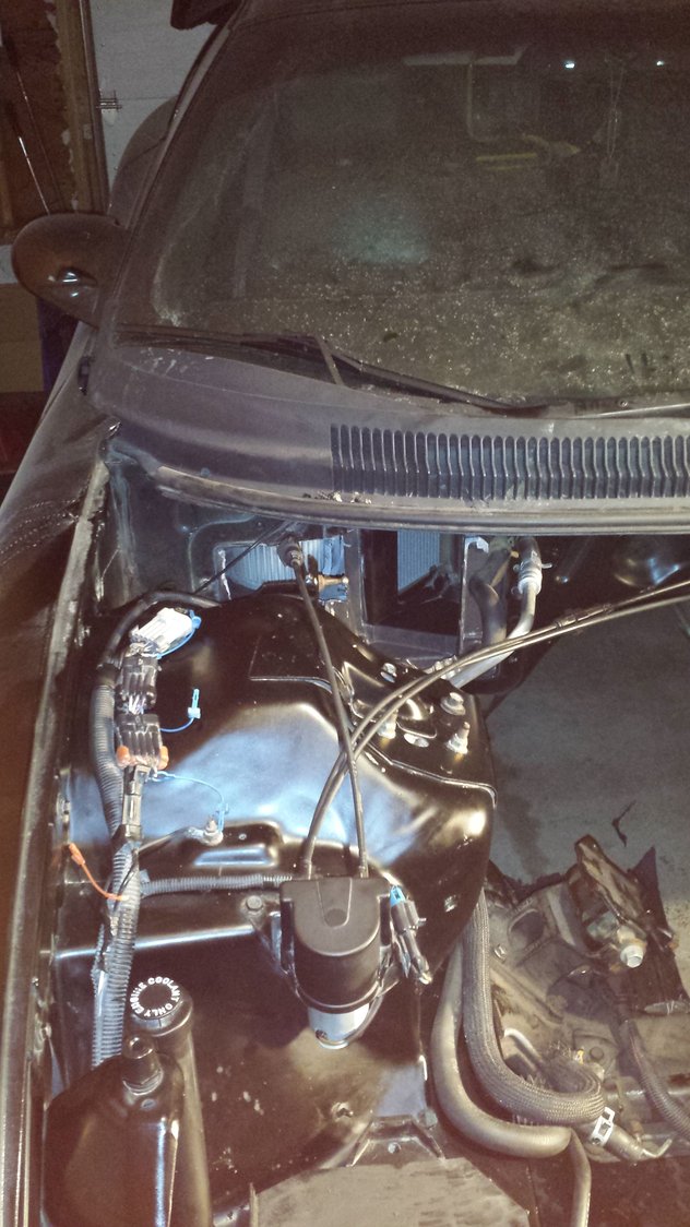

Update- ordered my momo steering wheel, weld rts wheels, fuel system, hid head lights, and racing seats.
Right now trying to figure out if I can use a set of 317 heads I have or to buy Prc 225cc. Like I've said before where I can save money now and upgrade later would be nice. Ac delete almost done
