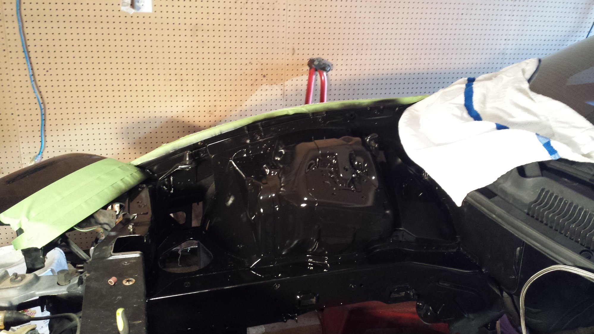

Cut the core support underneath and notched it to for the radiator cap. Made little brackets out of the core support to hold the bottom of the radiator. Top fits underneath a lip I left on core support. Rough placement, I will take pics of it done as other looks better now.
2 Derale 16925 fans like a lot of people run.
Painting engine bay since almost that far anyways, why not. Unfortunately buddy that paints isn't available so used rattle cans...
347, 9.57:1, Arp head/main, ect. Hope other holds 850whp. Was told wouldn't be a problem at all.

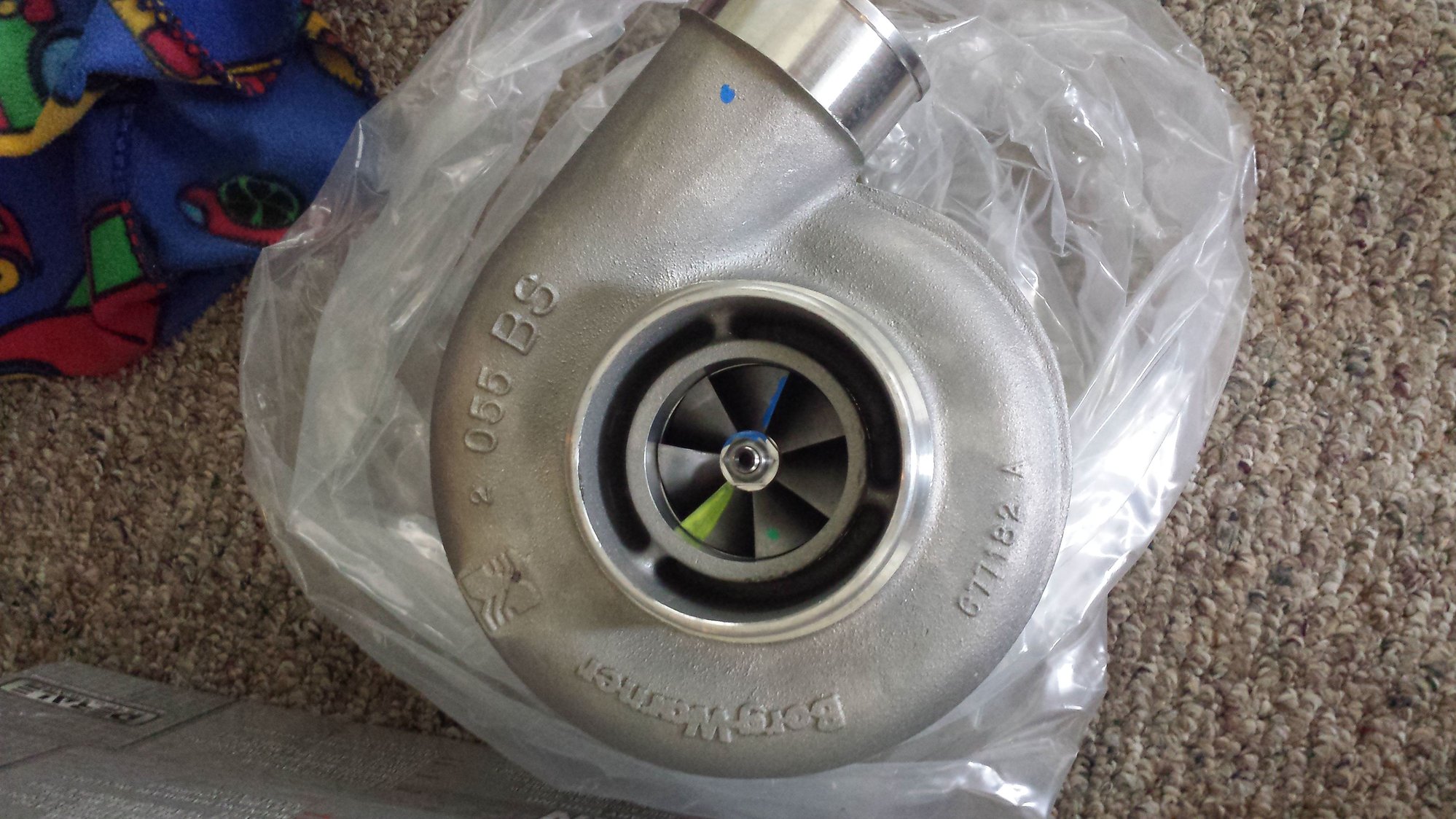

Those are the exact same turbos I have on a 6.0. They spool pretty good, heres what I wrote in another thread
I have an LQ4 with an LS9 cam, no intercooler and blow through setup with a T10 transmission (clutch). It is 91 octane gasoline. With two 60mm S300 with 68mm turbine and .91 ar turbine housing, in top gear the log shows boost under the carb as
3lbs at 3000 25* timing 11.0 afr
5lbs at 3350 22* timing 11.0 afr
Originally Posted by BC178
60/68 .91 ar twin scroll ett<br/>Kinda worried about the spool on these, seem big to me. Got them from forced inductions and this is what he suggested so guessing I'll be alright..??

Even though it probably doesn't matter, you can get the .88 open housing off eBay for $120 shipped for both total. It just annoyed me a little being split for no reason.

Good to know man, can't find any info from people on them. He did tell me with the twin scroll it is more like having . 83ar which helps out a little. I'm only on a 347. Planning 20# give or take. 900whp or so. Just a weekend cruiser that I want to be able to hit 9's on track day.

I havent dynoed this setup yet, before this I had a single PT7675 and these pull better up top, I guess more turbine helps.

How about the spool difference? My only worry was it being laggy (didn't want instant spool tho either), I gave the guy my goals and he didn't even hesitate to tell me to run these. Also said they would hit 900 easy.

Yeah you'd think the worst 60's on the planet would make 900whp on an LS1 so I wouldn't worry about that. The compressor map shows about 106# of air at 20psi and 70% efficency. These spool pretty good, they are barely behind the single PT76 on my setup, about 200rpm spool difference roughly.
