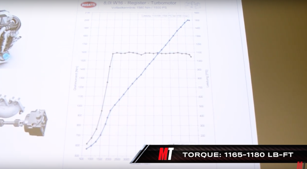

I was just on the Motor Trend youtube channel and there is a video discussing the new Bugatti Chiron. It is powered by an 8.0L W16 engine and has 4 turbos. Here are the power and torque curves...
That's what I am talking about!

That'll be VNT for ya ! and no doubt capped like that because of the drivetrain etc
