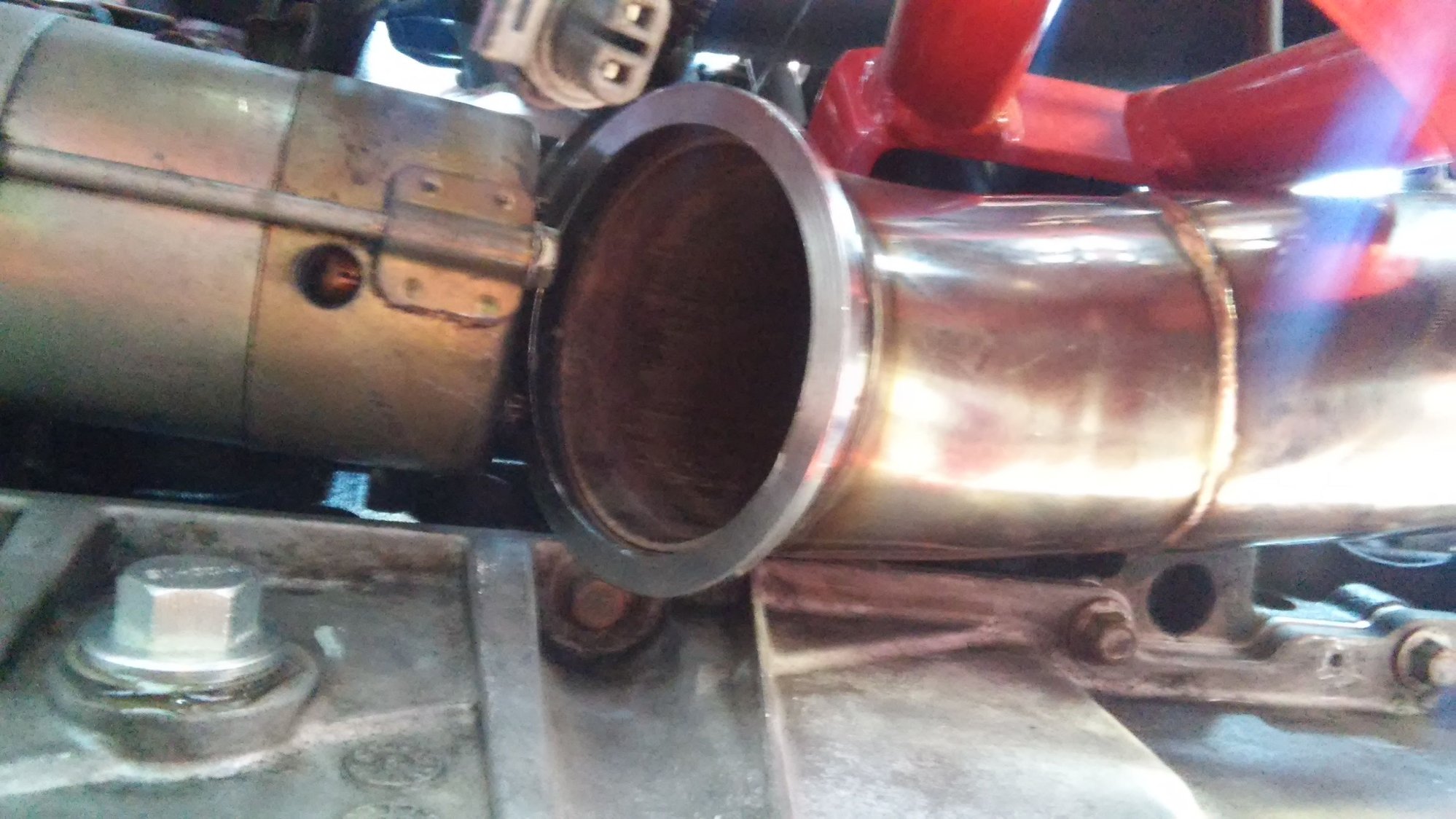

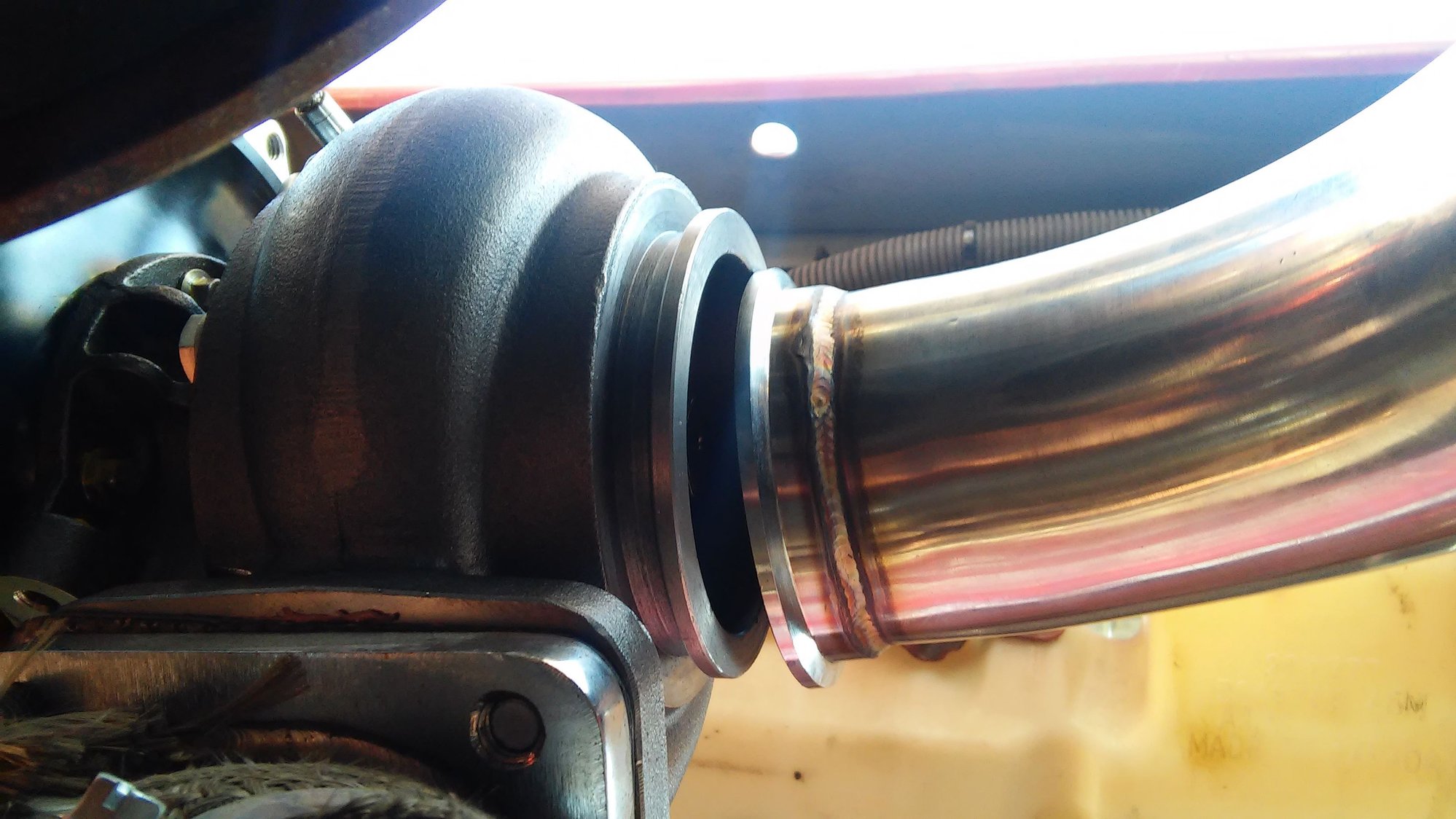

Just finishing up the turbo install but for the life of
me can make the dp work. If i get it close enough to the turbine outle theres still a gap on the v bandflanges
and the outlet is right were the starter goes. In other words i wont be able to bolt the starter. Im running a tubular k if that matters. Did i get a bad dp? Did anyone encounter this problem? Heres a few pics.

Ive searched other threads and noticed other dps end below the starter where the oil sensor
would be and this one doesnt.

What's keeping the downpipe from being rotated down?
This is about the best picture I have:
It does look a little short based off of this picture.

I had the exact same problem with my v1 downpipe. Had to end up cutting it and reweld it, to make it work.

Cant rotate it anymore because it hits the motor mount. Dp does seem shortt compared to pictures ive seen.
^ujlost The reason i ditched the magnum and went with the on3 was because that i didnt have to modify anything lol.
