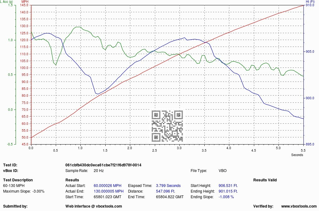

Like here is a sample of raw data. You can pick what you want to view. You can view anything though. Distance, speed, mph, lateral and longitudinal G, elevation, lat/long, ect
Then here are the type of reports you can get
Or just load your file onto the site and it will give you a report for anything.

This is great info-thanks Rotary. That data is very useful, and just want I am looking for to see if the changes I make is helping me win the traction battle.
