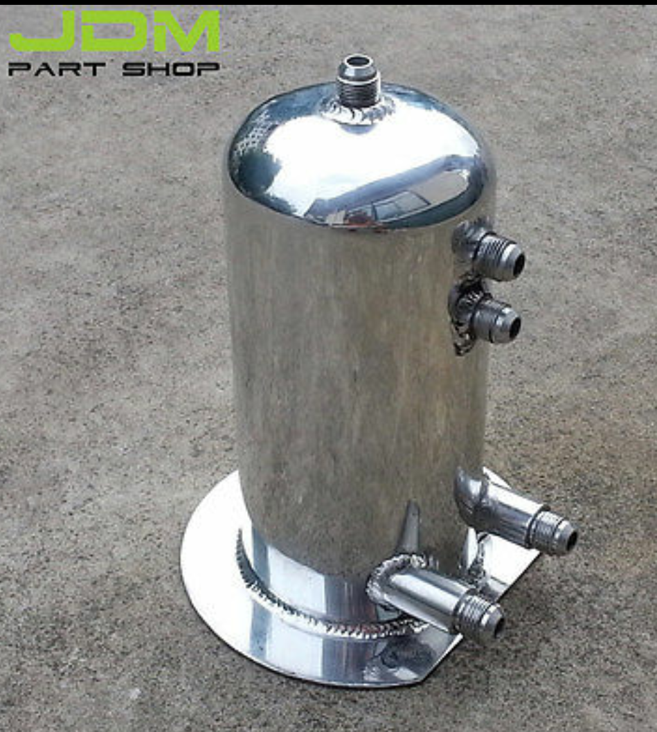

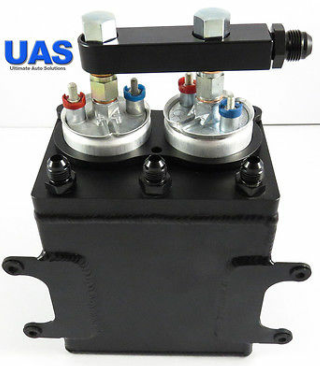

Well, i ran outta pump like you said i would. I tried some e85 and watched DC under wot and hit 100% almost instantly. So, gotta redo fuel system. since im a non oe efi car. (70 Chevelle) Im gonna add another 044 to my sumped tank or do a surge tank setup.
Like this to 2 044s......
Or this......

Or this.....
