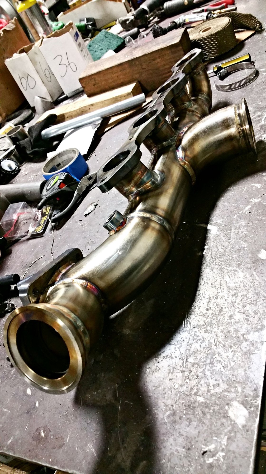

Old Oct 11, 2015 | 12:30 AM
Anti_Venom99's Avatar
Joined: Jul 2011
Posts: 115
Here is my manifold on my C5 vette.

Nismo Kid, WOW, that is beautiful! Thanks for the info on backpurging. I recently looked at how some guys have been doing that.
Anti Venom99, Do you have any other pics of the rest of your hotside? Did you run your crossover in front or back?

Old Oct 12, 2015 | 11:46 PM
Joined: Jul 2011
Posts: 115
Ran it around back.
Old Oct 13, 2015 | 08:30 PM
rpturbo's Avatar
iTrader: (47)
Joined: Nov 2008
Posts: 2,424
Likes: 229
From: A-Town, Ill side
Looks amazing! Who did you source your stainless from? I have seen Ace race parts, but that is about it.
