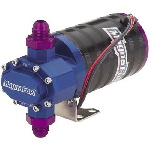

That said, you'd need to look into mechanical pumps or something like the 4103 magnafuel for a truly compatible pump IMO.
