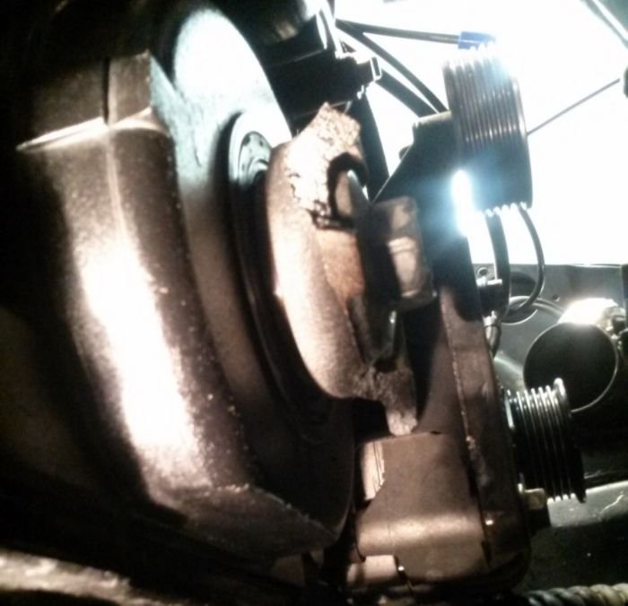

I will post a picture - the pin does stick out of the crank snout and is flush with the deepest edge of the balancer - so perhaps when torqueing the one side is retained by the pin while the other side goes in slightly to cause it to run out?
It is the front mount pin.
Old Dec 2, 2015 | 07:54 AM
tiffer's Avatar
Joined: Nov 2009
Posts: 17
Here is a picture - the pin is kinda flush but is in tight.

Looks like one of the three ''spokes'' of the balancer is cracked.
Old Dec 2, 2015 | 09:48 AM
tiffer's Avatar
Joined: Nov 2009
Posts: 17
I noticed that - will investigate - would have never seen that without my phone flash!
