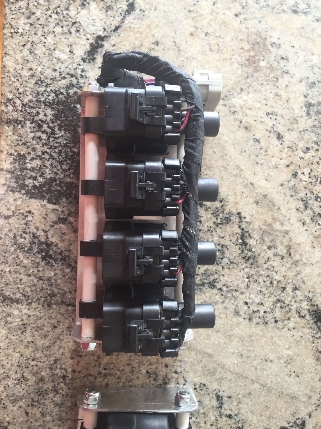

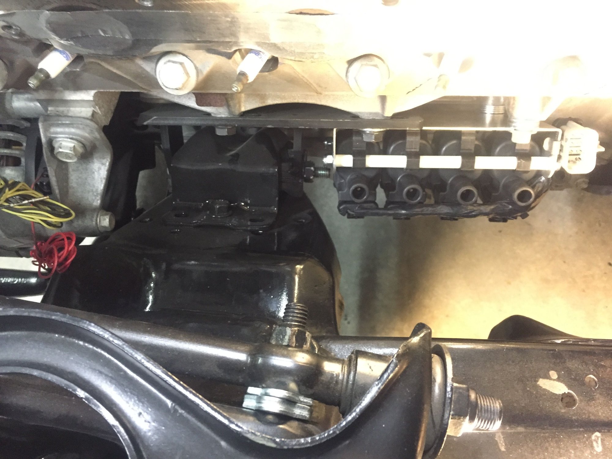

Just made these over the weekend. Not bad, folded a 3-1/2 piece of Al into a U shape and then inserted threaded rod with PVC spacers.
Had to make spark plug wires to. . Started with a set of LT1 wires and cut them to the desired length.
I also spent a considerable amount of time building the coil to PCM/power feed wires too.
I did it because I don't like them on valve covers. The wiring took the longest.
