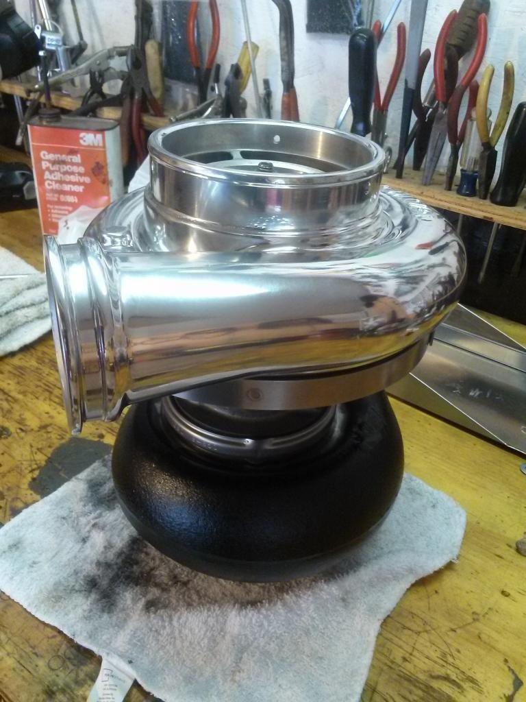

I used cerakote on mine. No results yet but as a person in the coatings industry I can say it sprayed very well and leaves a very nice hard and durable finish. I've banged it around and even took my map gas torch to it and no blistering or anything. I also wrapped it to help hold the heat in even more. Name:  D2BAF9EE-0593-4E87-8DCA-C08226002268_zpsxlhmn6ef.jpg

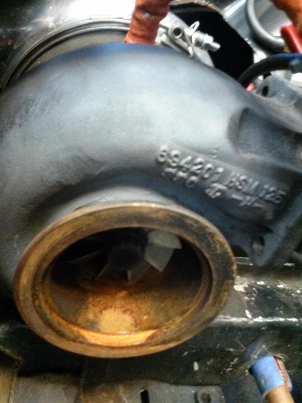

I’m not sure whats in the rustoleum BBQ grill paint but it plain works. I’ve used several spray on coatings like VHT and none of them hold up like the BBQ grill paint. It greys a bit, but keeps the metal coated and free of rust. I literally ran my turbo buick manifolds 6+ years on the stuff and never had any finish issues. I use it on all my turbo hotsides as well. They have flat black and ultra which is more of a satin finish. I usually spray and then wrap my mild steel hotsides. Then spray it again.
I do exactly this as well!

Using SS safety wire to secure the heat wrap also works really well compared to those SS zip tie thingys. (I hate those!)
Also spray it directly on the turbo housing and it does not peel or flake.
This is after a year of hard use... E85 exhaust spits out a ton of moisture. Rusted the crap out of the inside of the housing... outside is just fine.
