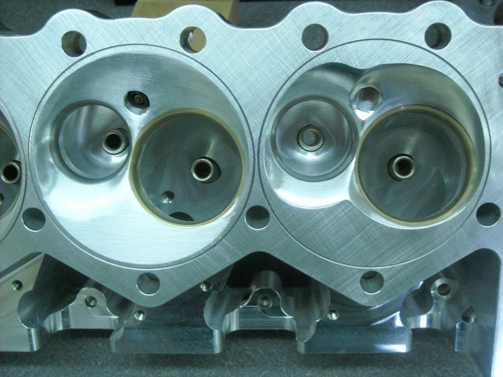

Softened CC on the left. Standard right.
So it eliminates the whole quench pad on the head? Im curious now why just running a fat intake gasket wouldnt work just as well . What am I missing?
That looks like a whole bunch of metal was taken away from the chamber on the left. The two flat areas on the RIGHT chamber are totally gone on the LEFT chamber.
Old Feb 17, 2016 | 02:12 PM
rotary1307cc's Avatar
Joined: Jan 2007
Posts: 2,790
Likes: 123
There is not alot of material gone. Just looks like it.
Ok cool.....so its just a very slight ramp downward and inward towards the center.
Totally get it now.
Thanks.

A slight ramp down to the center that opens the quench area up, just like a fat gasket . Someone who does this stuff please help me understand the difference the engine will see between no quench from a grinder and no quench from a thicker head gasket ?
Not really… it reshapes the combustion CC for a slower more controlled burn. Think old school hemi head VS new “fast burn” design heads.
You can run a thicker HG. Just run one that’s thick enough to do away with quench all together. There is a go-no-go zone for quench. As long as you are clear of the “danger zone” quench wise you’re fine.
Well great....what I always thought was the "quench area" is something different.
Where is the quench area...?
EDIT.....found it. Now I get what quench area is.....
Basically those two FLAT areas help guide the compressed air down into the center area for a more complete burn.....
