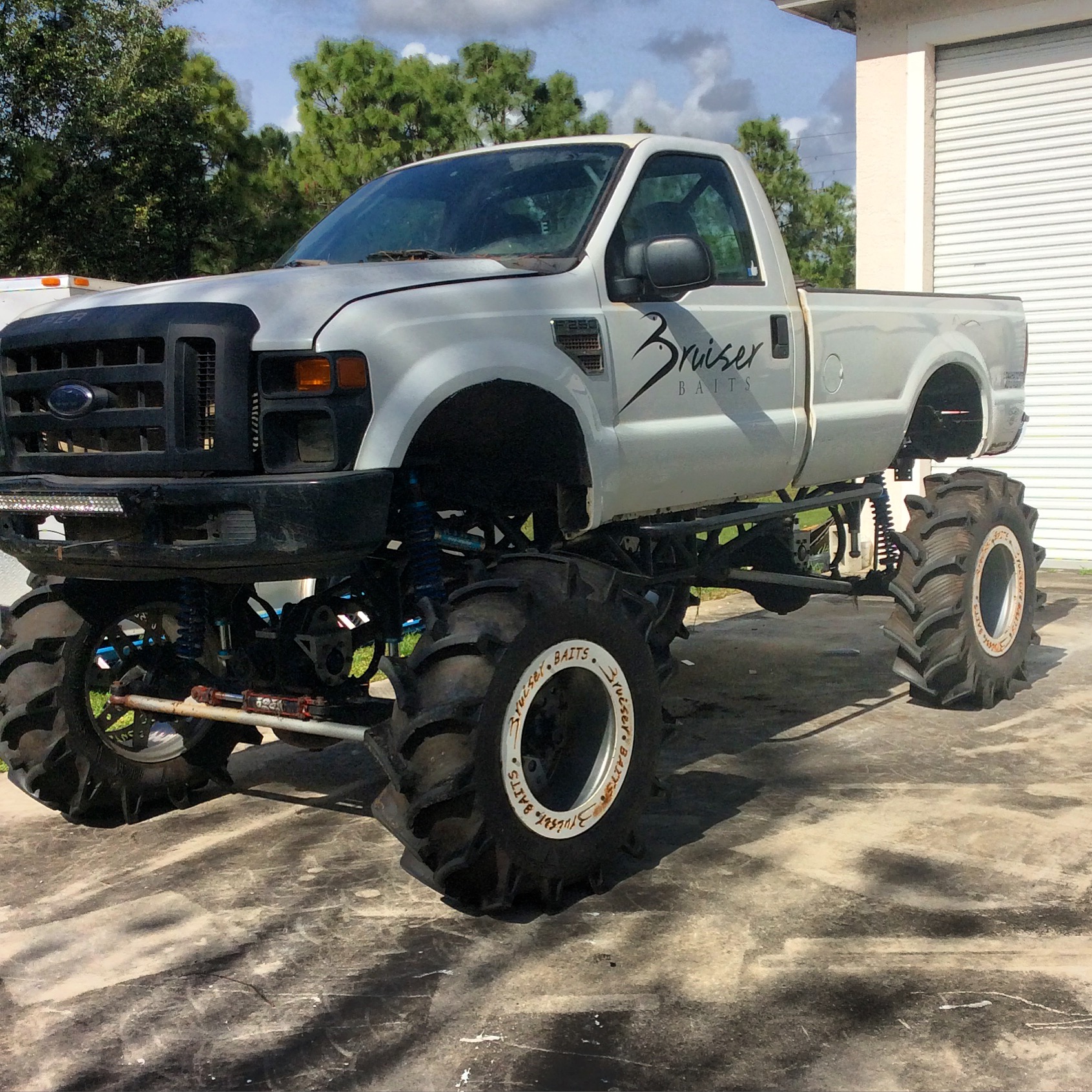

I finally got my two step going on my mud truck, and I'm so lost how to correctly tune it.
It's. 6.0 .30 over 75mm turbo running around 10-12psi with turbo 400. It's has a Holley system Have 3500 stall
Any help would be great. Where should turn on and off, just spark, spark and fuel. Also it's mud racing don't really have to go off a tree, usually just pull up and leave when ready
