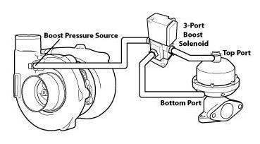

I agree, though this won't give you near as wide of a boost window without on board air. Which might not be a concern depending on boost level he wants to run.
I use a 3 port solenoid. With no power it allows all the boost to the bottom port and none to the top. As it pulses it slowly limits flow to the bottom port while allowing more air to the top. When it's 100% closed it allows no air to the bottom and 100% to the top.
With a 3 port solenoid and no on board air this will give you the largest boost window. I can run 8-25 lbs this way... Sure I can run more but haven't tried more DC at this point. You do need a small bleed hole for the top chamber when plumbed this way.
I can achieve the same results with my leash on air. control on top side
There is no possible way any controller will give the same control range as in that picture, using only boosted air to the top chamber.
Unless you're referring to an external high pressure air source via a pump or CO2.
