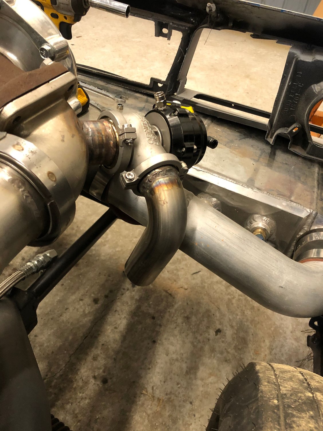

Did you ad those wastegate tubes on the turbo elbows or buy them that way? Only place I've seen sell them is with them is CX Racing.

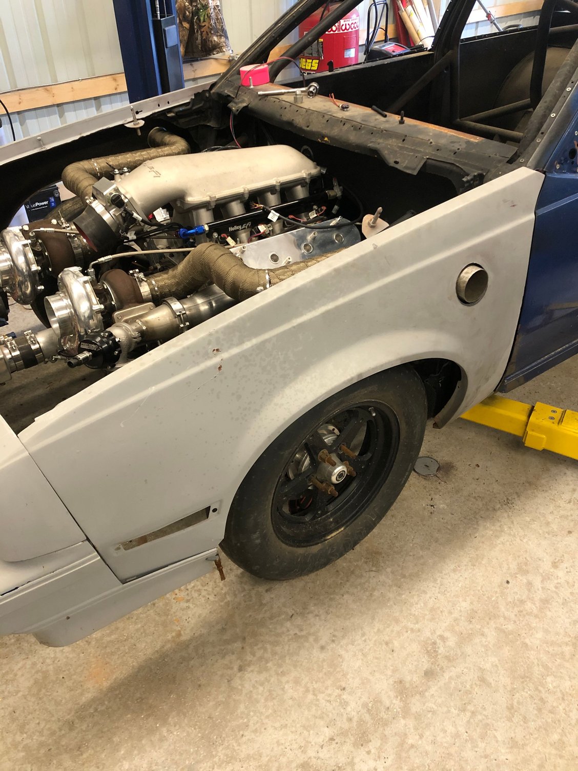

I got the elbow from CX Racing and welded the wastegate onto it with 1 3/4 SS pipe
Cool, thanks for the reply! Good luck on the rest of the build, looks good.

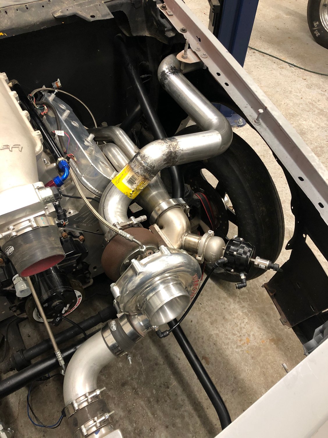

Joined: Feb 2016
Posts: 76

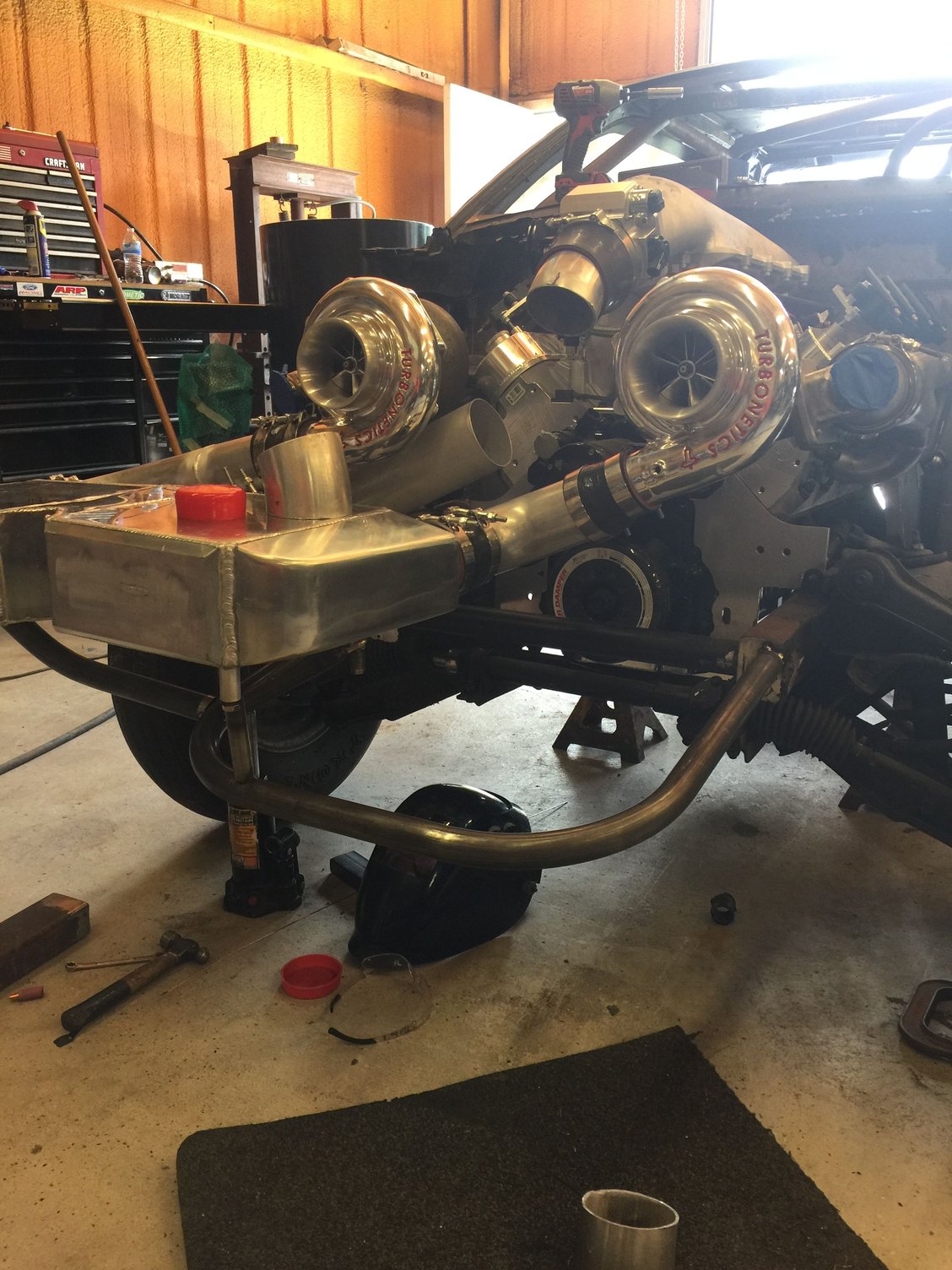

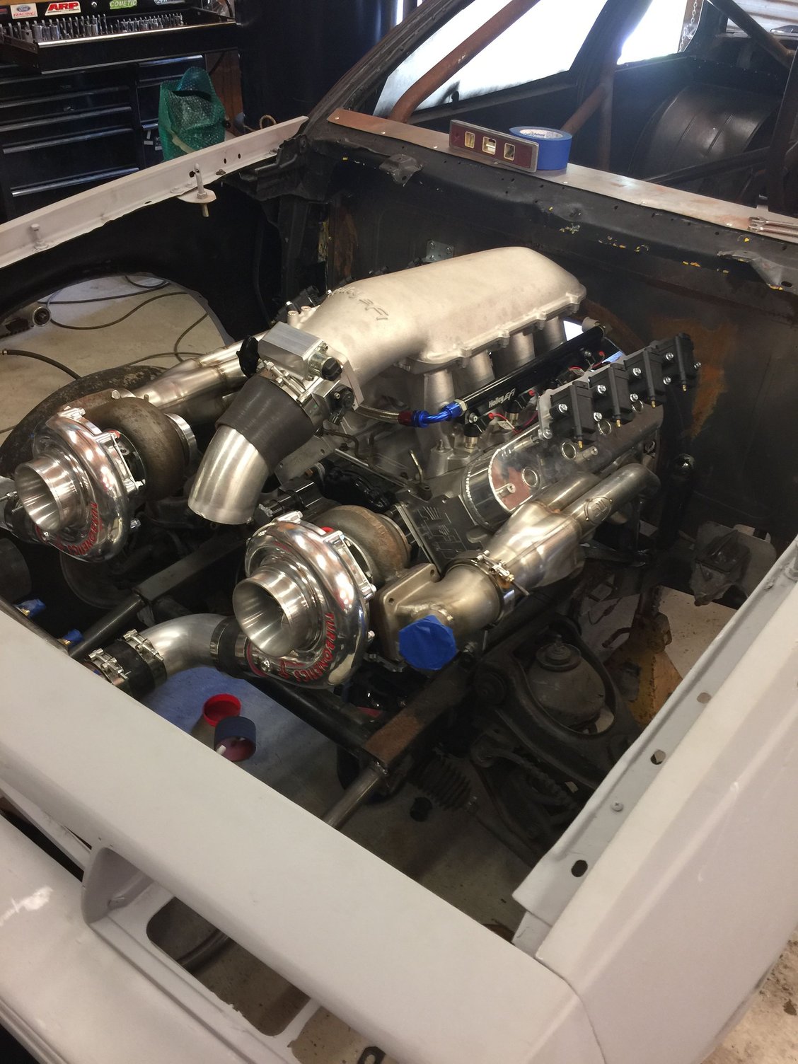

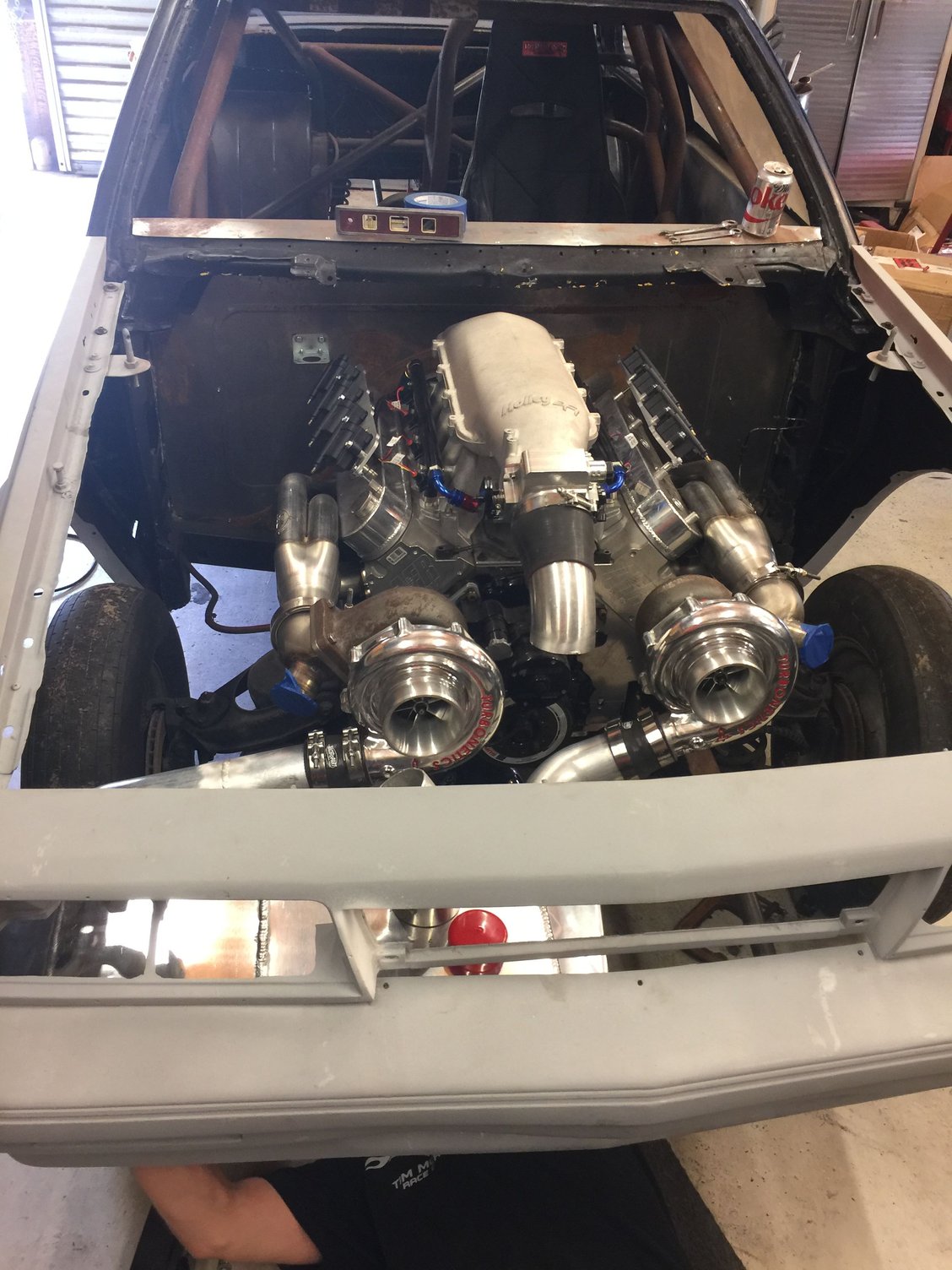

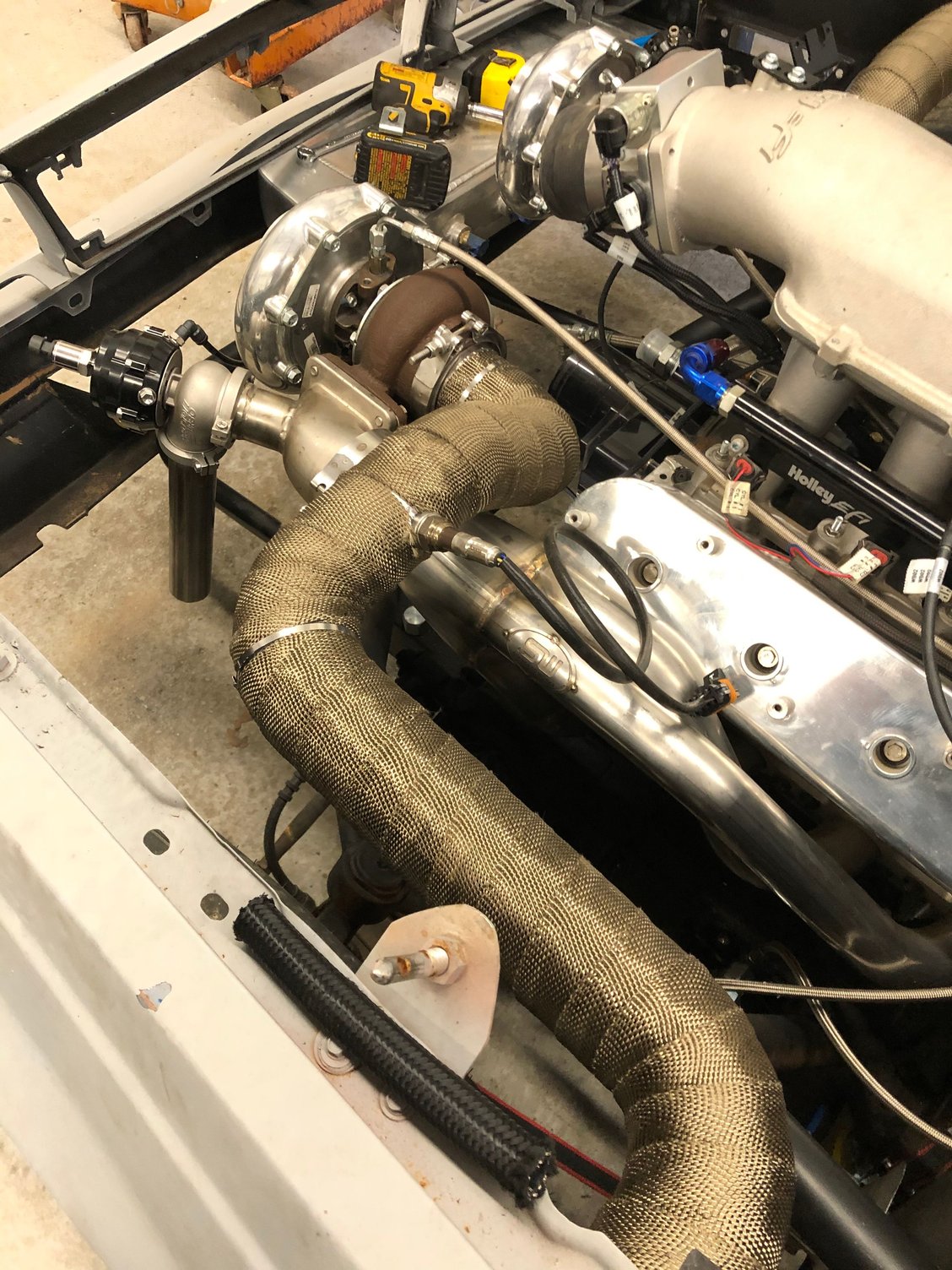

Default Exhaust complete!!
X
Turned out pretty good to say I’m an electrician! But I got some good friends thats pipe welders and pipe fitters to help me along the way!

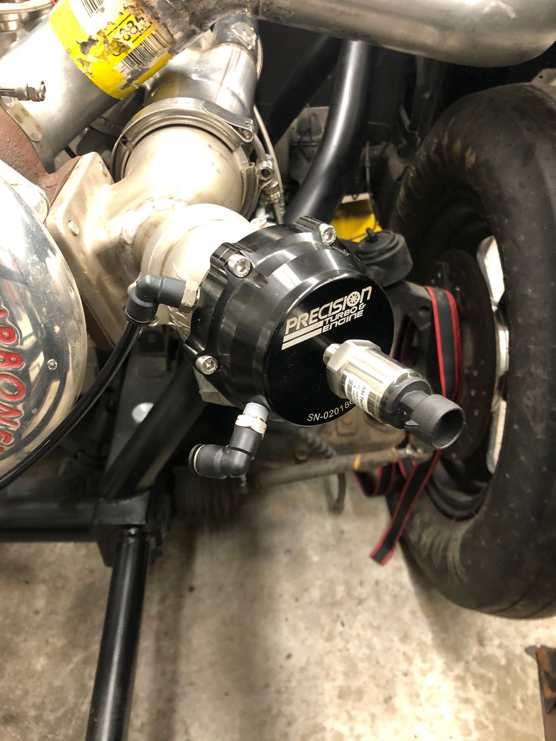

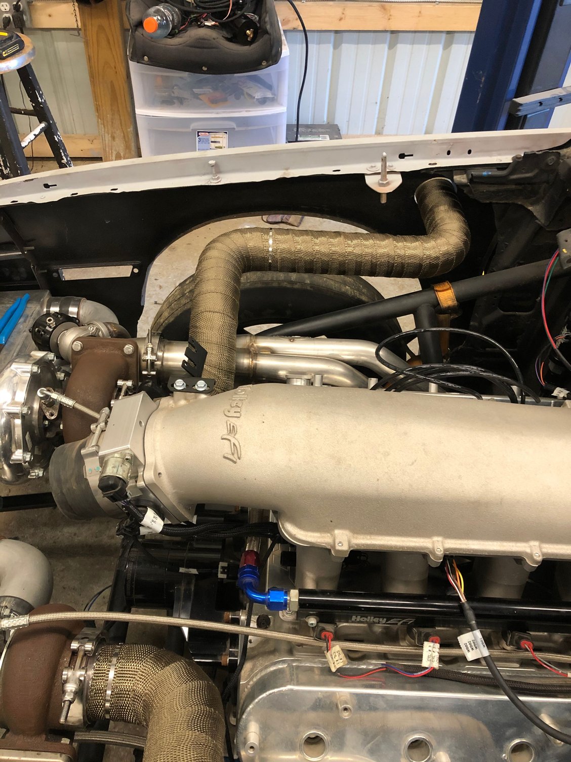

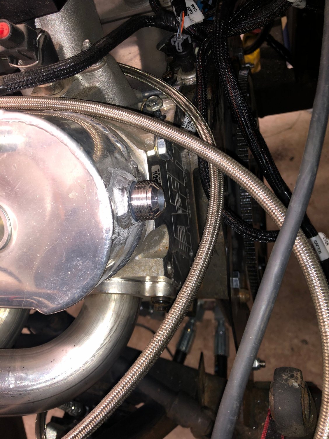

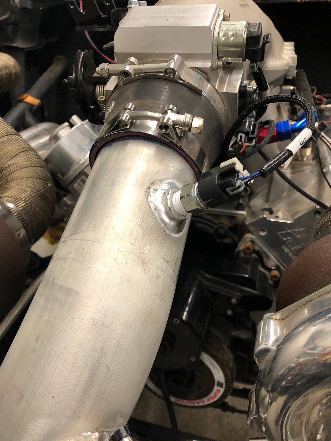

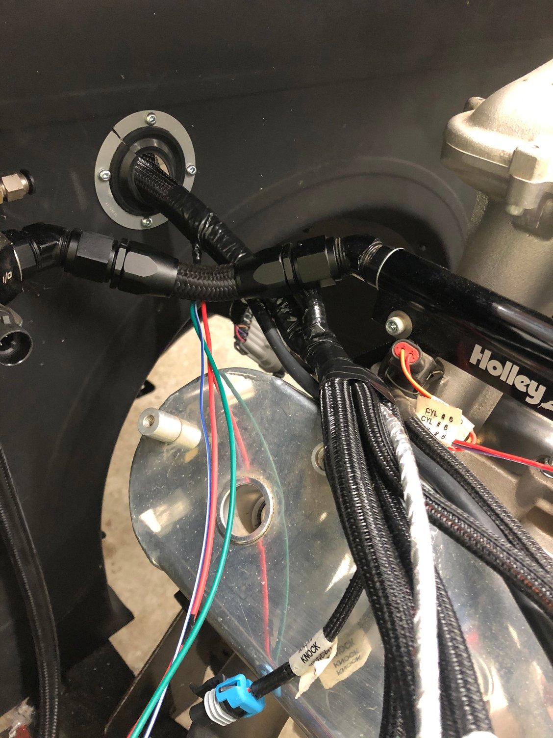

Default Finally done with welding lol
IAT bung welded in
10AN bung welded on both valve covers, goes to an aluminum catch can with a vent and drain
