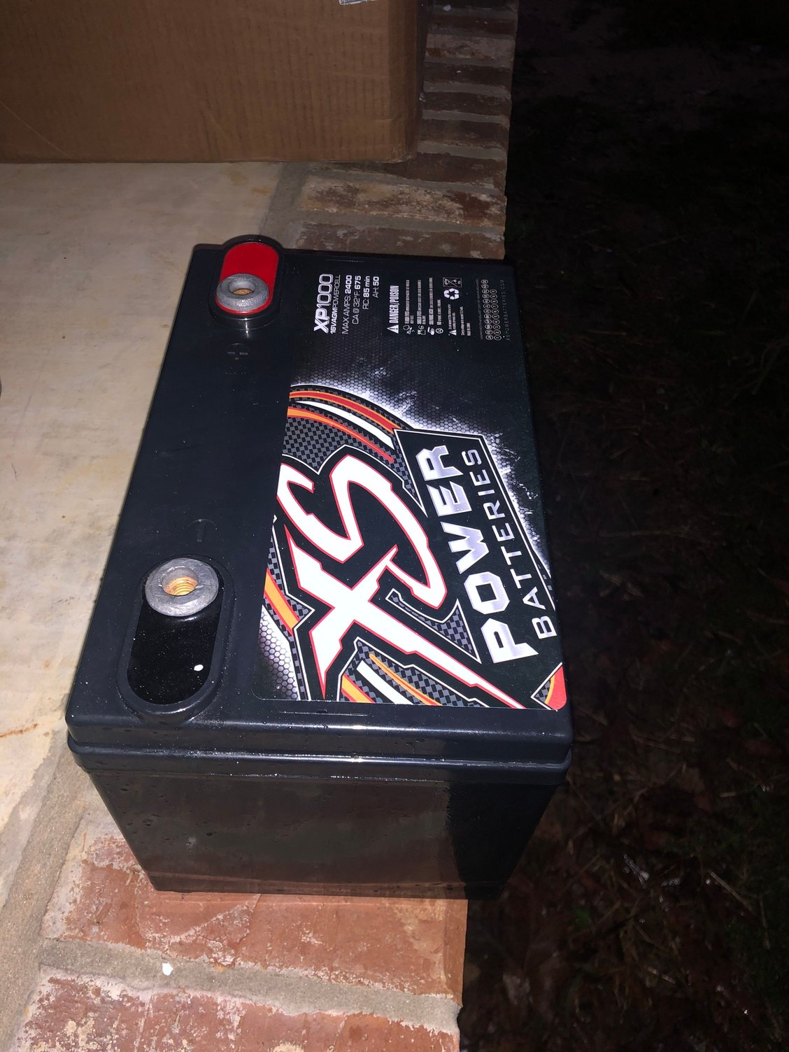

no I’m gonna run a 16v battery, it came in today
XS power xp1000

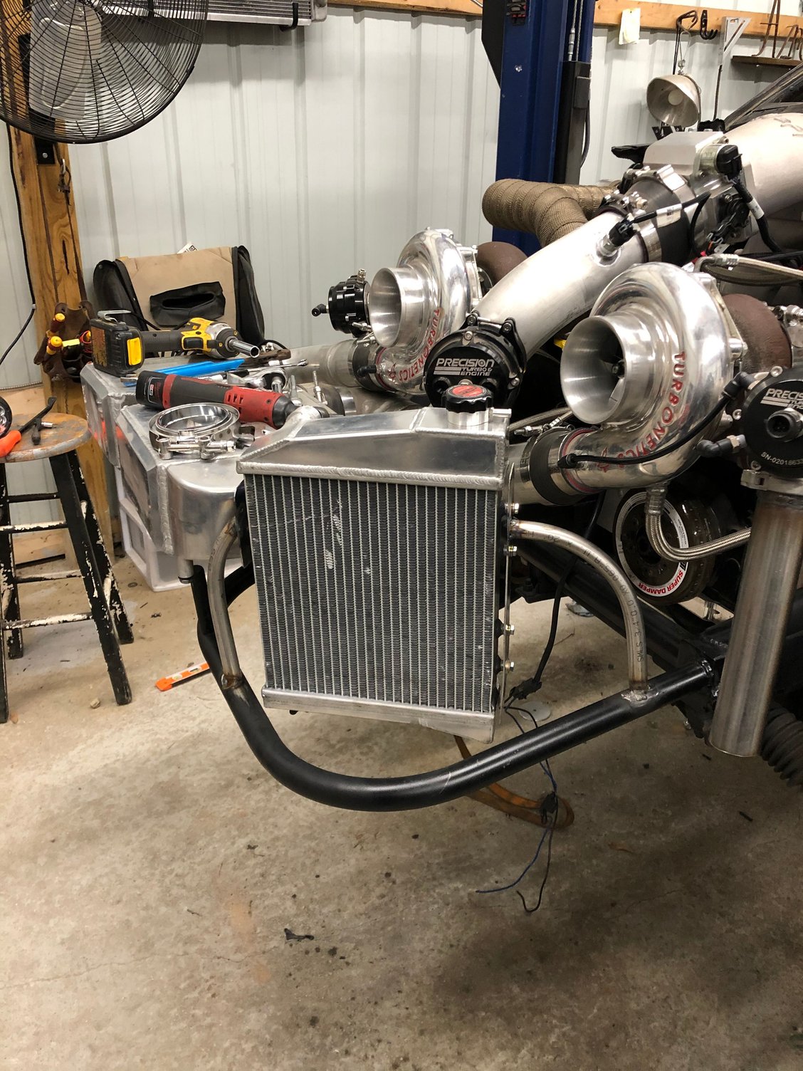

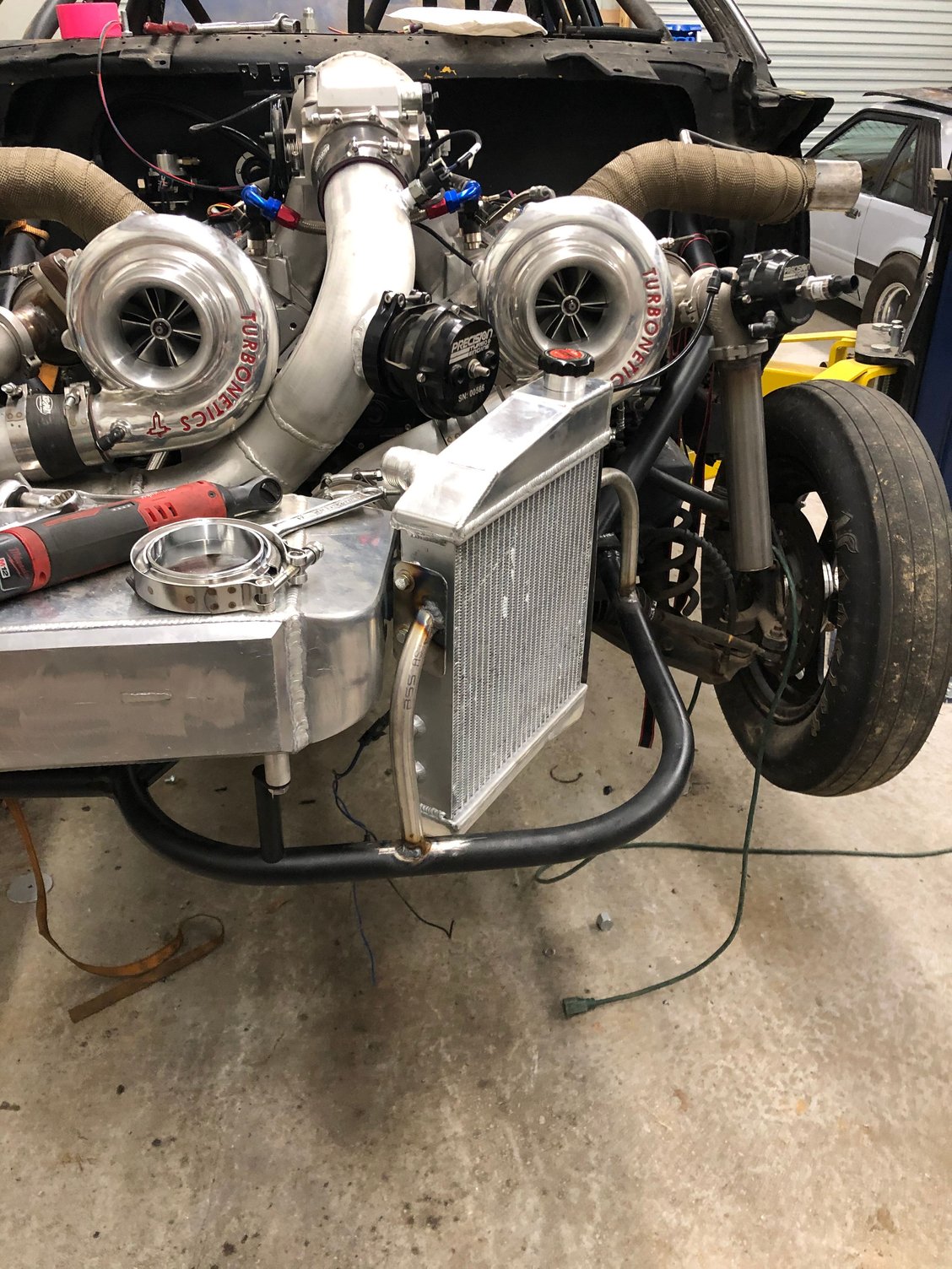

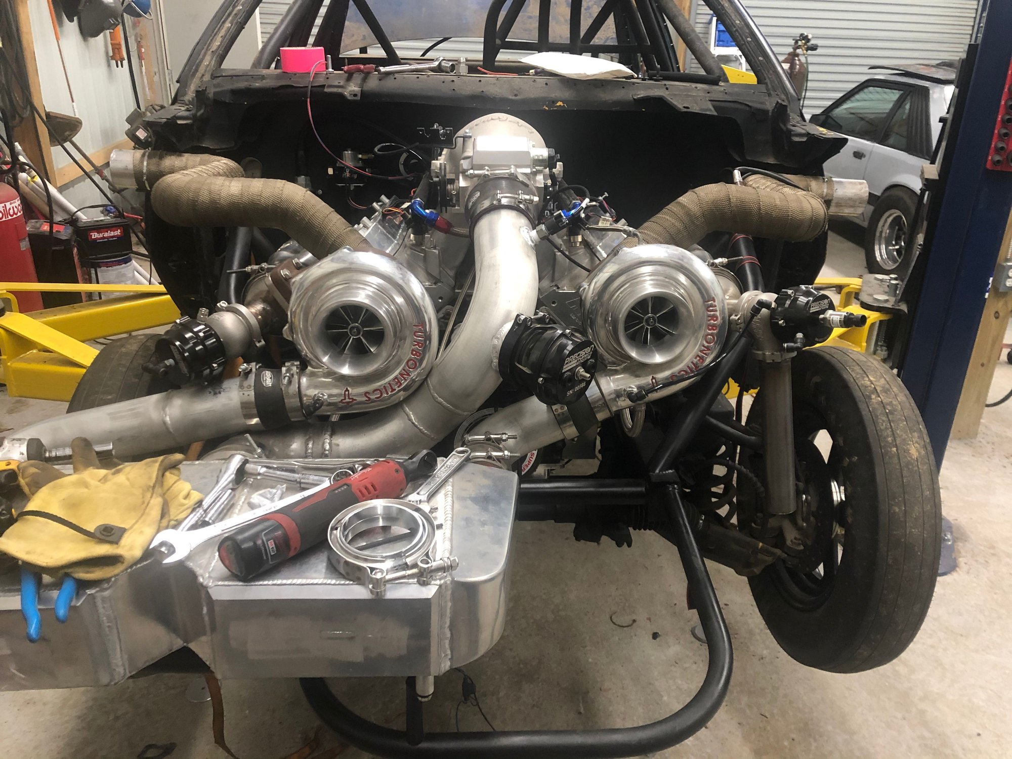

Default Radiator mounted
Old Jan 30, 2020 | 09:34 PM
  #85
Bad Apache's Avatar
Joined: Sep 2013
Posts: 994
Likes: 119
From: Mechanicsburg, PA
You know you have a racecar when the intercooler is bigger than the radiator.
Old Jan 31, 2020 | 07:30 AM
  #86
rivers09's Avatar
Joined: Feb 2016
Posts: 76
ain’t no doubt!! Lol
Old Jan 31, 2020 | 10:42 AM
  #87
svslow's Avatar
Joined: Oct 2015
Posts: 1,280
Likes: 28
From: Pittsboro, IN
Got a part number for that radiator?
Old Jan 31, 2020 | 06:43 PM
  #88
rivers09's Avatar
Joined: Feb 2016
Posts: 76
Go to eBay... search Mini Cooper radiator and you’ll see it $49.00

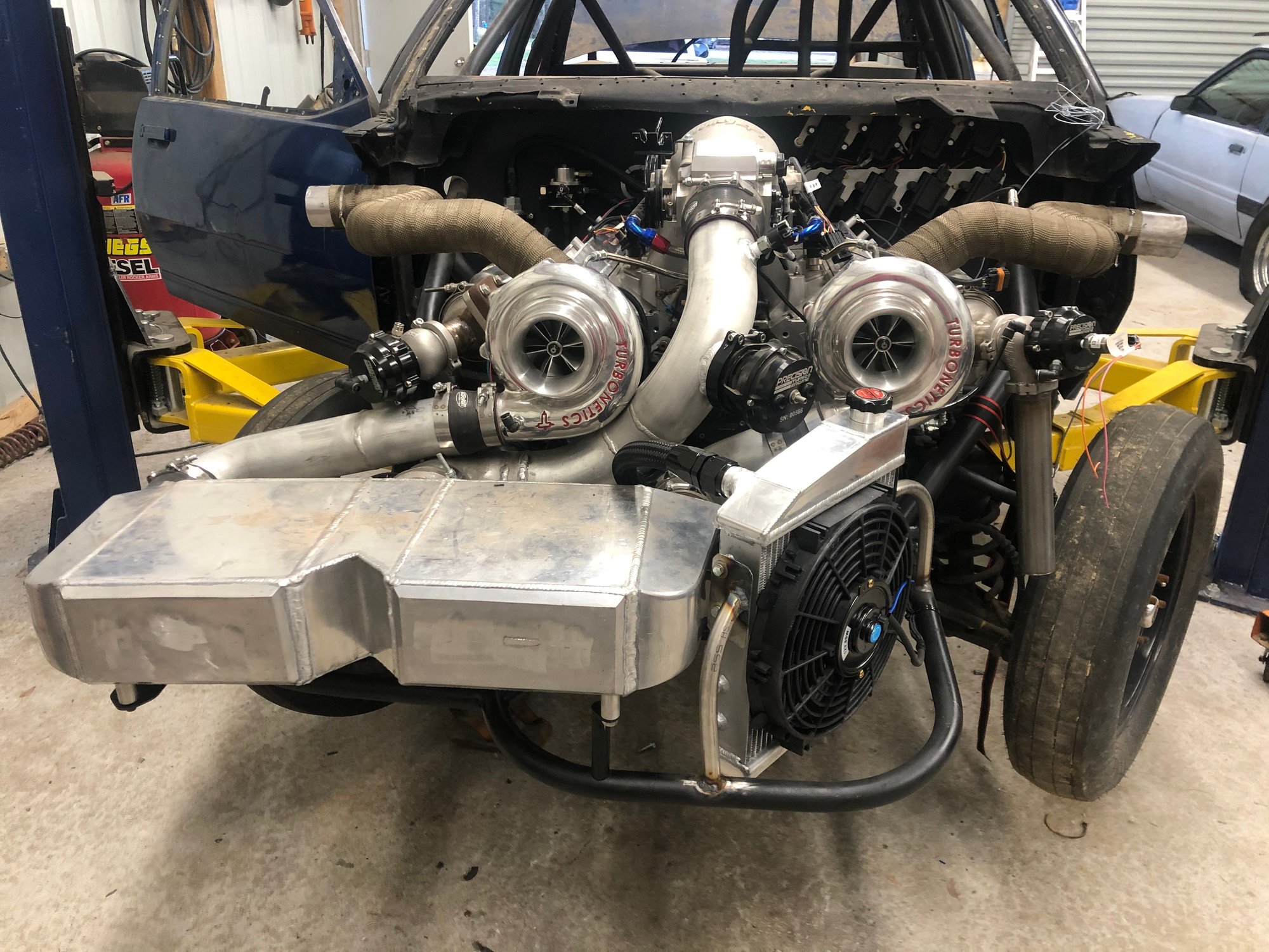

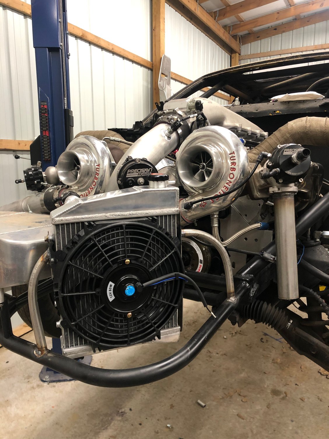

Default More progress
Got the fan mounted and wired up to relay
Picked up the fan off Amazon for $30
Managed to squeeze the radiator hoses in there!! Engine bay is definitely packed

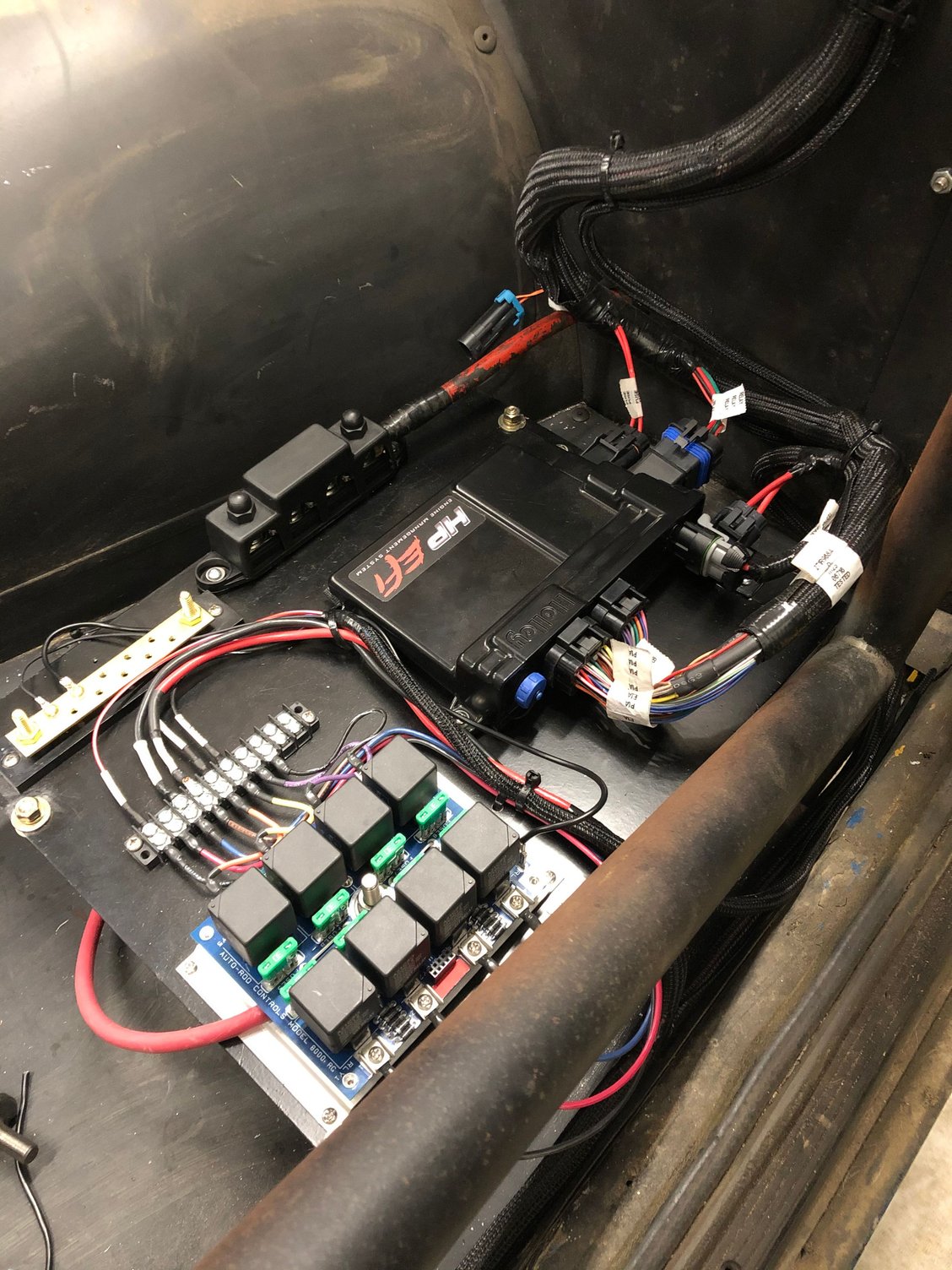

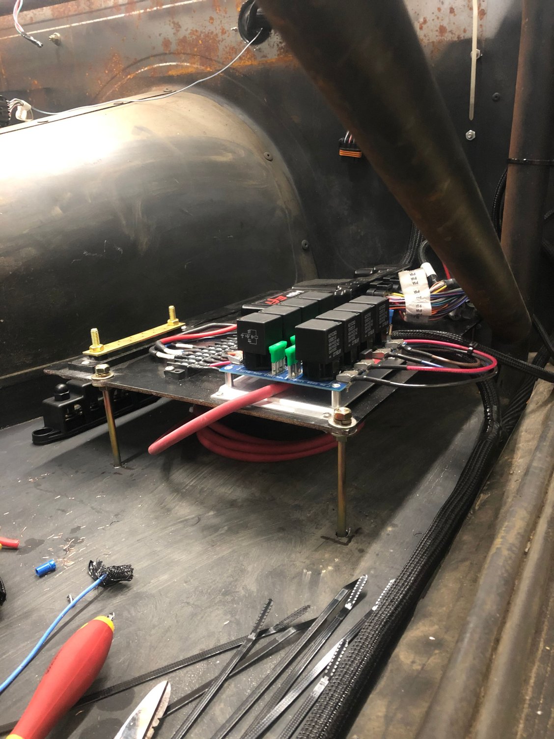

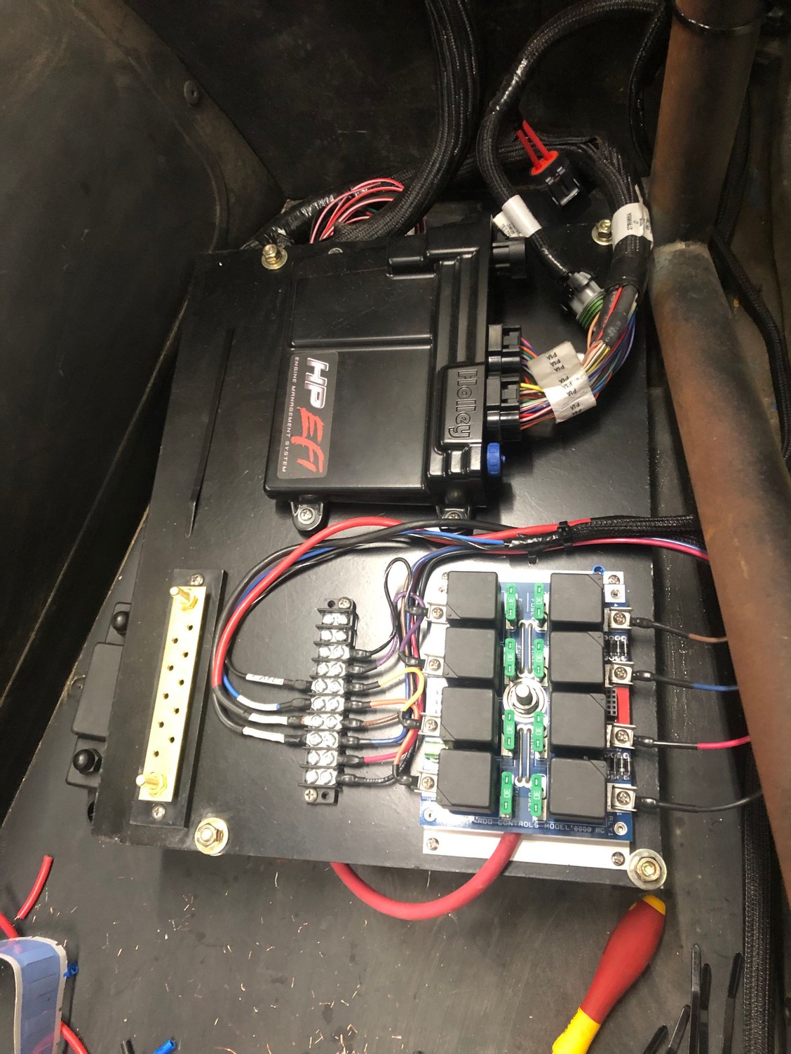

Default Let the wiring begin!
Got started on the panel today.
ARC 8000 relays
