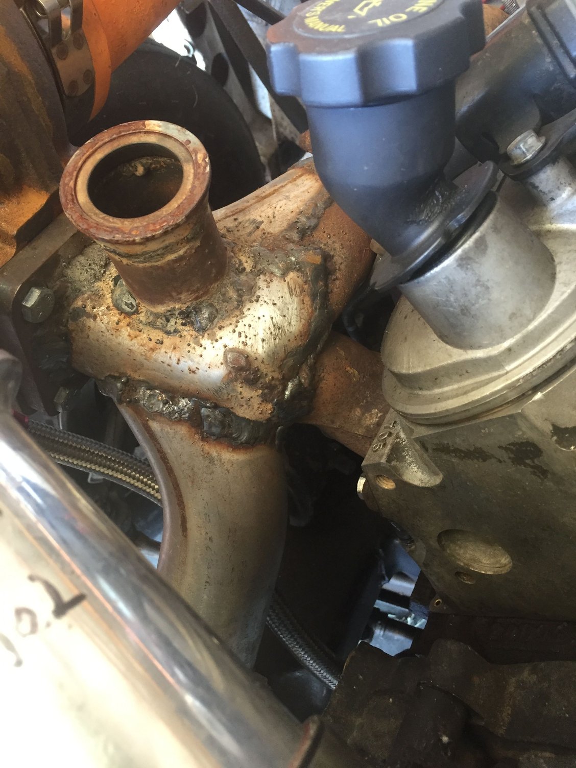

You were hitting boost cut with no wastegate? Post a pick of the hotside, the wastegate must be in a horrible spot if that's the case.

Running without a 38mm wastegate is like having a 1.5 hole in the hotside! Quite the leak.

Yes at the end of the 1/8 mile it would get to 165kpa. I will post a pic but it's really not in a bad spot.

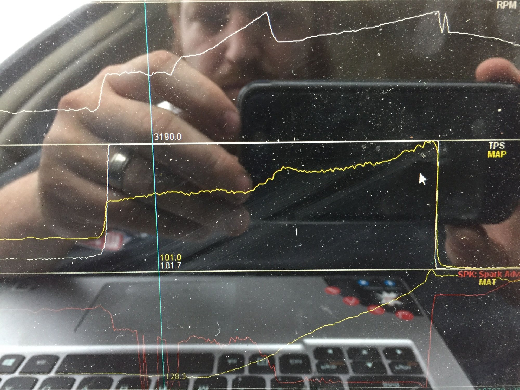

Here's a log of the lay run before it came off the transbrake it was in positive manifold pressure.

It's in a bad spot if your seeing boost with no wastegate.

9lbs and no WG is pretty crazy! Any pictures of the WG location?

You can drive a meth pump directly off of megasquirt (looks like megalog viewer in ur photo)
Makes it really easy to accurately control the system and all you need is a pump and a nozzle.

Both flows of exhaust are pointed at the waste gate.
Yes 2* of timing in boost. You can see it in the graph. I locked it out at 2* tell the truck physically went down the track. So once we got it going a to b we could start adding timing to make it mph hard figuring it would be fun to 10-20 mph all the other index cars in the class. Have a second waste gate coming.

that low of timing will cause boost creep to be worse. Its like being on antilag the entire track

That manifold rocks! Yea I'd try getting a "normal" amount of timing in there. bump that sucker up to 8* with the WG removed and see what it does.

I will bump the timing 5* and the second waste gate shipped today.
Yeah the manifold is cobbled together but it works and allows the closest placement of turbo to motor.

Sorry, didn't mean it in a negative way. I think a lot of people overstress how "perfect" a manifold/turbo kit should be. I love seeing the home built quick and dirty systems. Really shows anyone can do it with a little time and effort and it doesn't have to be pretty to work well. 500-600hp turbo small blocks can be made for peanuts these days, wish there were more of them!

No offense taken. We welded it together with a 90 amp flux core harbor freight welder and never bothered to knock the slag off.
