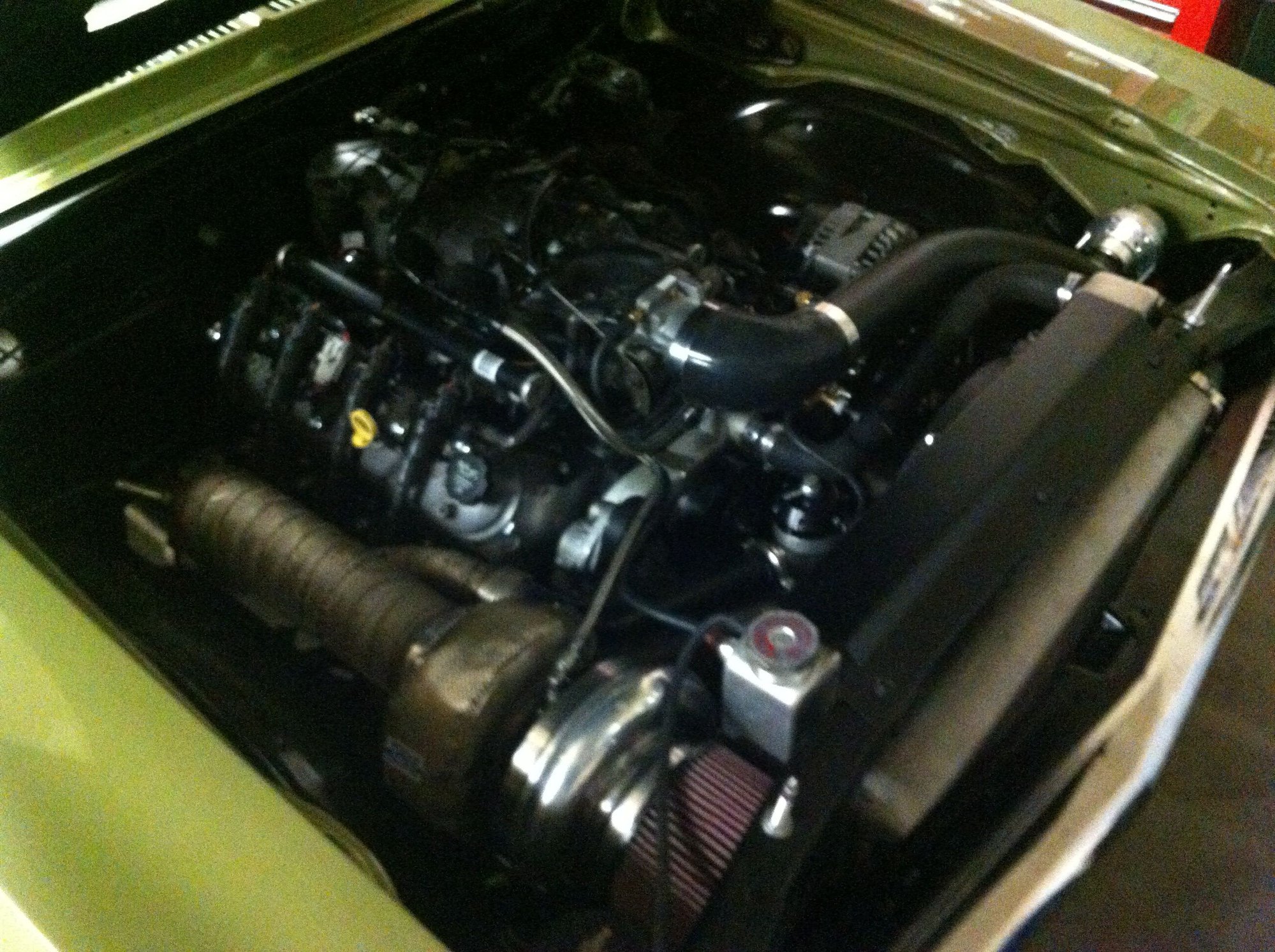

Well I finally got the Nova fired up. It hasn't been without a lot of advice an help along the way. The startup was successful, but late night, open downpipe and a couple laptop screw ups (my fault) cut the tuning session short. To those I can remember, Forcedfed86, Wicked69, RonSSnova, hellbents10, stock48, denmah, yenkomike, spray280, JoeNova, all the rest from here I can't recall, my buddies that helped I want to say thanks again! It's truly appreciated.

Cool, nice clean install

Thanks. You're definitely in my thank list also. I got the 3.5 touchscreen after talking with you. It's a pretty cool component.

looks damn good . thanks and im glad to help if I helped at all. the under hood looks very nice. and I know how hard it is to get everything to fit in a nova. ive seen your posts but what is the whole build parts wise?.

It's a '70 Nova. Engine is an SBE gen IV 5.3 (dished pistons) with 243 heads. It's got a JFR racing unicorn grind cam, 1218 springs, trunion upgrade, etc. truck intel with 80 lb injectors on truck rails. Turbo is an s475/83 t4 with a 1.25 A/R. Flipped truck manifolds with 2.25 off each side to a 2.5 inch merge into the turbo. It runs through a Treadstone intercooler with 3 inch piping. LS7 water pump with drivers side outlet. 4 inch exhaust with a Hooker Maxflo muffler and I just recently fabbed up the 4 inch to go up and over the rearend and exit behind the rear tire. Th400 trans with a brake PTC converter and a 12 bolt with a 3.08 gear on a spool. 33 spline strange axles mono leafs and CalTracs. Soon to have 275/60 drag radials on it. Stock sumped tank with twin AEM 380 pumps with a 10an feed and 8an return. Holley Hp EFI and a bench seat! That's about all I can think of. Ask any questions. I'll be happy to answer.

sounds about right . should make some good power. that combo sounds like it will really come alive once you get the tune right and boost up in the teens
nice build.

Nice clean install, great work!

Good looking setup! I'm glad you're finally getting it finished.

Always feels good when a project comes to fruition instead of frustration! Congrats!
