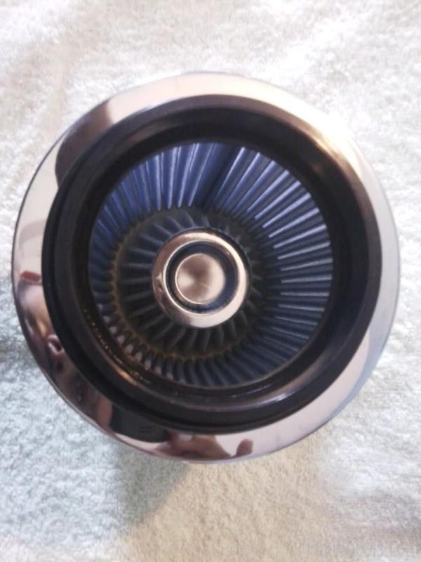

So a good friend of mine purchased a spectre air filter to use on his turbo'd ls swapped c10. Well within an hour of having his turbo set up completed, the metal chromed center cap in the filter came loose and destroyed his brand new turbo. He's contacted them and they refuse to help him and only offer the replace the filter that caused the problem.

What filter was it? I didn't know they had any metal on the turbo inlet side of the filter? Any pics?
+ 1. pics please

Being the betting man I am, I would say that the inside of said filters look like this.

There have been threads here before about them. It has to be the most stupid filter design ever.

I suspect the filters were not meant to go beyond NA air movement, and when you go over the CFM rating (if they even have them) it becomes a rest., and something's gotta give

Filters should never be designed where there are pieces that can fall off and go into an engine !! simple as that.
Haha kaboom. Dumb design for sure. Replace the wheel and move on.

The piece is even chrome plated so it will look good when it contacts the wheel ! wow......

For everyone wondering, yes the filter posted above is identical to the one my buddy had bought, his was just shorter. Worst part about the whole situation is that he originally bought the filter just to throw on the truck to get it running N/A and he threw it back on to get home from the exhaust shop after having his turbo plumbed and it let go on the way home.
To make things worse I've found evidence online proving that this time last year k&n and spectre was actually replacing people parts damaged in the same manner. Yet they refuse to do anything but replace the filter for buddy.
