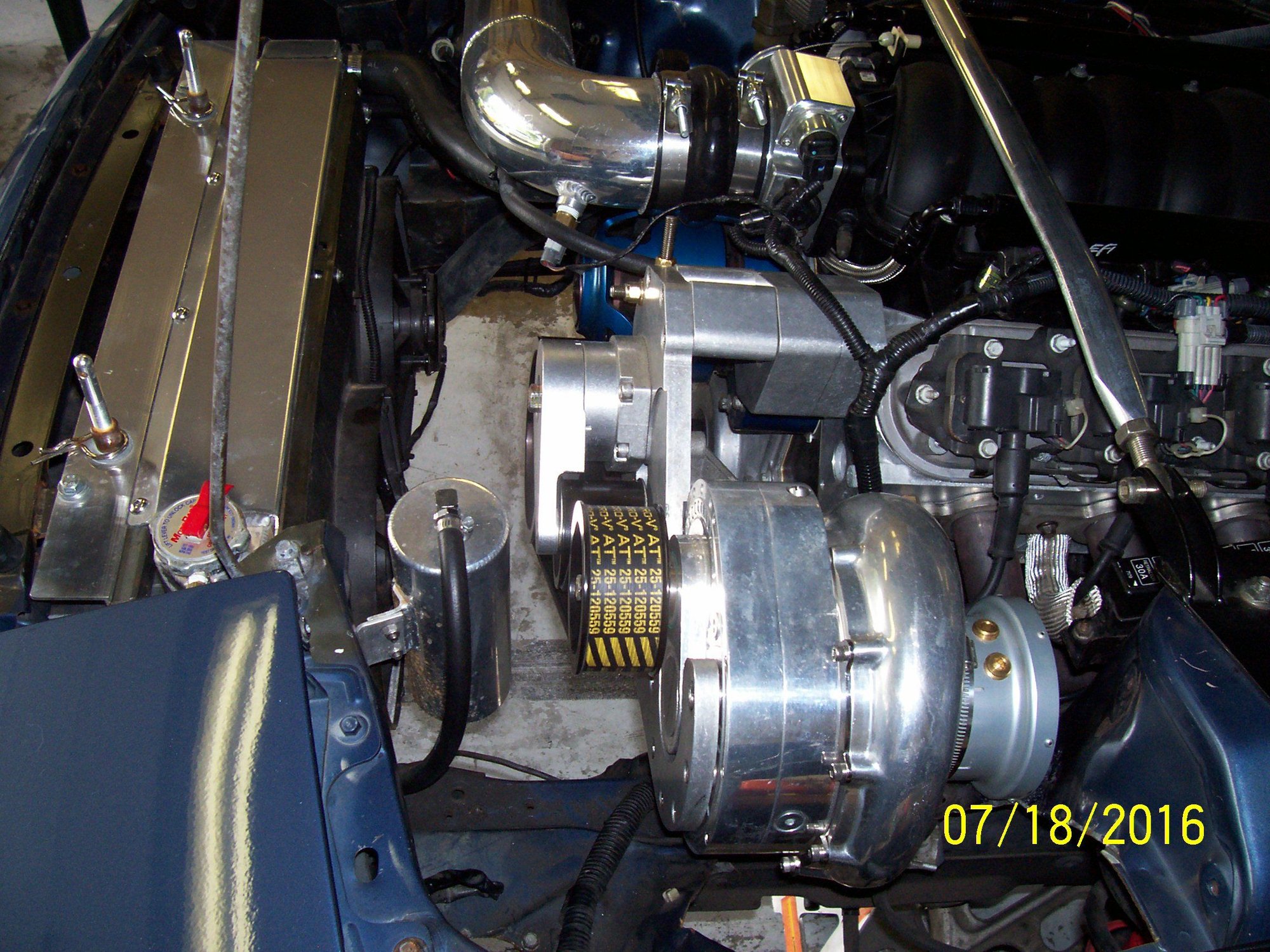

And the inlet tube has been removed, correct? Nothing on the front of the blower? No screen or anything else that could be a restriction?

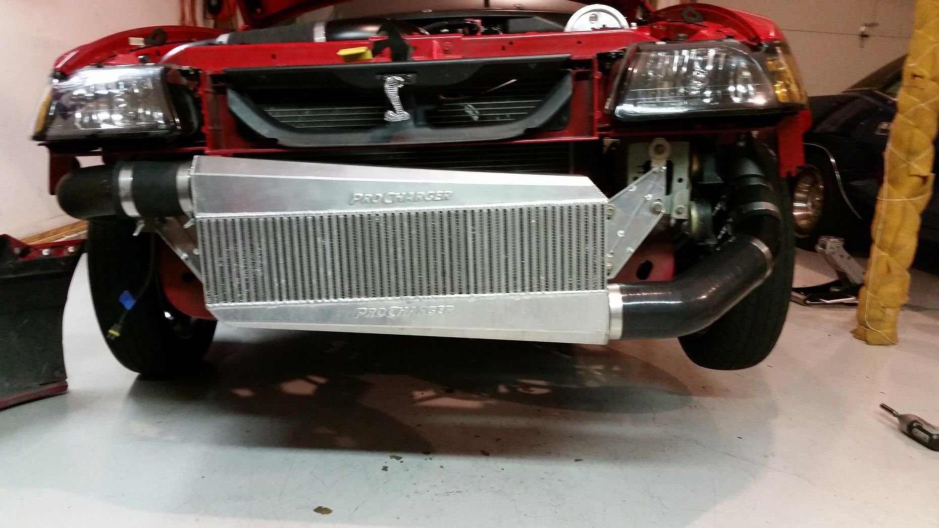

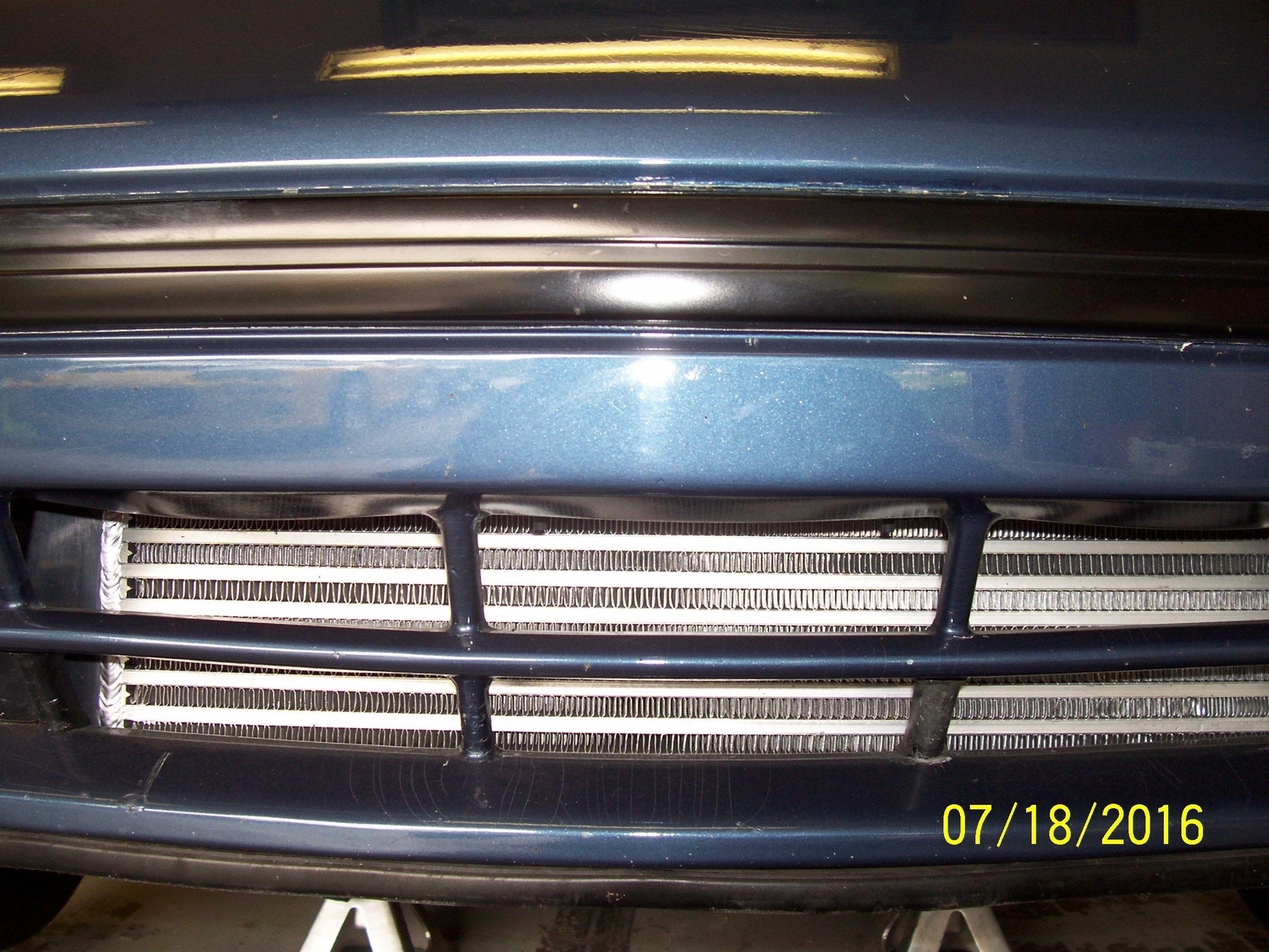

Do you have a picture of the front of the intercooler core?

This is a picture of the F1-R with the little bell shape screen on the inlet side that ProCharger sells when there is no room for filter.

The intercooler was from CX Racing.com. Part number IC0023

Ok, the bell is good. Just making sure you weren't trying to do a "cold air" inlet that some try to do and totally choke the blower out.
I would bet your problem lies in that intercooler. Those cheap china intercoolers are not made to flow any kind of CFM, regardless of their horsepower "rating". Without seeing the core, I can't tell if it's even a bar and plate. It could be a super-crappy tube and fin.
Also remember, if turbo guys say they have success with a cheapo intercooler, doesn't mean a blower car will. On a turbo car, if the intercooler is restrictive, the wastegate just stays closed longer and the turbo spins faster to overcome the restriction and create the desired boost in the manifold. If a blower car has a restriction, the user has to pulley it down to try to overcome that restriction. This creates more drive power loss and a lot of extra heat. A blower setup needs a very high-flow intercooler to make good power. Your best bet is to switch to a "vertical flow" or "top to bottom flow" intercooler. This style provides much more surface area for flow. A "horizontal" or "cross flow" intercooler is good for IATs, but has much less surface area for flow and therefore is much more restrictive.

Ok didn't see the pic before I hit submit. The core looks like ok construction, but it's just too small. Take a look at my intercooler, 0 psi drop. It's 4.5" thick and 27" wide. Bob can sell you this exact intercooler, but it isn't cheap.
If you look at the CFM rating on that intercooler (which is probably inflated to begin with), it flows 385 cfm with 1 psi restriction, and 635 cfm with 2 cfm. That restriction is not a linear curve, more exponential. So by the time you get to the 1700 CFM your blower flows, you are at an extremely high restriction.

Your not able to see all of the intercooler from my picture but it is 31X12X4 which is larger than the one your running.

Outside dimensions mean nothing. Think internal airflow area. Your internal airflow area is 12 x 4 = 48 sq inches.
Mine is 27 x 4.5 = 121.5 sq inches.
In addition, it looks like that core has 5/16 or 3/8" tall cooling rows, and only 1/4" tall pressure rows, further reducing the amount of internal air flow area.
