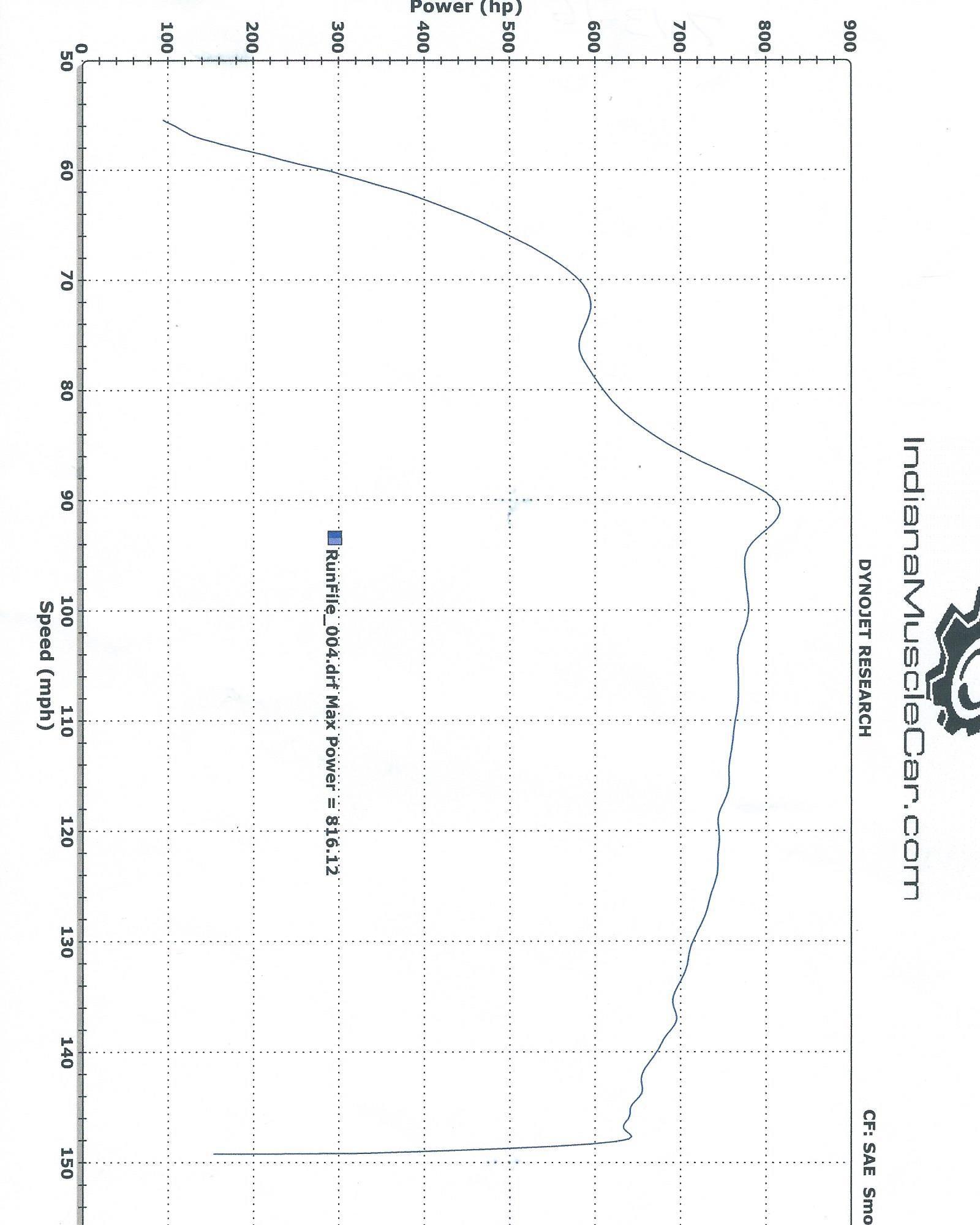

Old Jul 15, 2016 | 12:29 PM
BLNLS1/RX7's Avatar
Joined: Sep 2006
Posts: 1,225
From: Fishers,IN.
Got back on the dyno on Wed. and might have found the problem. Will take car to the track next week and see.

Old Jul 16, 2016 | 06:30 PM
BLNLS1/RX7's Avatar
Joined: Sep 2006
Posts: 1,225
From: Fishers,IN.
Originally Posted by Bob@BruteSpeed
What did you find Steve? Bob
Went up to Leesburg IN. and had Justin dyno and data log my car since Brent is still recovering from his last surgery in June.Made 5 pulls and it appears that maybe the belt is slipping and was losing a couple lbs. of boost.The car was also running very rich.Made some adjustments and now I need to get to the track with it.How is your Vega coming along Bob?

Originally Posted by BLNLS1/RX7
Have had different ProChargers over the years and I look for any residule black dust or any other signs ( visual ) of the belt slipping.
Glad you got it figured out. Do you have any dyno graphs, power numbers or screen shots of the boost curve?
After they found the belt issue, what did they do to fix it?
Old Jul 17, 2016 | 11:18 AM
BLNLS1/RX7's Avatar
Joined: Sep 2006
Posts: 1,225
From: Fishers,IN.
Old Jul 17, 2016 | 11:19 AM
BLNLS1/RX7's Avatar
Joined: Sep 2006
Posts: 1,225
From: Fishers,IN.
Here is dyno graph.
Old Jul 17, 2016 | 02:41 PM
BLNLS1/RX7's Avatar
Joined: Sep 2006
Posts: 1,225
From: Fishers,IN.
17 lb. of boost.
