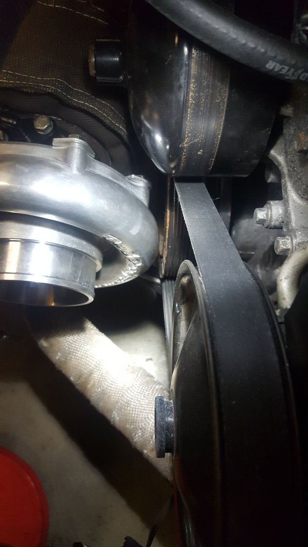

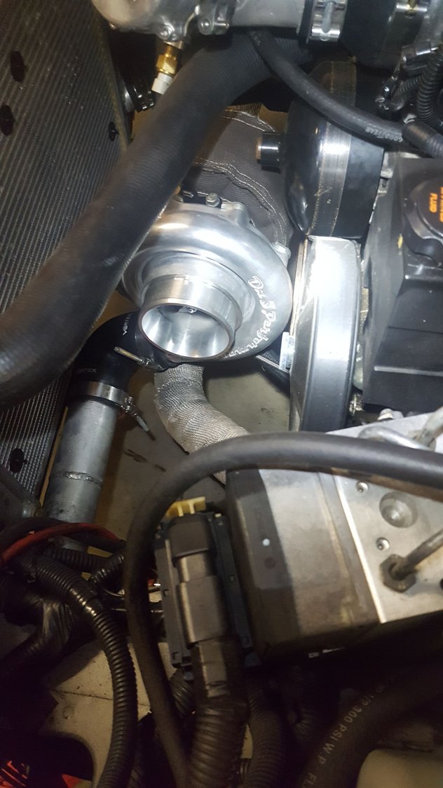

Got the car mostly together. I just need a temporary port for my WG hooked up. The cover is bigger on the on3 and is very close to my balancer. I had a couple things come up and couldn't get right on it. I will have it on the road soon. And I can do the "seat of the pants test" lol. I am fully expecting to gain up top, but that is not everything. Going from a turbo that spools quick to a laggy peaky is not the result I am hoping for.

Old Nov 17, 2016 | 01:56 PM

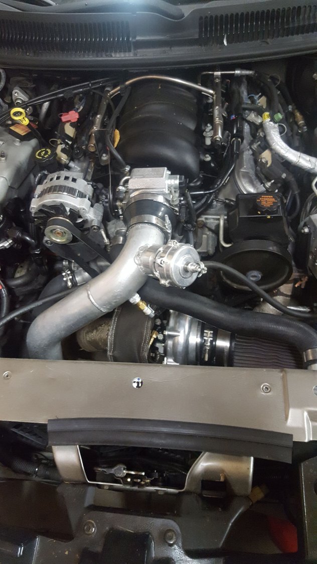

The 76 wasn't sweating at 7lbs and probably in a good place compressor map wise. At a like 7lbs I don't see the bigger turbo doing much more. That's my vote anyway... Been wrong before (alot).
IMO if he keeps it as 7lbs... I'd want the smaller/faster spooling turbo.
Pretty sure I fart harder that 7lbs these days though.
In for results.
OP - if you move the inlet of the turbo to a cold air source it will drop charge temps a ton. That's a really poor place to have your inlet. For every degree you drop off you drop off inlet temp it drops like 3-5* of charge temps.

I had a diffrent inlet setup for it but, my new trans cooler with fan install took up too much room. So re-working it is on the to-do list. I also did not know that about the inlet temps. I obviously knew colder is better, but I did not know it translated like that.
I had my old turbo way over 7 psi too, just not on the dyno that day because of time restrictions. I'm still kind of new to force induction. So I'm all for any pointers.
