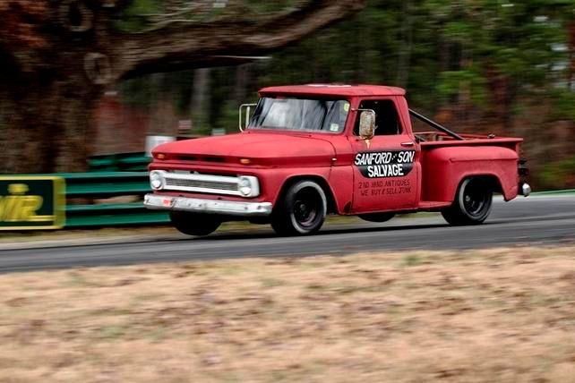

there are a few guys road racing and auto crossing c10 trucks, haha
the guy at no limit has a '69 that's pretty amazing at dodging cones. not really my bag of biscuits, but it's impressive.
this isn't it, but I really like this picture
